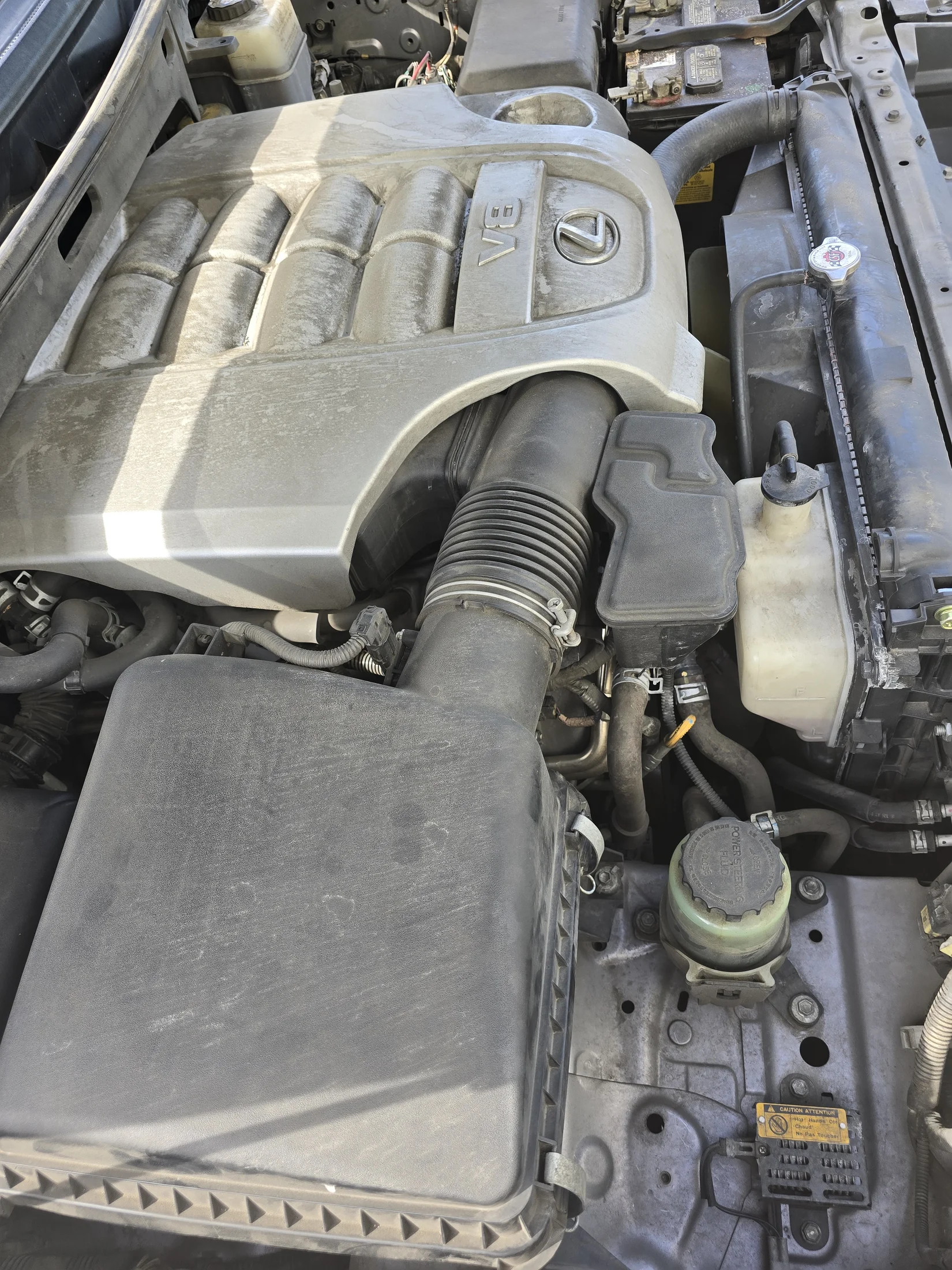

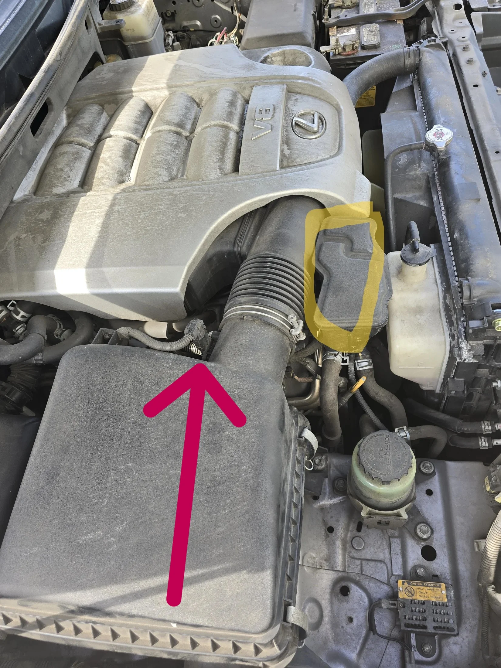

I did a quick google search for P0101, and most sites suggest cleaning the MAF Sensor. Anyone show where and how can one accesses the MAF sensor? Any recommendations on what to do next?
Thanks. Can you suggest on how to remove the MAF sensor? Seems like a quick job, but I can't find a thread.
Remove the sensor plug, remove the screws holding the MAF sensor in place, and gently pull it out. You'll do just fine with a screwdriver and a little curiosity.
I was able to remove the sensor plug. The screws, not so much. I see there are only 2 screws. They won't budge, ugh. I sprayed some WD40 on the screws and will try again tomorrow. Getting tired due to long day. I also don't want to risk stripping the screw's "+" hole. Any suggestions on how to remove the screw?
