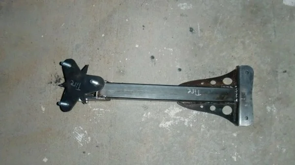

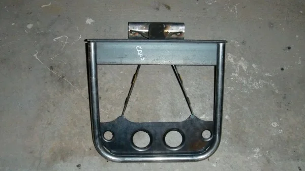

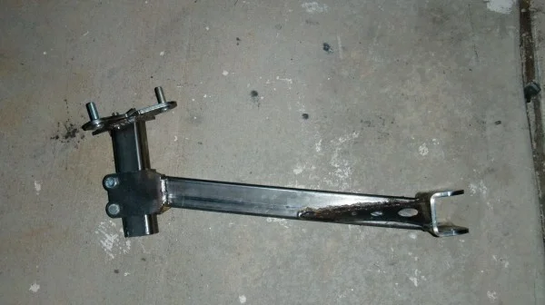

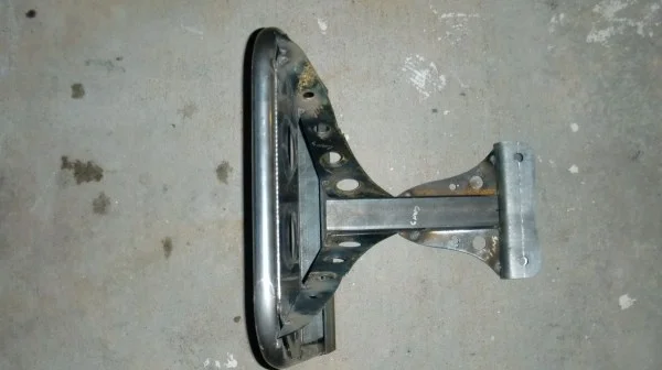

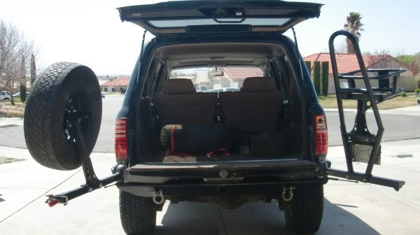

Was able to get some minor progress done without the lower spindle bearings. Not much measuring actually needed fro these parts. If you can find the center of the "C" brace and the upright square tubing these things pretty much build themselves. Got the spare tire carrier and most of the fuel can carrier tacked together.
And the can carrier
Anyone have any tips/hints on the ladder?

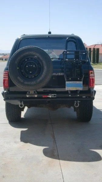

Here is where I am now. Mostly done except for fully welding the spindles in, figuring out the high-lift jack mount, and paint.
That hub cap is vintage FJ25. I picked it up for $1 at the swapmeet at the drag race. I plan on cleaning it up more. I am waiting on spring clips for the wheel as well to tie that detail up. I also need to come up with a mount for the reproduction oval Toyota emblem you see over the tag mount. I wanted to bring in a bit of Land Cruiser heritage with these details.

Now with color

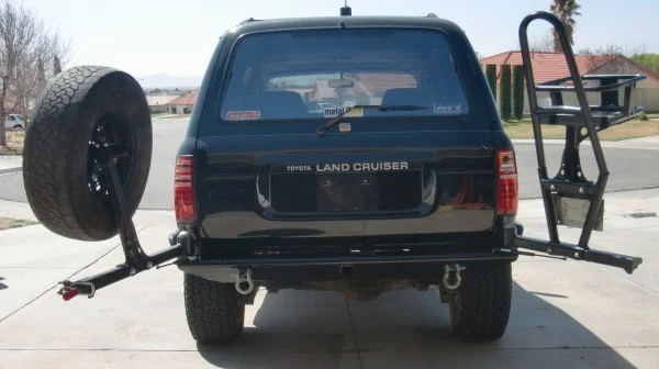

Did you cut the side plates where the tubing curves down or is that an option deal?
The tube was longer, so I did it like LandCruiserPhil's. I wasn't sure if it was going to work with the dual-swingouts, but it does.

Wait.. on your jerry can holder either I'm missing ANOTHER part or yours is a different design. I do not have that vertical arm and was going to do it so that it is lower on the ladder. I kind of like the idea of it being lower, the top of the basket would be roughly even with the bottom of the rear window.
I wish fuel can carrier was a bit lower in hindsite. Being only 5'1" tall, putting a full 5 gallon jerry can up there may prove to be "fun".
I gave thought to cutting the box tubing down and notching it to fit the horizontal brace, so it would be just above the step/mount. I decided against it obviously. I didn't want to re-engineer something and not have it strong enough. Figuring the weight of the fixture, the 10 gallons of fuel it's the last thing I want failing on the highway. But with some time and thought I bet it could be done with the parts supplied safely.
