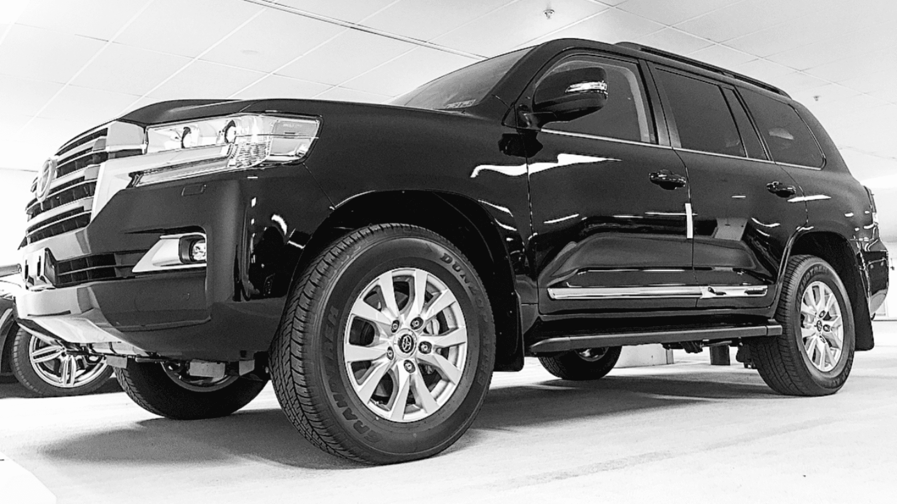

Hello guys,
I just wanted to get some opinions from some owners that have towed with their Land Cruiser and to see if I'm setting myself up for failure with what I would like to do.
I have a 2017 Land Cruiser which has a 8100 lbs towing capacity.
I would like to tow my ATC aluminum trailer which weighs 3200 lbs and a GTR that weighs approximately 3800 lbs. The trailer is 24 foot enclosed. I have attached some images.
mathematically I should be ok , But I wanted to see if some of you would say that I'm pushing it and that I may feel unstable during transport.
I'm planning to purchase a Blue OX weight distribution hitch because it is necessary and evaluate this set up.
Thanks guys

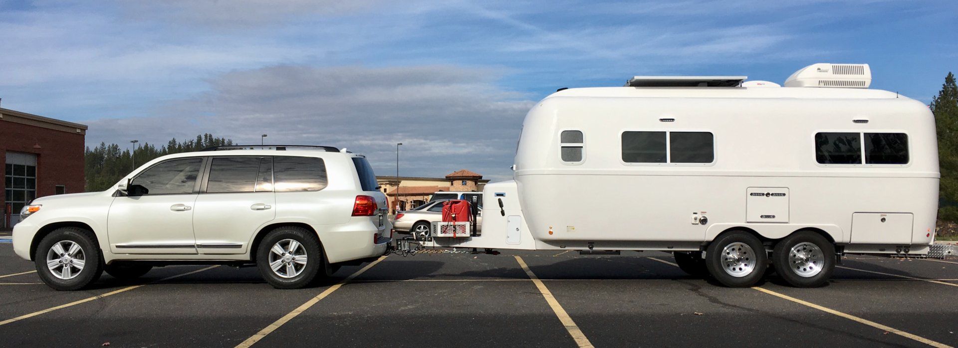

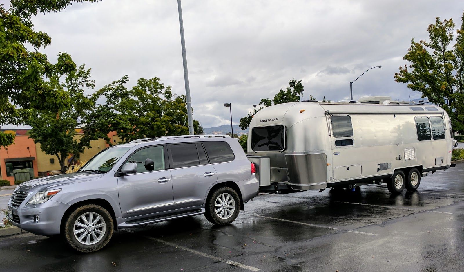

Wow, surprised at the lack of confidence in our 200-series.
From personal experience towing thousands of miles with my 28' Airstream rated at 7700 GVWR, and ~1k tongue weight, no problemo!
Absolutely steadfast stability with zero wiggles from even passing rigs. With almost 400hp/400tq on tap, power has never been close to an issue, even on extended 7% grades. Neither is engine braking.
Key in this is the hitch and setup. Sure, our wheelbase is on the shorter end, but I've not found that to be a limiting factor. Gotta make sure to keep enough tongue weight, and apply enough weight distribution to transfer weight to the front axle. Also, anything you can do to the stinger to keep the ball as close to the rear bumper will help. LT load range E tires would be a good mod.
Only knock if there is one is the small gas tank. Aux tank mod in my future.
My tow report - LX570 Tow Report

I agree. My ‘08 LC needed air bags to pull my 27’er up the Alaska Hwy and back and my ‘14 LX went to the Arctic Circle with the AHC. Your trailer looks like the Center of gravity will be quite a bit lower than the travel trailers and the axles are farther apart which will smooth out the up and down and puts the weight over the axles and not 15’ behind. I am lighter than you by about 1000 lb.s and I seldom exceed 60 mph on the roads up here. I went with the Michelin AT2’s for tires and am very happy with the 20” wheels on the LX. Over 10,000 actual miles towed.
IMO, you will have no problem hauling your trailer.

I tow a 6000 lb 24 ft Oliver trailer and it is no problem. I towed the trailer before with a Ram 5.9 Cummins and it was absolutely effortless. The ONLY reason I bought a 200 is that the HD truck was beating us up so badly on bad roads and it was a horrible vehicle for exploring National Forests and rough passes.
I know my 200 will be a gutless pig at high altitude in comparison and I am willing to deal with that in exchange for its high comfort level and back country capabilities.
In your situation I would definitely be towing with a diesel HD truck. No question about it. The aero drag is the killer factor with your trailer, I hate to contemplate dragging that uphill at 6000 ft into a 30 mph headwind, or worse. My Ollie is heavy for its size but is low, highly aerodynamic, and only 7 ft wide. It makes a huge difference compared to your huge box.
