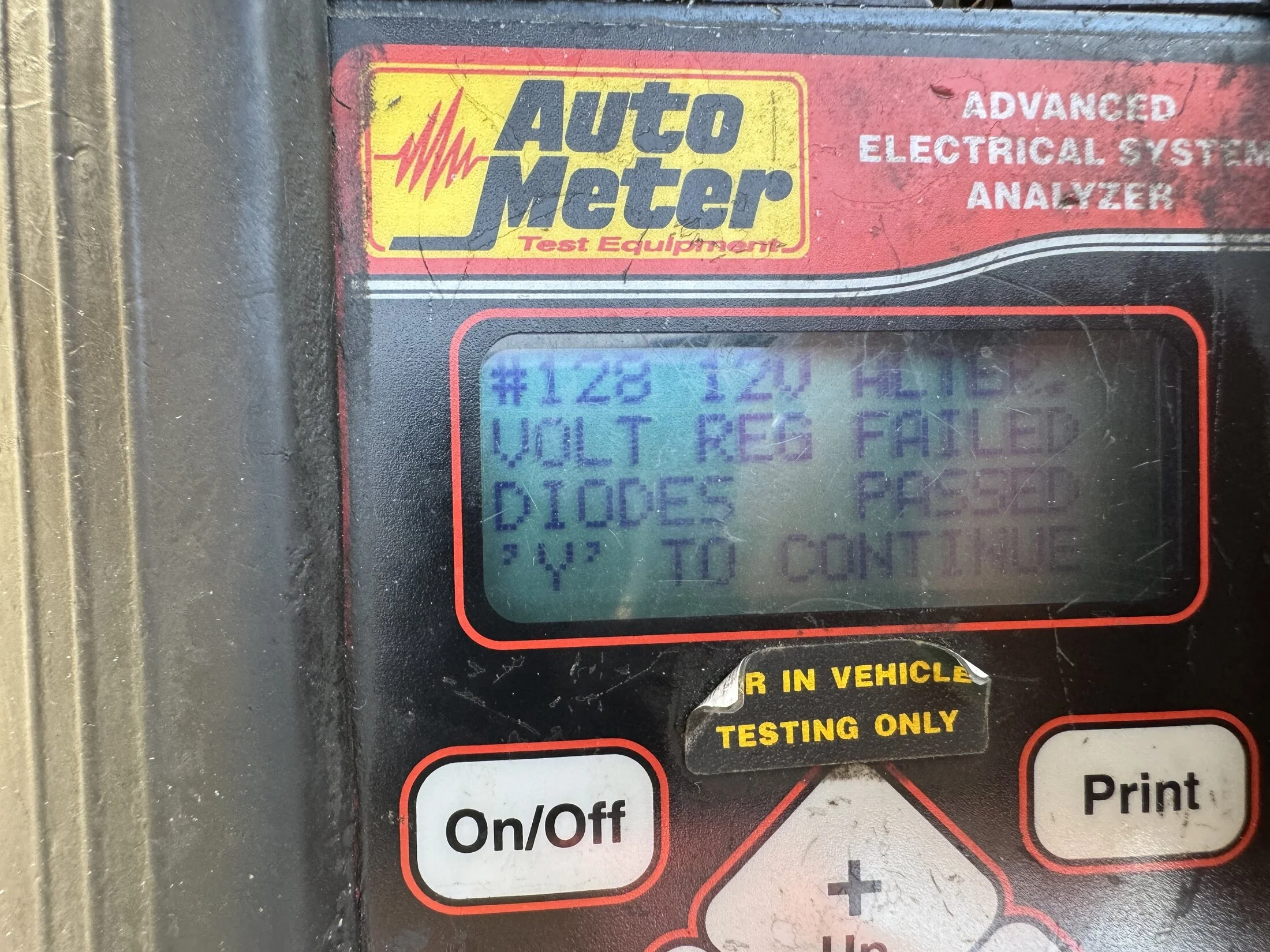

Just wanting to vent and see what others are getting. We were on vacation on our way back to Texas from Colorado and ended up having to stop in Pueblo Toyota to get my alternator replaced 2/27/23. Super expensive but they got me going and on our way home. I have had my vehicle die twice now and thought this is strange, I had bought a new battery in January of 2023. So I boosted the battery and drove over to Orileys for them to test the battery. According to them the voltage regulator is bad. Pueblo Toyota was closed so I called a Toyota dealership in CA and they said that they have a 1 year 12k mile warranty. How many bananas is replacing an alternator? The guy at Oriley's said damn that thing is buried in there.

So I went to Autozone and had them test it. They tested it with two different units and it passed. I went back to Oriley’s and had them test it again and it failed. Went to a mechanic’s shop and he put a different type of tester on it, made by Mac and he asked me to watch the readout as he started the vehicle multiple times. The first time he started it it went down to 10.5, second time was 9.8 and the 6-7 remaining times it stayed above 11.5 and into 12.6. He said he believes the battery has a bad cell. Not really sure how to go about getting it warranties when the test the battery on the vehicle and it test good. Maybe I just need to take the battery out and take it in for testing. 🤷🏼‍♂️
