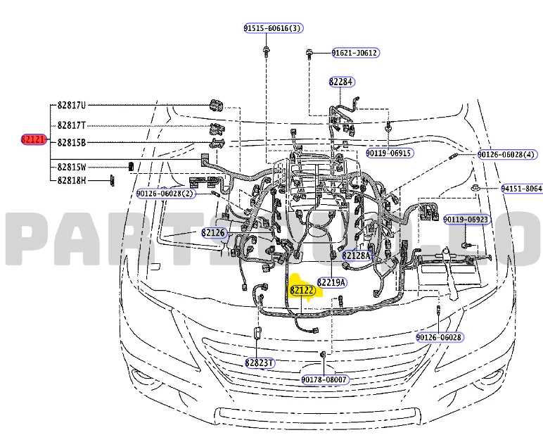

I'll upload some photos later, but they are replacing the alternator (OEM this time), the fusible link since it popped, and they are recommending replacing the Engine Wire No. 2 harness (Part # 82122-60570). It is scored and the cover is burnt near the alternator. There was no other noticeable damage beyond this.
Now we can't find the part. It shows available, but you can't order it. Dealers say there are none in the country and one says it is made to order with 4-6 week lead time.
Question: is this something I could have custom made? Have folks who've upgraded their Alternators in the past done this? Any ideas for other sources? Partsouq shows not available.
Another question: I trust this shop, but does their assessment seem sound?
Lastly: Has anyone else replaced this themselves? How hard was it?
YELLOW highlighted part
