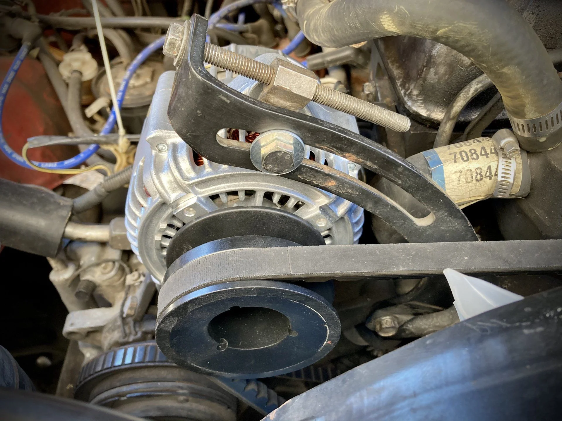

I tried this upgrade a while back, but the belt that was on my rig was too long. It was the belt that came on the truck when I bought it a few years ago (Gates replacement) and was definitely used, but in decent shape.I ended up ziptying the 80A alt in place to move the truck halfway across WA from Silverdale to Chelan.

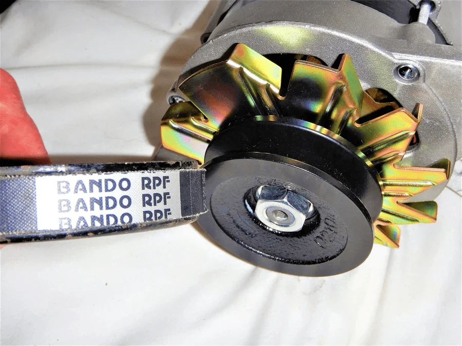

This worked better than the failing OEM alternator that was there, but I knew I needed to get a real belt solution (wiring will be redone with 2FE).I found vbeltguys was selling "Bando" belts (found out they just cross reference to Bando but actually sell D&D Power Drive belts) for $5. I ordered a "Bando 5610", 5L620 & 5L630 for $20 shipped.
Of the 3, the NEW factory length belt & 5L630 will fit (the 5L620 would if I could rock the alternator close enough to the block). I am going to run the 5L630 for 2 reasons, the 5L630 has a little more room on the adjuster when tensioned about the same & being an industrial belt, it's supposed to stretch less over it's life.
lAsQfarUFvkwUK9FLK24T4eEAulmte-YtcElRsct-TcAzyAoj6_aNooWIR0l-ruCRybGYIJgaeErbPIMVt7sKw-aVChOzSbclG6YgexZORVPRjnQlLa2tMZgPwFLh_EDqk7-1DODM54OLKlKZAJuajJBLneMwyJfTo0VBke_jX3tPwgATMVk2UQbv0GOCcy8xPWEDJyr9YitlsKLI5oJM5Kjx0EQZfPdQelzZK-RHF_b6ftLPHUChRUjCPeLAaAO9_R-QnrfqZ9iogRNDy8GDhaoDEBCEE58cj7ABBa2ahl251oJy6QUAvRKp_SrfUhUV44EVCYmGsI4cQiEGL31i3C6qh-8_XHabJAtcj6al8ribO_UZgfqYCvmKAzQpCun81FjRkGlCnovR5Gd-EqL4C_WP7oB9_c9uJPpzXls2uuFMrWmLUV4jgO64RUKH-YCCvrJFBd8igFj2sVrTnmVS_WbK0rdg6PN4_oiB84DpskhG9aMAM5pdelS-FXrblrTEHE64jBu7qb7ql4-1sXe3MrxGrvb-ou8kuHTt83Mn0rkpxfxl7t3lExXhuHrt560pgKkTQpYyxcSZwWgAb7P5byae696oYQZLgzyOjF6IwDVCAawU5VmRnnqWDxlAYT4IFwNuQ_OiBiMorwJsddrclQLQu7AgjzDFZr9BBeJSjyXqFTHlD1HoOqBOiGP=w612-h814-no
o-NJU5thGT0syvwwq7w6xDe7MTQ6cB83jnG7DDPAvpO1ZrSG1QBRFz1Dj1C1o9NYPzjvrm_fcrxWXV-nS8gUg5H4J_IlKD2gnD76m8bLY0LlN9Ppt7Yp26K1dJa-zJv-F_8vWPUV88IwekGJV_mntUCve0cpTs0fn9c3NMXd0pb38pd26PR6EQdCXTJnx6Y-re955LAby9cq36brF8rB8mNS6m0y-YR_bIDjyD_5soQfJzaBkTV2Rb80hY_a2RHsXwgnuVc7-FzBNAVt1UmFJJoiIaNy_mFJ4yrDn-Fy8d5s2lyLmF-RBs_epkyKXCt4j7vXg4taciz_WAVMfYDS0q7o39O8MKXFpQtWu-kFqIkz4gKiNcJRQxfNLEHfjmKFRTSwTRZJDqsgagQSPT9JCCyEizMbacbElTaxx2rRXpgRbZ0UbuCywkaqBhNIM5b7Qef_2Ucmm-LwACrWpTJodTZUADL7xBMQxMccROVlsgueToEUnHBdVrMSLlpOt2iiUqABYZqUqUi-o6sH0voNp92PliXbdX7t7-bbJ0T5xOTkvuWDaSMQZ_TlukDGyj1BTVzqZrFKHmHodg0OWUliBBUBCK6r_oUgYhowDPr5Wk7KXDokeoxODa7KjCO0RRrdlkL1Nb_5xQi7LaATaW1sYIK8Ri3mP_GVw-X3vIGszz4rD9GzSoJnvGqfvlf0=w612-h814-no

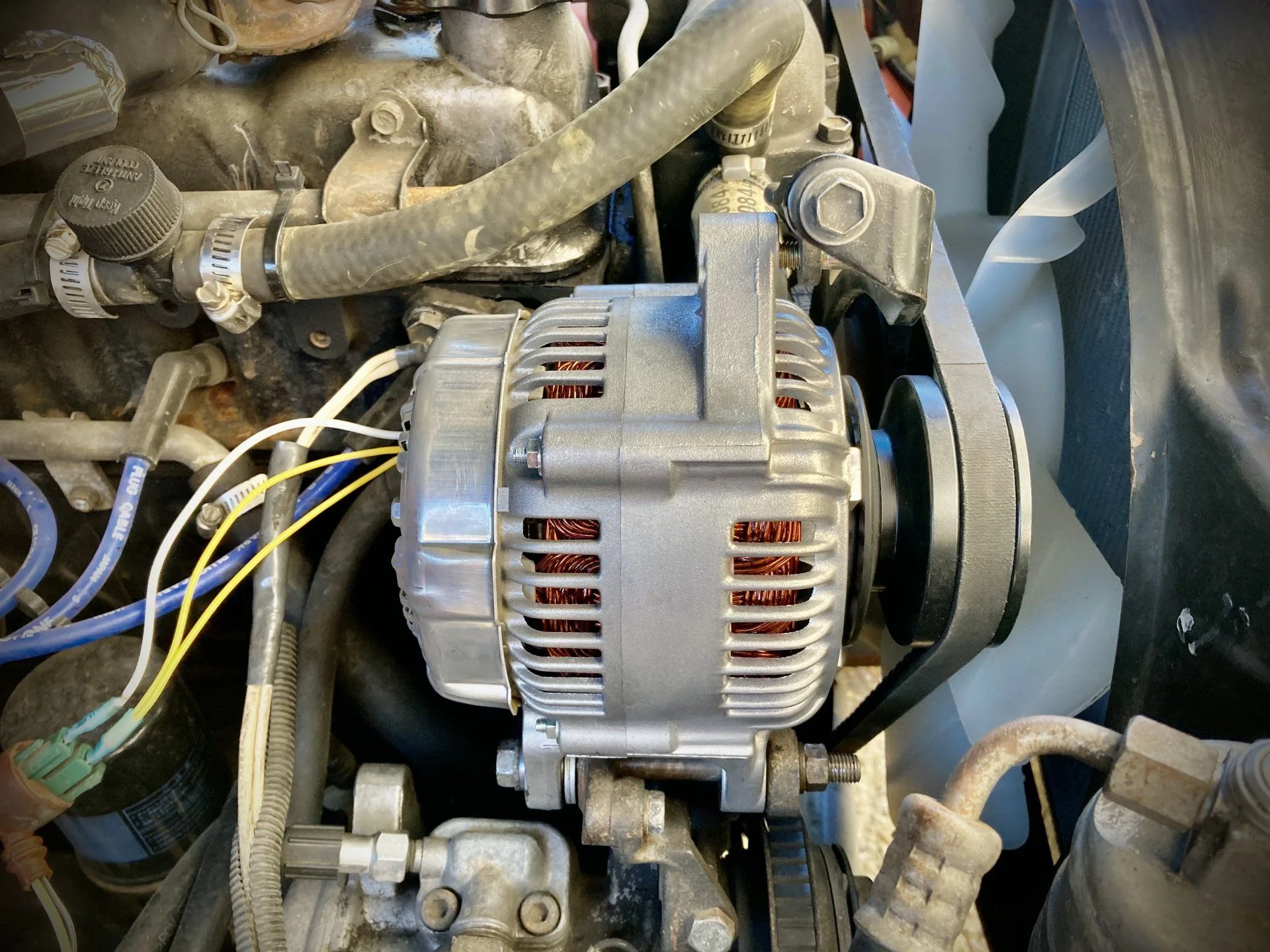

At this point my set-up (mechanically) is: 3FE 80A alternator, FJ60 fan & pulley, 5L630 belt, & I changed out the tensioning bolt to a shorter one (has full thread when belt is tensioned).
Hope that helps somebody.

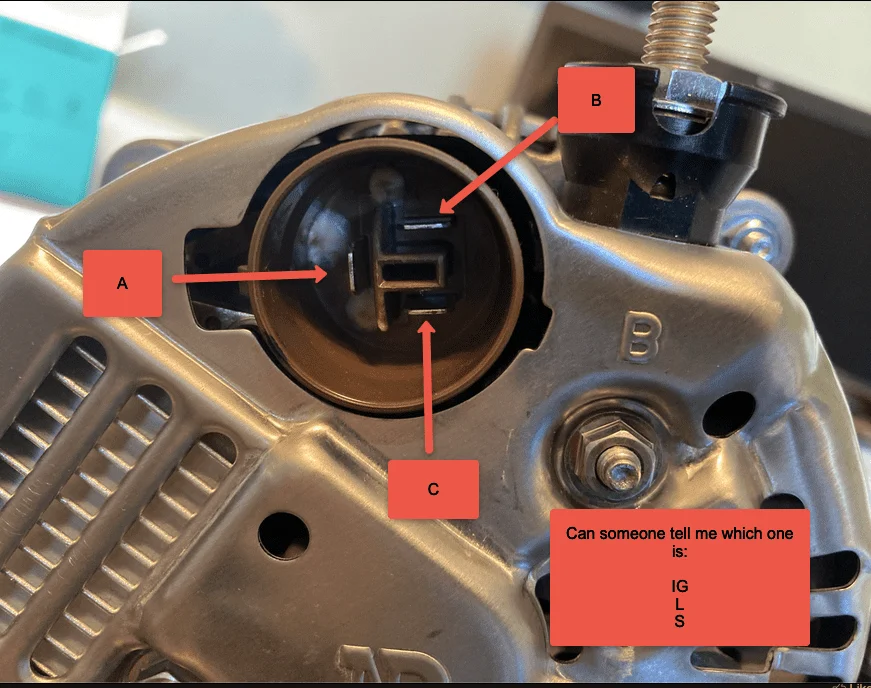

Does anyone know where I can find out which terminal is IG, L and S? Does someone have a picture?
Can someone identify each terminal on this alternator?

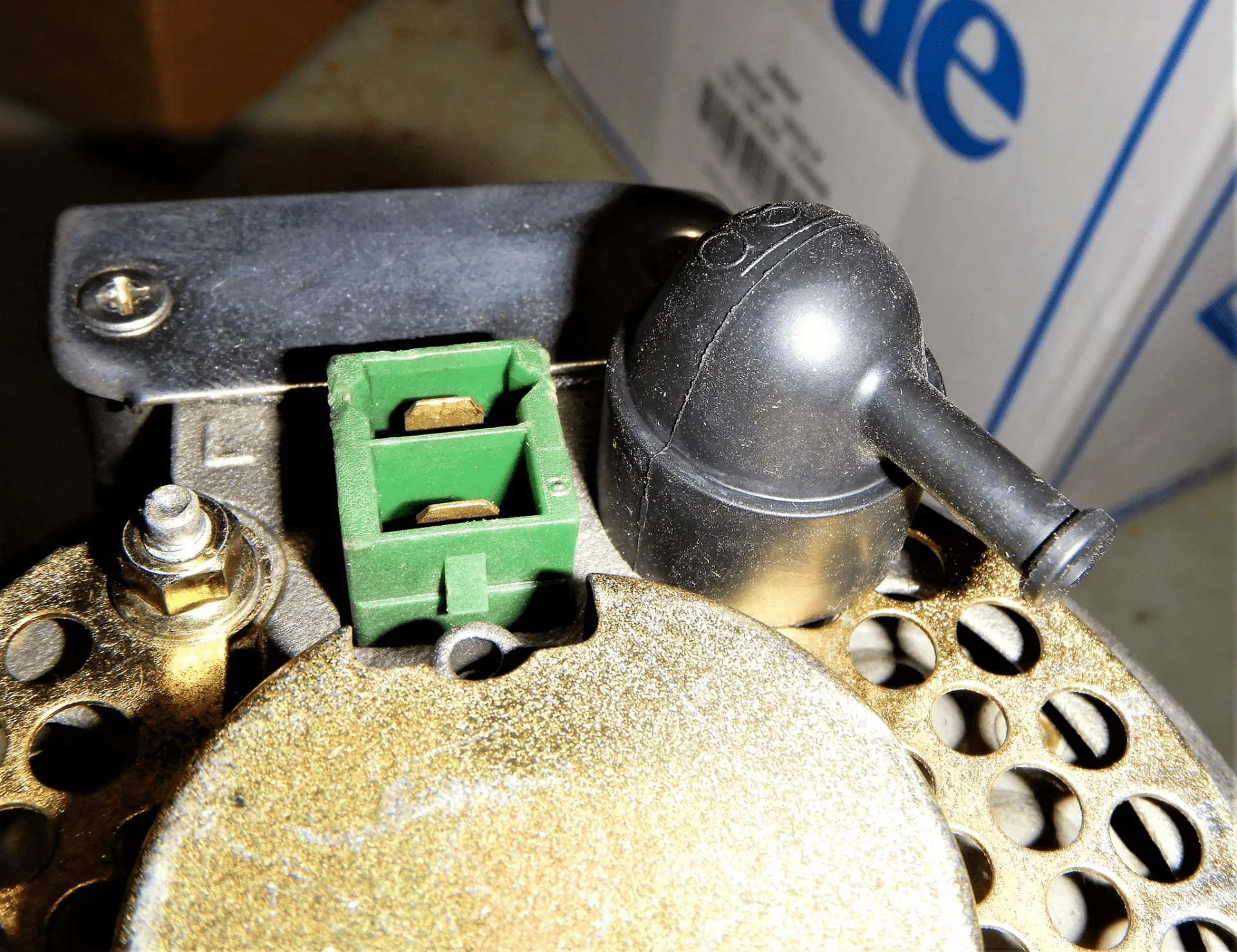

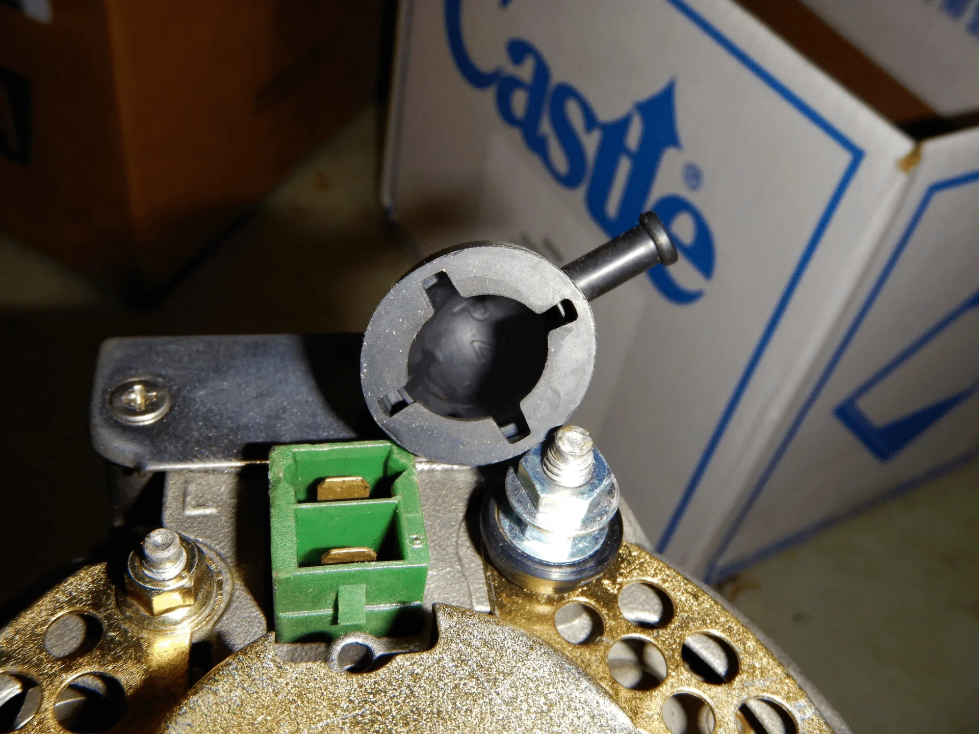

If you look back at posts 42 & 45, there are pictures of the back of the alternator with which terminal is what. The B+ terminal is the stud with the black plastic shroud on the side of the alternator.
Thanks. For some reason the housing on my alternator does not have the labels.
I saw that. Weird. Hope those pictures work for you though

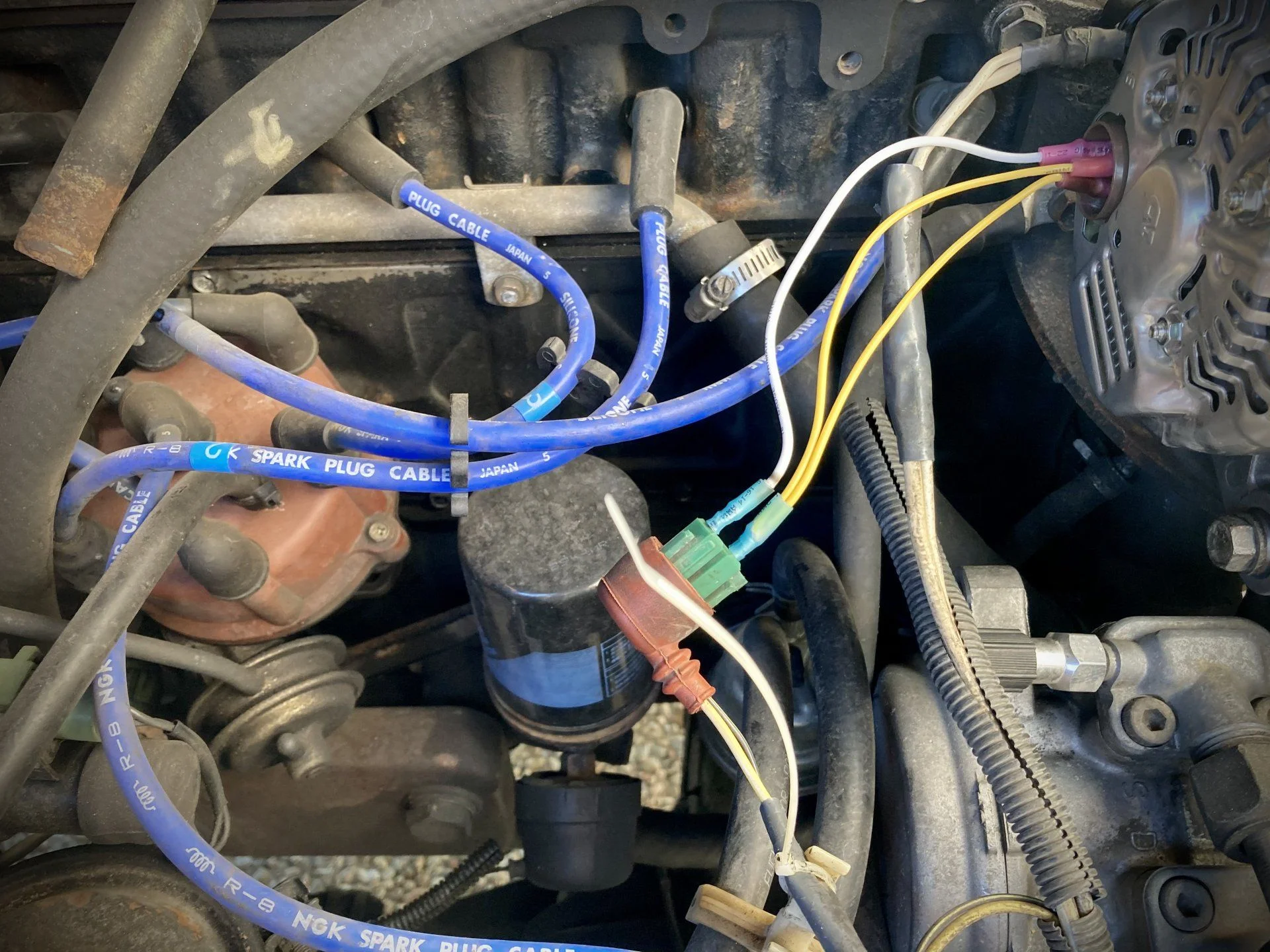

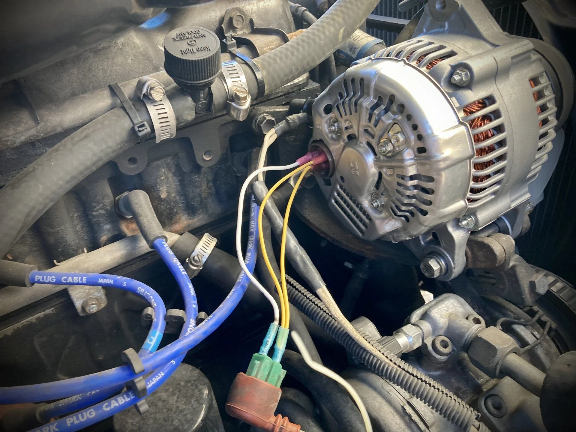

Just to followup. It is installed and working. Did not have to modify the mounting brackets or replace the pulley. Waiting on the correct plug from Coolerman to finish it off
Can you tell me what belt you're running? You seem to have a fair bit more adjustment than I do.
