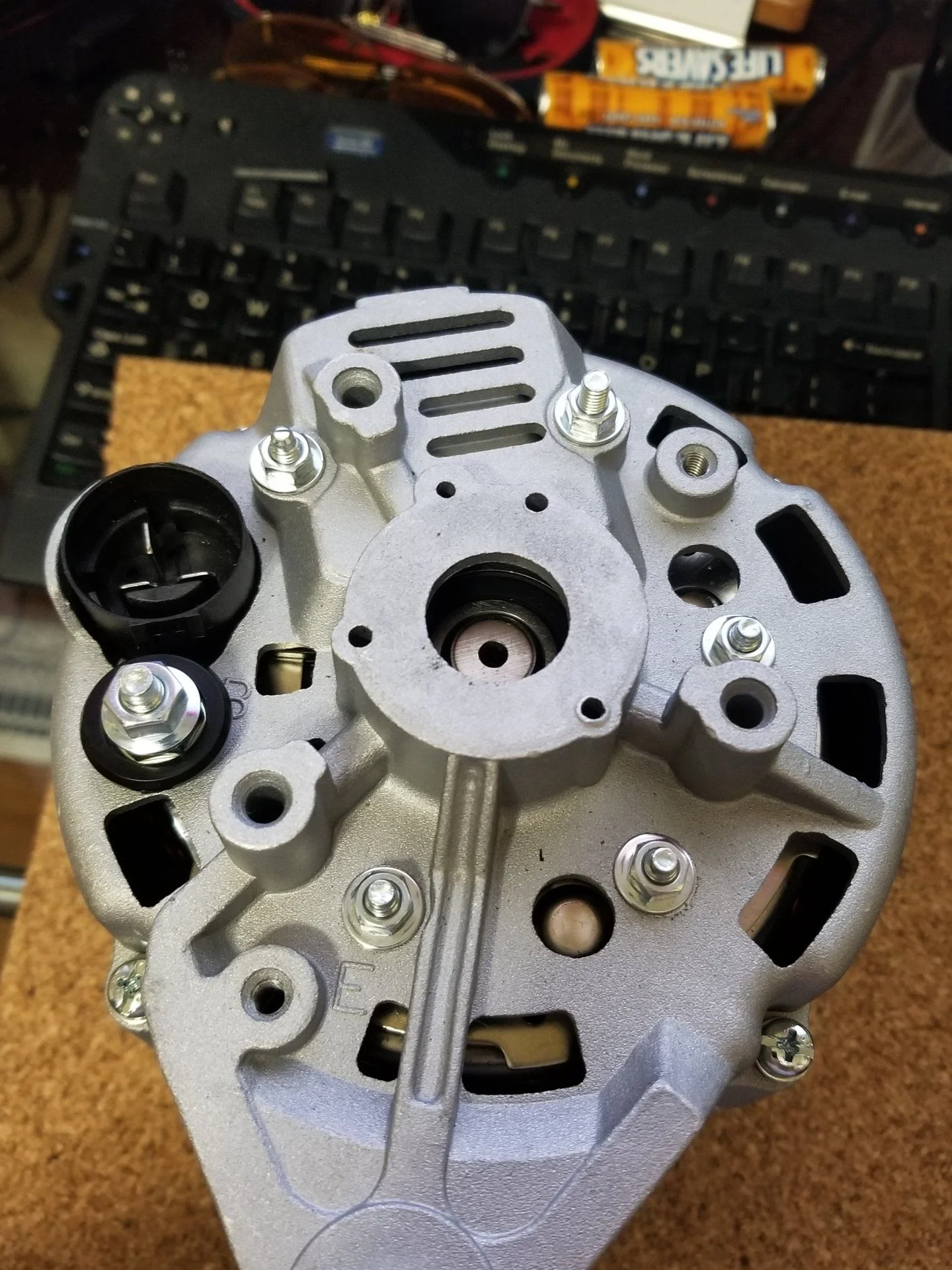

Casey - did your new remain alt come with the capacitor - little silver cannister with black wire on picture below?
Everyone - wondering what to use since the docs with the alt do specify if your old alt had one, to salvage it and install it. Should the existing ND one be taken? Also which nut to attach to? Guessing "E" as its the only thing on the case that is actually marked.

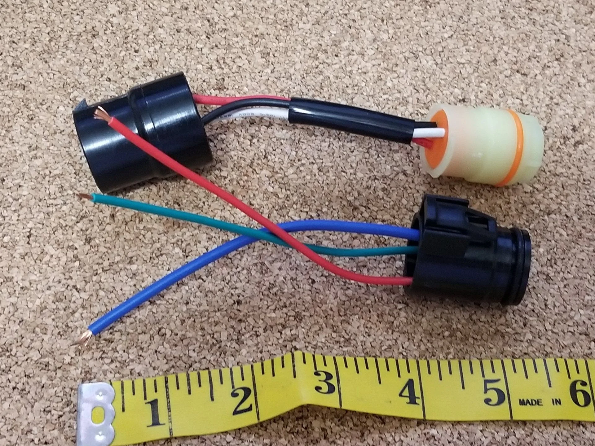

Casey - what was the wiring color to color you used? New ebay plug has red/green/blue. Figure your setup is working great, want to replicate it. Looks like from the photo that red goes to a yellow/white single on the original harness, but its the blue/green that goes into shrink wrap and isn't visible for which one goes where, if indeed there is any difference.
General FYI - this one came with a extender connector already in place and its color scheme is red/white/black so it may be possible to simply snip that and use those wires, they would be about the same length as the ebay part - but can't guarantee that any random ordered part would have that, Casey didn't mention it, and his photos don't show it.

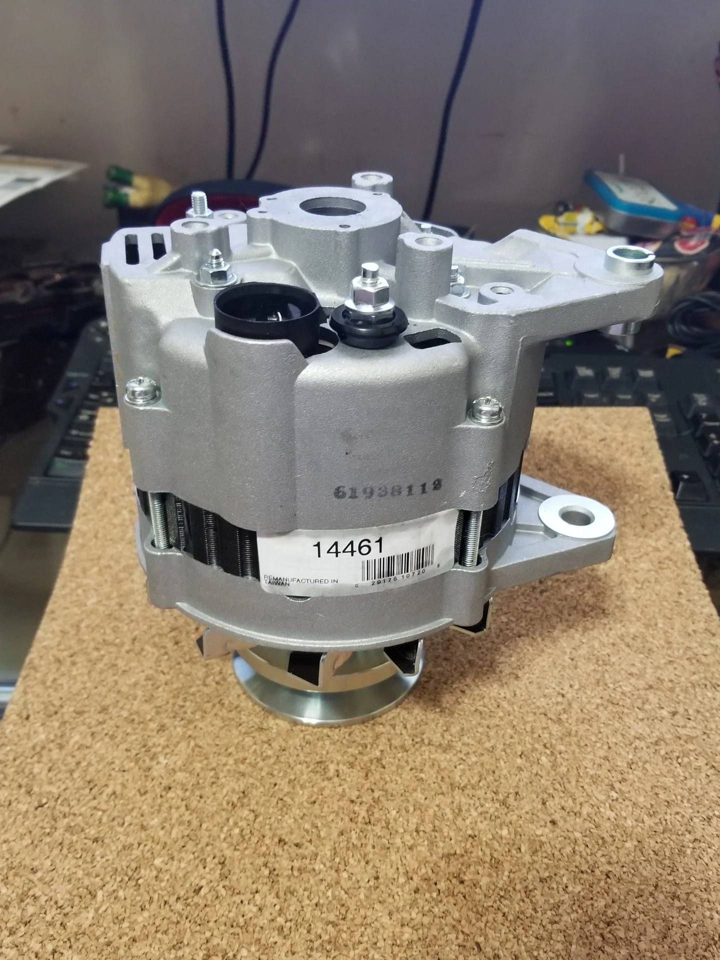

Pics of new/reman alt and the capacitor notice

Spike - no, that came with the Alt. Just an extender - the black part that looks like a fusible is just some sort of wire management. Does have an o-ring so as to keep liquid out of the connector. Believe the coolerman wires only work for AC/Delco conversions, and this is supposed to be a reman ND.@tucson_sailors
