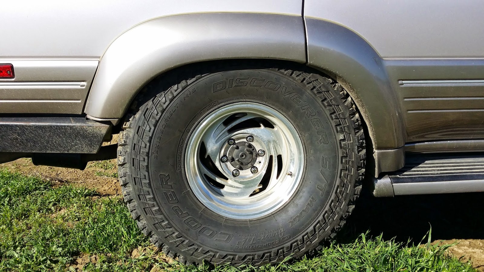

As of 1.25.15 I finally had time to do some R&D on the spacing problem. I removed the front spacers completely as for the rear I had two 1/4" spacers in hand & tried to put those on but with the studs being 1" long there was not enough threads left to tighten the lug nuts.
Bummer.
At this point I could see the aluminum wheel was hitting the caliper just by a wee bit, something that could be very easily ground off no problem.
For the backspacing to be where it needs to be is 1/2". To do this spacing I will need longer studs. I did set the back of the wheel up against the 1" studs & everything cleared just fine. The problem with this is it will only be a 1/2" ruduction in backspacing. I hope this will fix the rubbing fender issues. It will be $50 for two 1" wheel spacers.

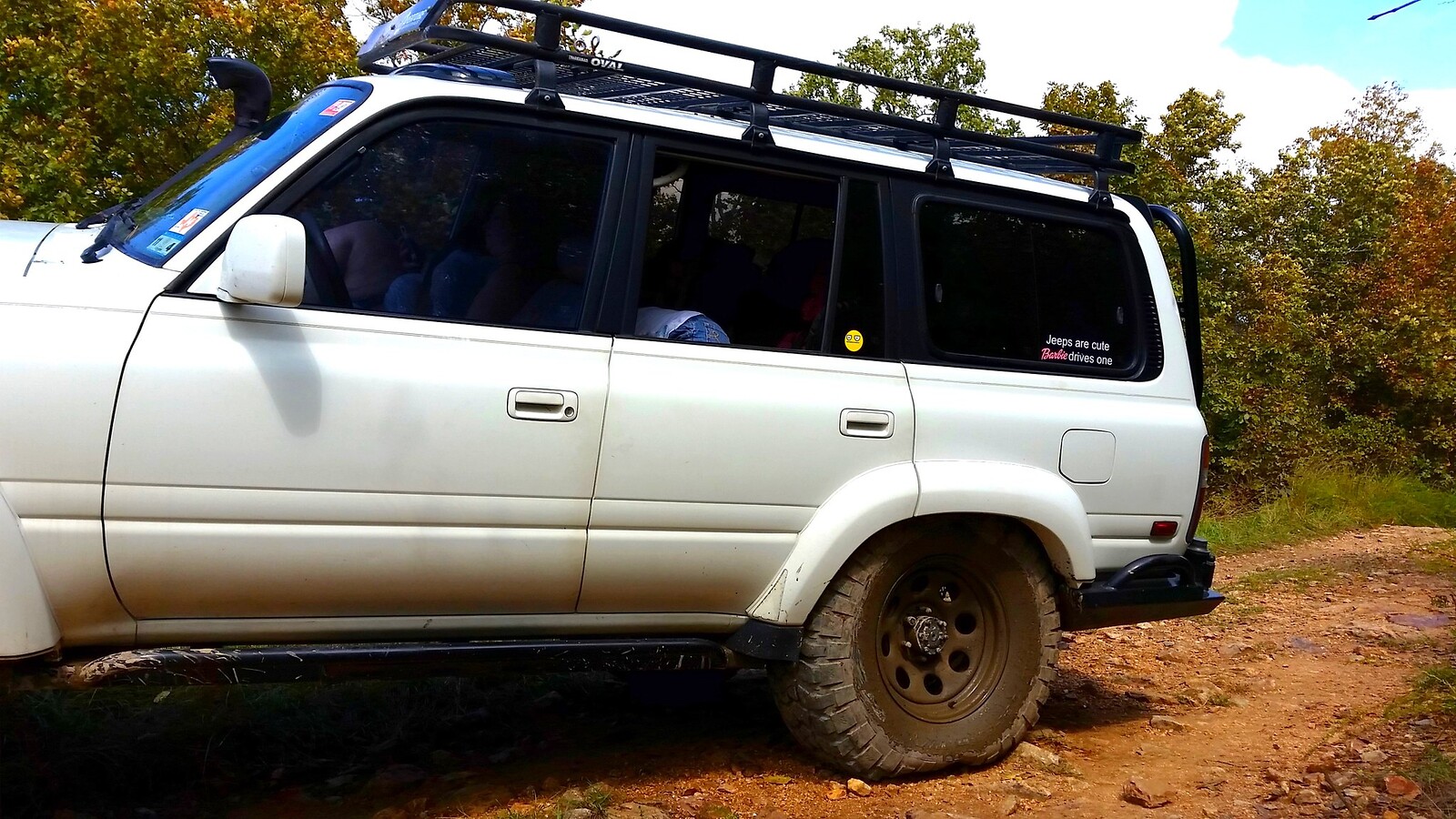

My only other hope is that a steal wheel could have a larger bell opening & therefore be able to slide past the calipers with a 1/2" backspaceing and be thinner in the lug nut area. There is a guy that has done this before here is a link to the thead of the same thing that I am talking about. Here is a pic from that thread. This guy has a 1" spacer & a 3.5" BS just like mine but with a steal wheels. He did write that it could work with 1/2" spacing but he wanted to fill the fender out more.
All though he did mention that with that set up he had no rubbing problems & they tucked in the fenders. Here is a pic of his set up.
Here's mine. It looks like my tire has more meat on the edge then his.
I think it's worth 50 bucks to try...
Stay tuned
Maybe you should stop dicking around with wheel spacers and just buy the right size wheels? Buy some cheap steel 17x8 Cragar Soft 8 wheels with stock backspacing for ~$91/wheel from Summit and you won't have to worry about wheel studs or cutting anything. Then sell your tires and get new ones that fit those wheels and move on.
These are 37s. Same wheels as above and no cutting with just a little bit of rubbing on the bumper.

As of 1.25.15 I finally had time to do some R&D on the spacing problem. I had two 1/4" spacers in hand & tried to put those on but with the studs being 1" long there was not enough threads left to tighten the lug nuts.
Bummer.
At this point I could see the aluminum wheel is hitting the caliper just by a wee bit, something that could be very easily ground off no problem.
For the backspacing to be where it needs to be is 1/2". To do this spacing I will need longer studs. I did set the back of the wheel up against the 1" studs & everything cleared just fine. The problem with this is that it will only be a 1/2" ru
As of 2.3.15 I found time to get the 1" spacers on.
Took a quick trip to the creek bed & found my favorite test spot, wow 1/2" less spacing made a big difference. It did still rubbed just a wee bit. Very close & very doable. Just to add a note due to the panhard bard pulling the axle to the right all of the fitment issues are on the side of the right rear.
I went back & did a little bit of hammering on the right side inside rear fender lip.
& trimed the bottom corner of the flare.
Finally tucked 35s...
They still do rub a a bit but not fender ripping rub. It now rubs the top of the fender well. There is approx. 1" to the bump stop.
To conclude for historical record I do not recommend fitting 15" on these 80s, but it can be done.

I did finally get mad enough & ground down on my calipers to fit the 15" rims with NO SPACER.
But not before ripping lugs off my new tires...
So I shoe horned it in there & gotRdone.
They finally fit.... great. But still the spungy mushy road manners was a negitive.
