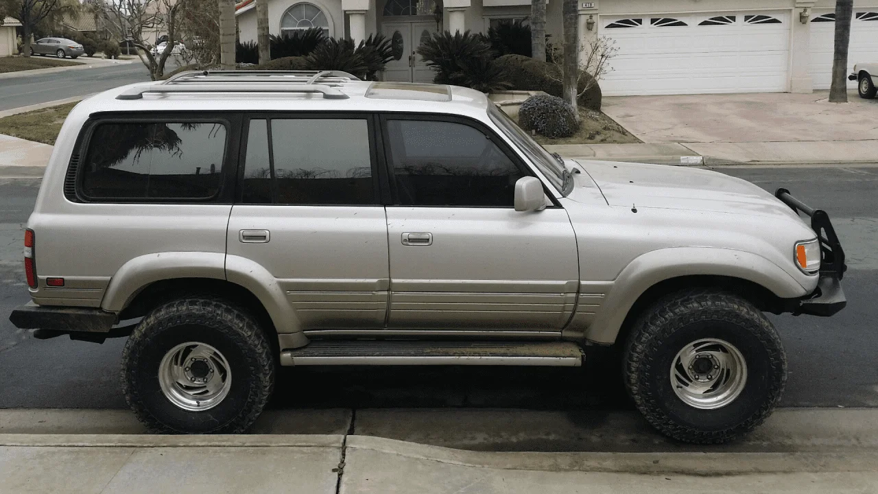

Just installed J springs/35x12.50x15's
You are gonna want to run extended brake lines and longer shocks to get the most out of that suspension... As for castor correction, I still don't have any after 3.5 years. It was never bad enough for me to worry about. Now with 37" bias Iroks and a new daughter, I will fix my castor! :flipoff2:
I don't see what's fishy? They either clear or they don't and mine fits with about 1/2" clearance in the front and about 1/4" in the rear. Once they are bolted up it's not like they are gonna suddenly move unless the wheel or spacer comes loose. In that case you have bigger problems to begin with.
Just my 2 cents :wrench:
I'm thinking that you either have smaller brakes or they have been clearanced already. FZJs run 16" wheels because of brake clearance. How they fit without modification makes me wonder...that's all.
I plan on doing shocks and extended stainless break lines in the near future. As well as castor correction in the semi-near future. I can't save enough to buy everything at once, I end up going to the bar and spending it :bang:
This way it's driveable and wheelable. The tires fully tuck in the rear with no rubbing whatsoever, so no need to drop the bumpstops. The front bumper needs trimmed a bit, but other than that everything fits nicely.

Thanks for the feedback. I got a ton more to do, just wanted to show that it is more than possible to run 35" tires with only J srings (if you don't have winch/bumper) as well as being able to fit 15's with no clearancing, only wheel spacers.

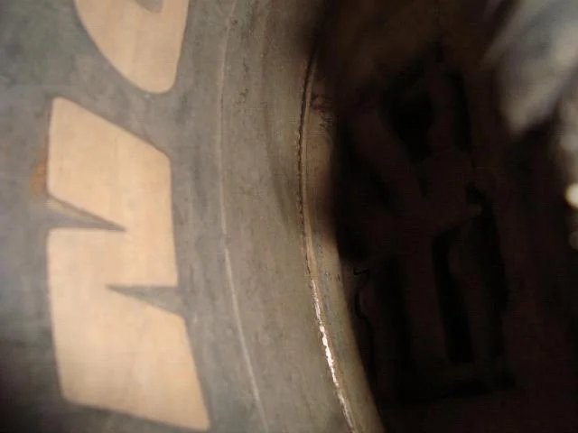

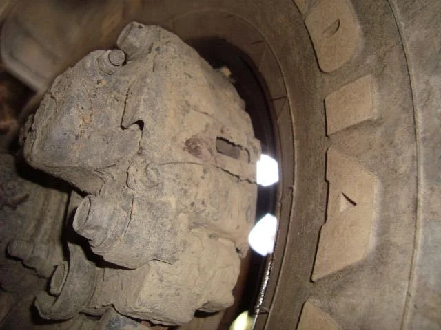

Here's a pic of the rear and the front caliper clearance, the front didn't turn out good cause of the tie rod, and I'd estimate my BS at 3", I gotta take them off after work to balance them, I'll take good measurements then.
The first is the rear and the second is the front.
Hope this helps..

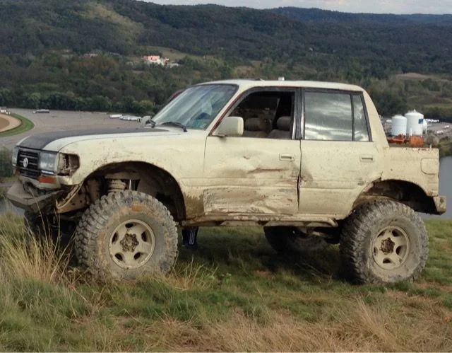

Oh it's coming haha, ditched the 15's (kept bending wheels) and went back to the stockers with 345/75/16 KM2's...
Oh and lost some body and gained some body damage ;)

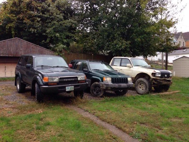

Also got a new one (93 that had a thrown rod) got her running, so it's been my DD for 6 months now...

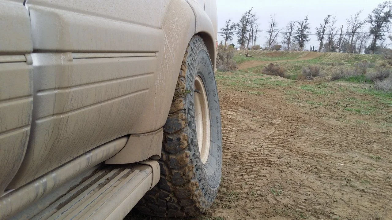

Thanks here is my tight little ride with 35s on 15x8 rims.
I have 1.5 spacers & 3.5" BS. Way to far out. My tires aren't tucking in.
I will be reducing the spacer size & repost my findings...
Here's a pic of the calipers & rim.
