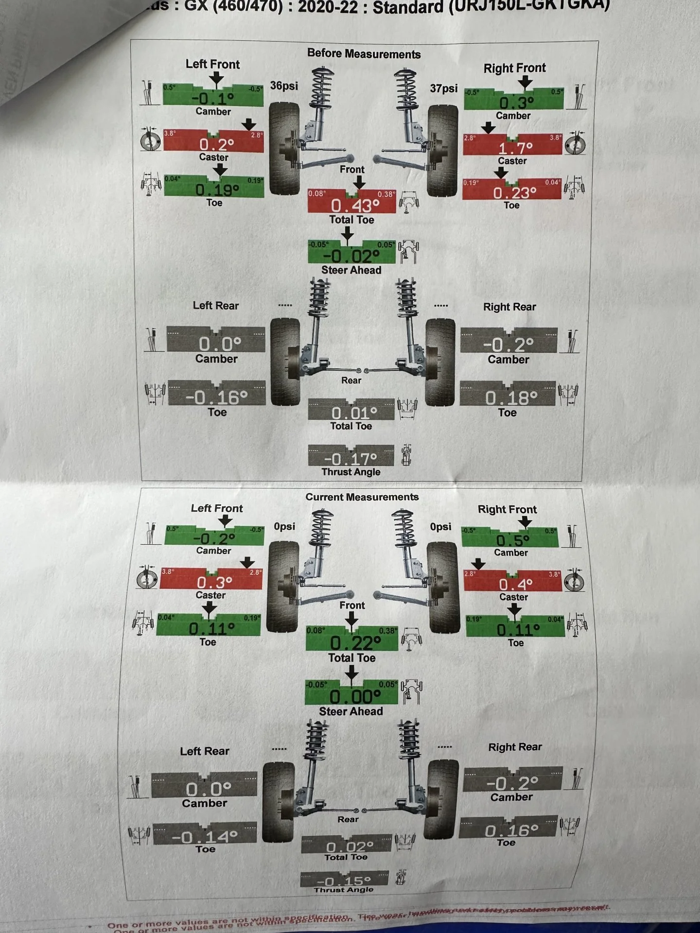

So, I had my 1.75” front/1.5” lift rear installed. Since, I’ve had two different Toyota dealers complete alignments and today the alignment sheet given to me still doesn’t seem good regarding caster. Should I get another one somewhere else? I’m limited locally with shops that have any idea how to do an alignment with a lift. Thoughts on these specs?

Did your lift include adjustable upper control arms? With the lift you will be lucky to get anymore than like one degree positive caster out of your lower control arm eccentrics. Spec for caster is between 2’30” to 3’ degrees right?
So, I’ve only driven it around town and so far it feels ok. But I’ve yet to drive it on the highway which I know needs to happen. However, based on my lift and research/advice received, I didn’t think I would need an UCA to dial it in. It appears that maybe now I will need UCA’s to get it within spec based on the Toyota mechanics summary. He took 2.5 hours to try and dial it in today and the attachment I included is the closest he could get.

No, your first stop is to a competent alignment shop. If you look at the printout, your alignment tech moved your front right caster from just under the lower end of spec to horribly out of spec. They actually made caster worse. That means he actually moved the lower ball joint backwards in the wheel well (by rotating the lower control arm the wrong way). It should be moved forward. He may have done this to keep the camber in spec, but not likely. The driver side lower control arm needs to be moved forward as well, too. I know your options are limited, but you may want to find some time to chat with some repair shops that have their own alignment machines, etc. If you keep your alignment as is, and add an aftermarket UCA, you are going to push that tire into the rear plastic of the fender well and rub on the pinch weld, because the aftermarket UCA will move your upper ball joint backwards as well in an attempt to fix caster.

Please help me understand the caster specs you mentioned here, as I'm also learning here. The alignment printout shows the right front caster going from 1.7 to 0.4, however you mention that this new value (0.4) is 'horribly out of spec'. My layman interpretation would be that it is 'more in spec', is that incorrect? What would be an 'in spec' caster value in this case?
The diagram shows the caster spec is 2.8 to 3.8 degrees. Caster determines the 'self centering' force. More caster = more self centering which means more stability, especially noticeable at high speed. .04 might drive poorly at speed.

Ok, went to an alignment shop today where the guy is a 43 year experienced technician. He has done many lifts, builds, and understands caster and adjustable UCA‘s like SPC. After looking at my setup, he could not get caster anywhere close to spec and recommended I get the SPC’S which not only he will install but then dial in to the 3.7-4.1 spec range. Looking back, I should have done UCA’s while installing my lift. We live and learn. Hopefully all is well after this coming Monday.
Something is not right here. Yes, adjustable (or fixed) UCAs will add a few degrees of caster - but - why can't anyone adjust your LCA cam bolts to get closer to spec? And you're likely to rub in the rear when you move the upper ball joint back that far. Any way to roll underneath and snap some pictures of your cam bolts?
Yeah, I’m really confused too. I can’t understand it. They are telling me the lower cam bolts are maxed out to the “ears” and can’t be adjusted any further to allow more caster. This is the same response from 3 different shops, 2 being Toyota dealers. I will snap some pics in the morning for sure. I just purchased the SPC UCA’s and am currently scheduled to have them installed Monday. According to the tech today, he has no doubt he can then dial things in properly. Ugh, so frustrating.

For reference, here what my passenger side LCA cam bolts look like. Not maxed out, but close. Maxed out means front cam bolt is all the way inboard, and rear cam bolt is all the way outboard. See how yours compare.
Front cam bolt, looking towards the rear of the vehicle. It would need to be at 3 o'clock to be "maxed out".
Rear cam bolt, looking forward. It is at its max outboard, 3 o'clock position.
This combination rotates the LCA counter clockwise in a horizontal plane (as viewed from above) moving the lower ball joint/knuckle attachment point forward, thereby increasing caster relative to the fixed upper knuckle mount.
I have aftermarket welded-on cam tab gussets, since I flattened the OEM ones...
With a 2" Ironman Nitro lift, I was able to get ~2.4° caster with the OEM UCAs.
So are you or are you not, implying the welded on reinforcements altered the stock ajustment range? As opposed to replacement upper arms with additional caster ajustment?
Welded on reinforcements should not affect adjustment range as compared to OEM. Replacement upper arms will increase caster regardless. Just noting that my setup might not look quite like the OP's.

Good point, and I agree. I had planned on getting SPC's down the road once I installed a more robust lift after the other mods are done over time. However, it appears that anyone with close to a 2" lift or more will definitely need UCA's to dial in the caster correctly. I was hoping to get close with stock UCA's which would last until the upgraded lift was installed, but that does not look like an option now. So, let's install the SPC's and dial it in and then I am all set. Of course, hindsight being 20/20, I should have installed the SPC's from day one and we wouldn't be having this conversation LOL.
