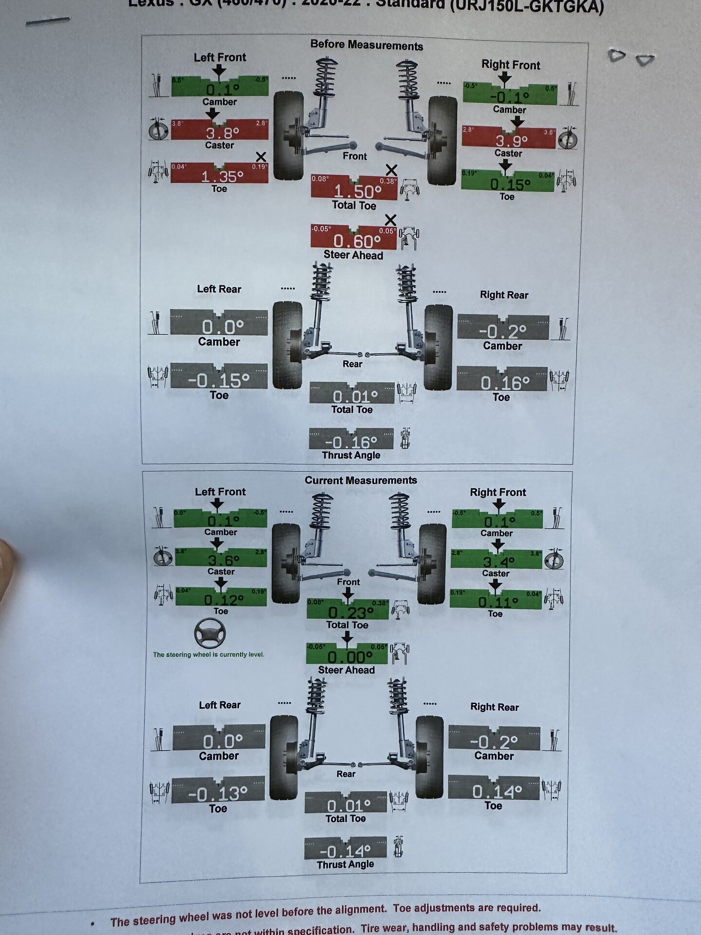

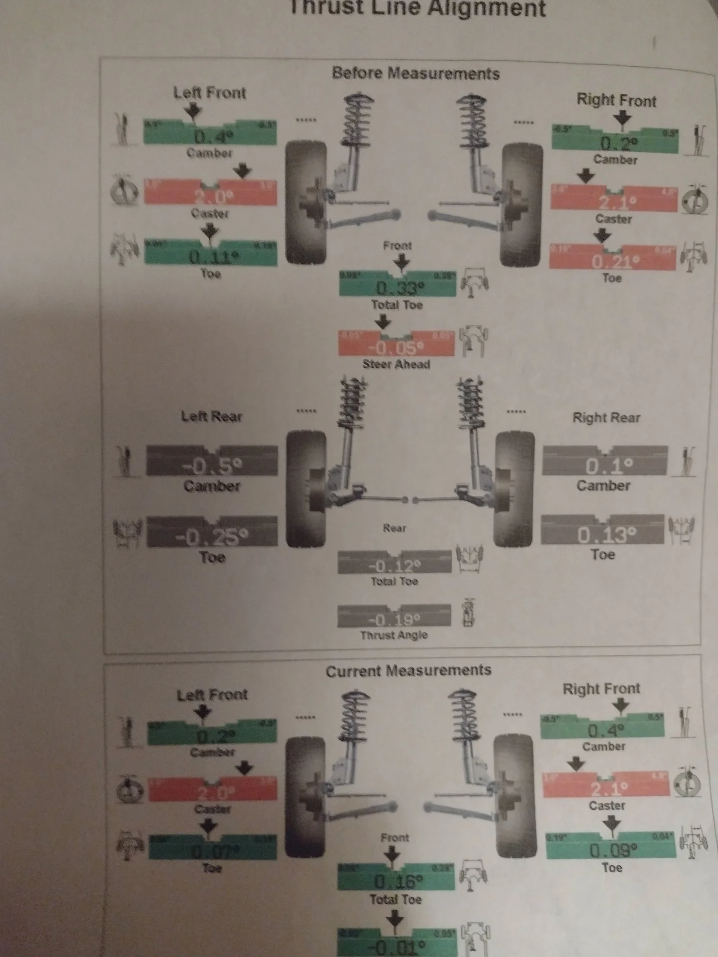

So what should caster be set to? Here's my alignment sheet on my 19 after I did Dobinsons springs that gave me about 1.25 inch lift in the front. My truck drives straight and stable on the highway.
I'm pretty convinced that most alignment shops don't really even try to do much of anything. They changed your toe by a couple of threads on you tie rod ends, that's about all they did. But your caster wasn't THAT bad to start with, certainly much better that the OP's.

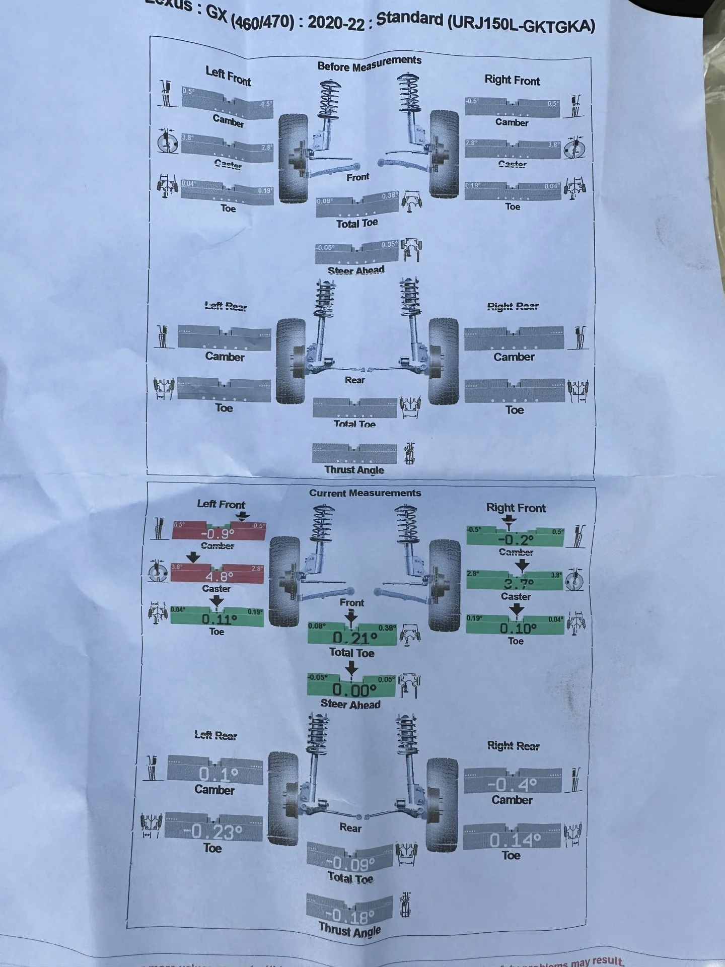

Ok, so after getting the SPC’s installed, and 4 alignment attempts with 4 different shops later, this is the best anyone has been able to do at this point. It amazes me the lack of 4x4 support, knowledge, or skill in upstate NY with such a rural surrounding. Incompetent techs are a dime a dozen these days. It appears I need to broaden my search for an alignment shop 2 hours or further out from my house….

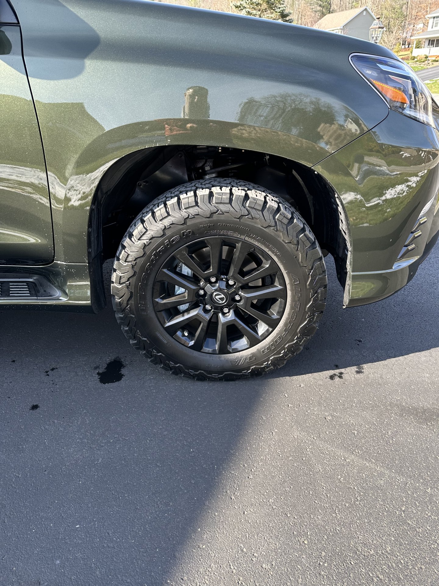

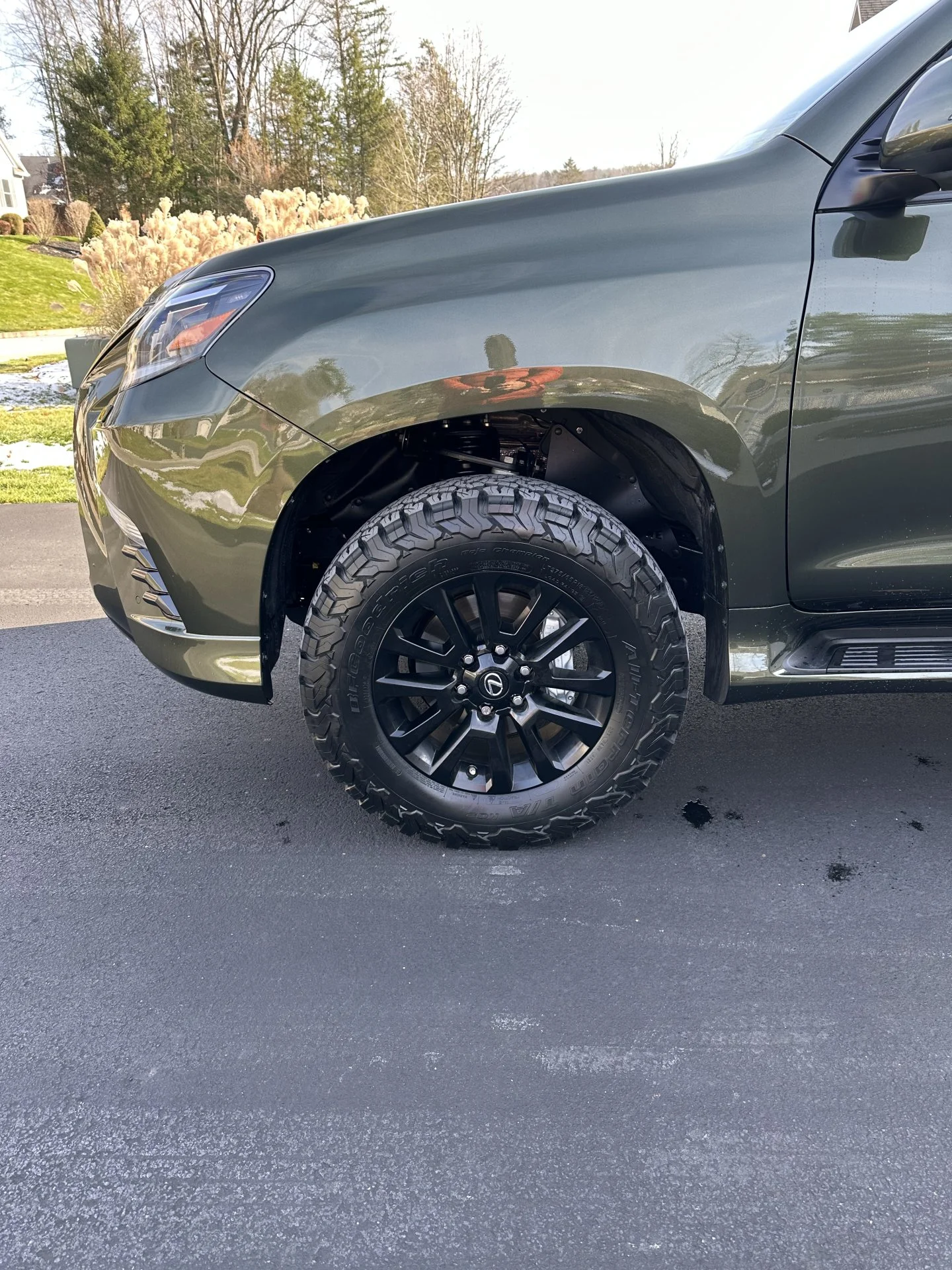

Only drove it home from the dealer. But, the steering wheel is still crooked and to short of a drive to tell. For reference, the shop yesterday had my wheels back in the wheel well so far that they rubbed horribly from just turning left on right on a level road. So, within a 2 hour drive of zip 13901, does anyone know of a competent alignment shop that has any clue how to dial in an alignment with a 1.75" lift and SCP upper control arms? It's astonishing how difficult it is here in upstate NY to find a shop that has any clue how to do this. Ugh.....

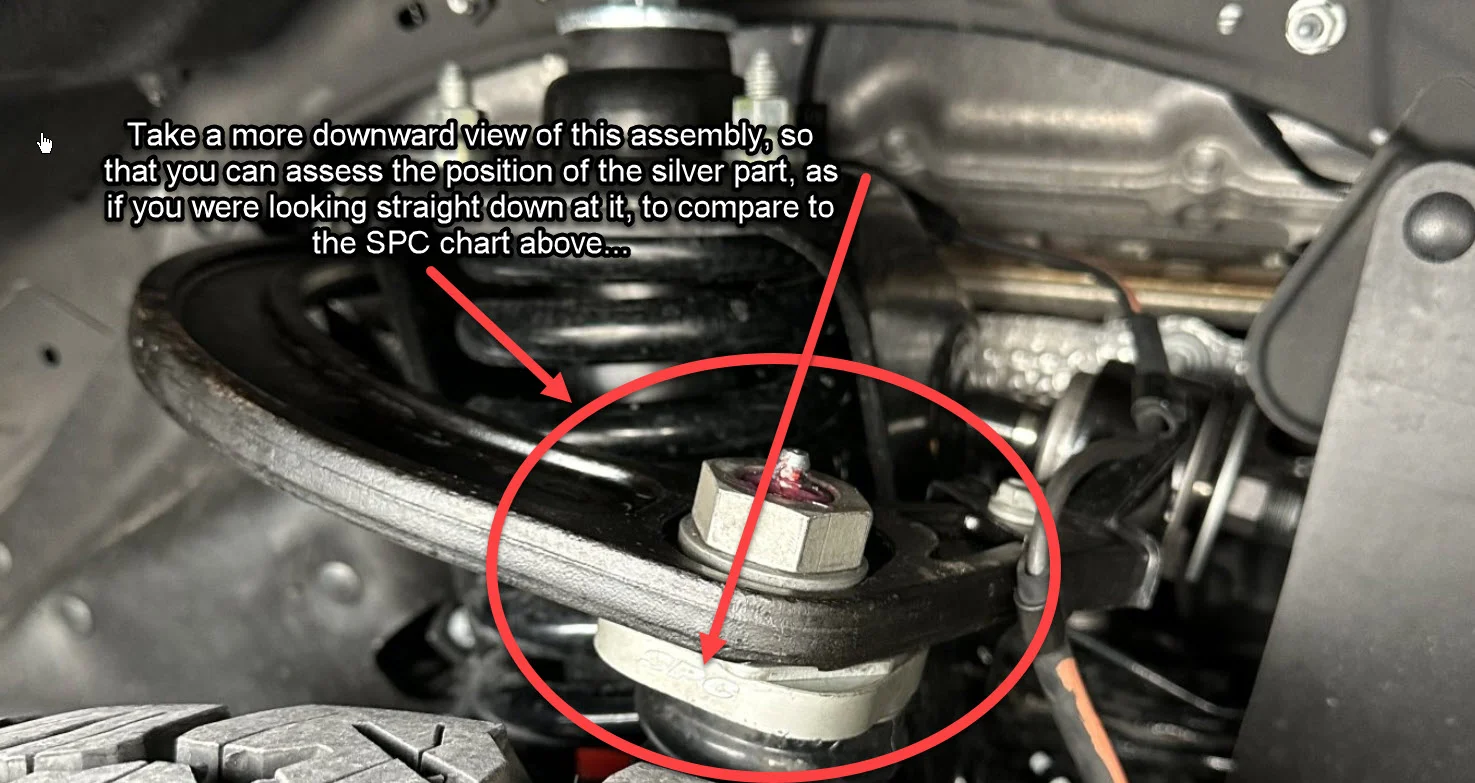

Phew, glad I'm not the first one again to have to burst your bubble about the crappy shops in your area. The good news is, your caster is better. The bad news is that the rubbing is predictable, since the SPC install shop likely didn't mess with the LCA's at all. And the fact that your camber is out is inexcusable, given that you're running "adjustable" upper control arms. That's the whole point. He can dial in the caster, and then slide the ENTIRE upper ball joint assembly in and out in the slot in the UCA to dial in camber. Maybe this will be the impetus to realize the pervasive ineptitude in the industry, and emolden you to go out and "fix it yourself", haha. No, seriously...

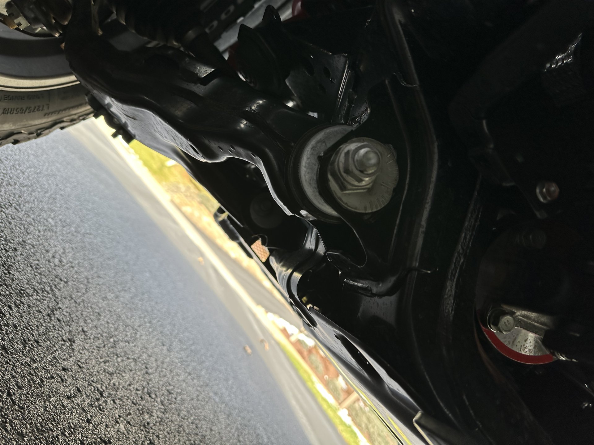

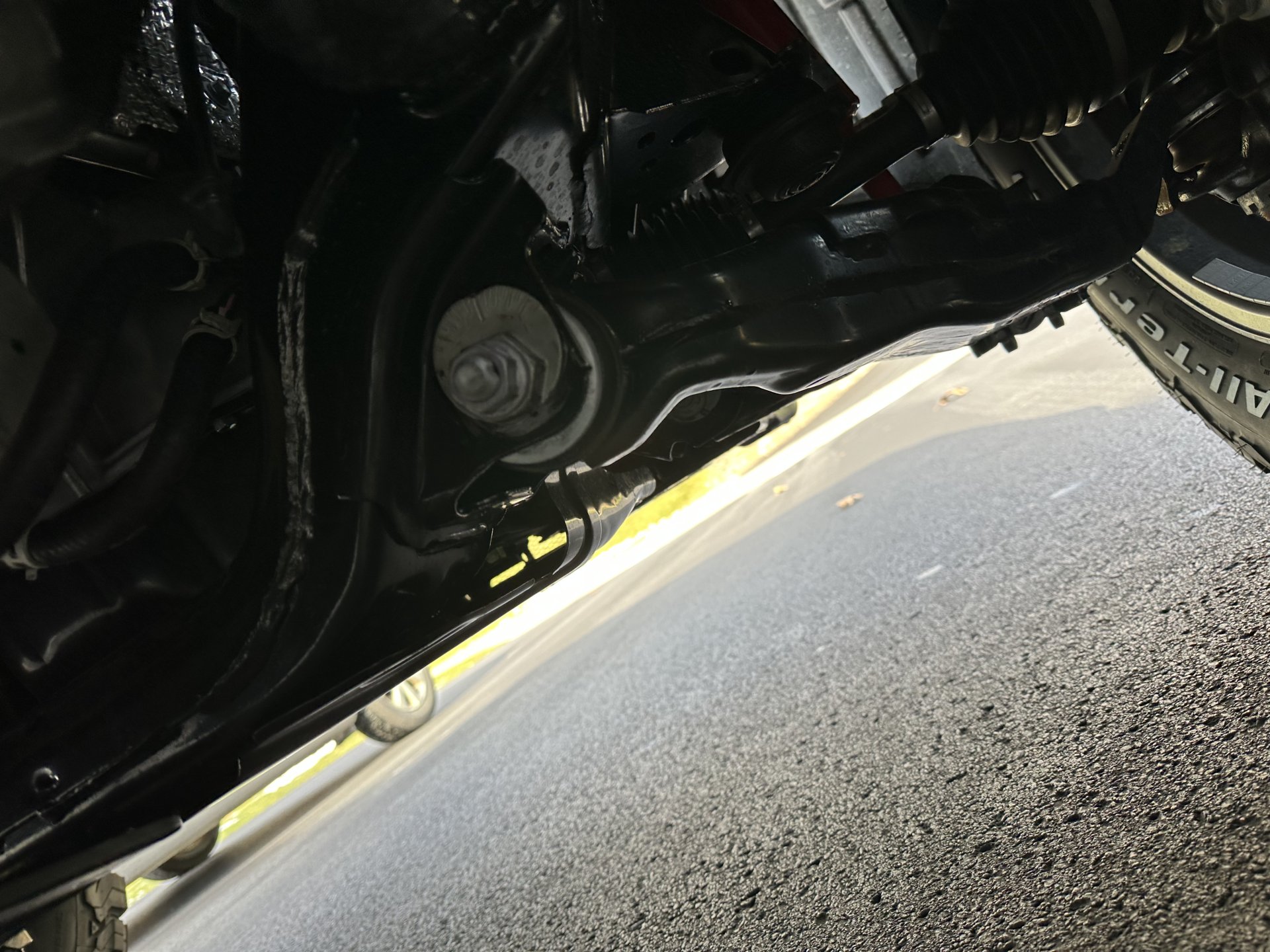

Your next step: Go out to your rig, and take a better picture of the upper ball join on both sides. It is entirely possible that the shop that installed the SPC UCA's didn't put both joints in the same position, and that would (be the easiest way to) explain the one degree difference between the L and R side. Take some pictures inside the wheel well looking down at about 45 degrees on to the upper ball joint assembly so that you can assess yours, versus the diagram below.

Do the same for both sides, to see if they are installed in the same position.

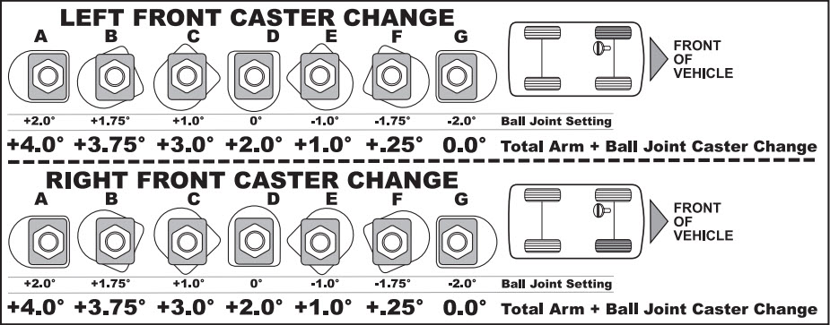

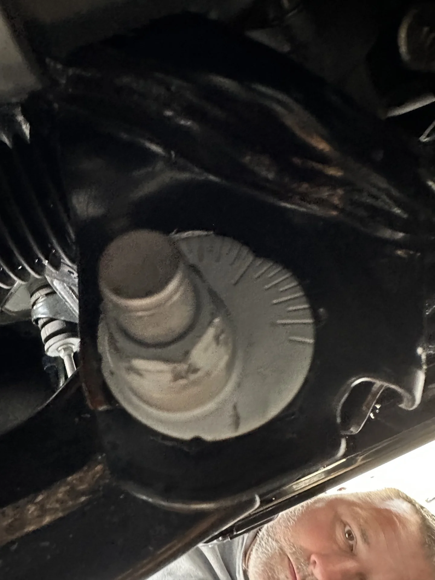

It appears as if the DS is set to position "D". Can't discern the passengers side from the photos you posted, but it very well could be in position "E", which would explain the extra caster on the DS.
And no lie, I got a little sea-sick trying to figure out your cam pictures. Usually easier if the ground is near the bottom and level-ish... :lol:
In any, case, they are not both maxed out, though it looks like driver's rear one might be (fully outboard).

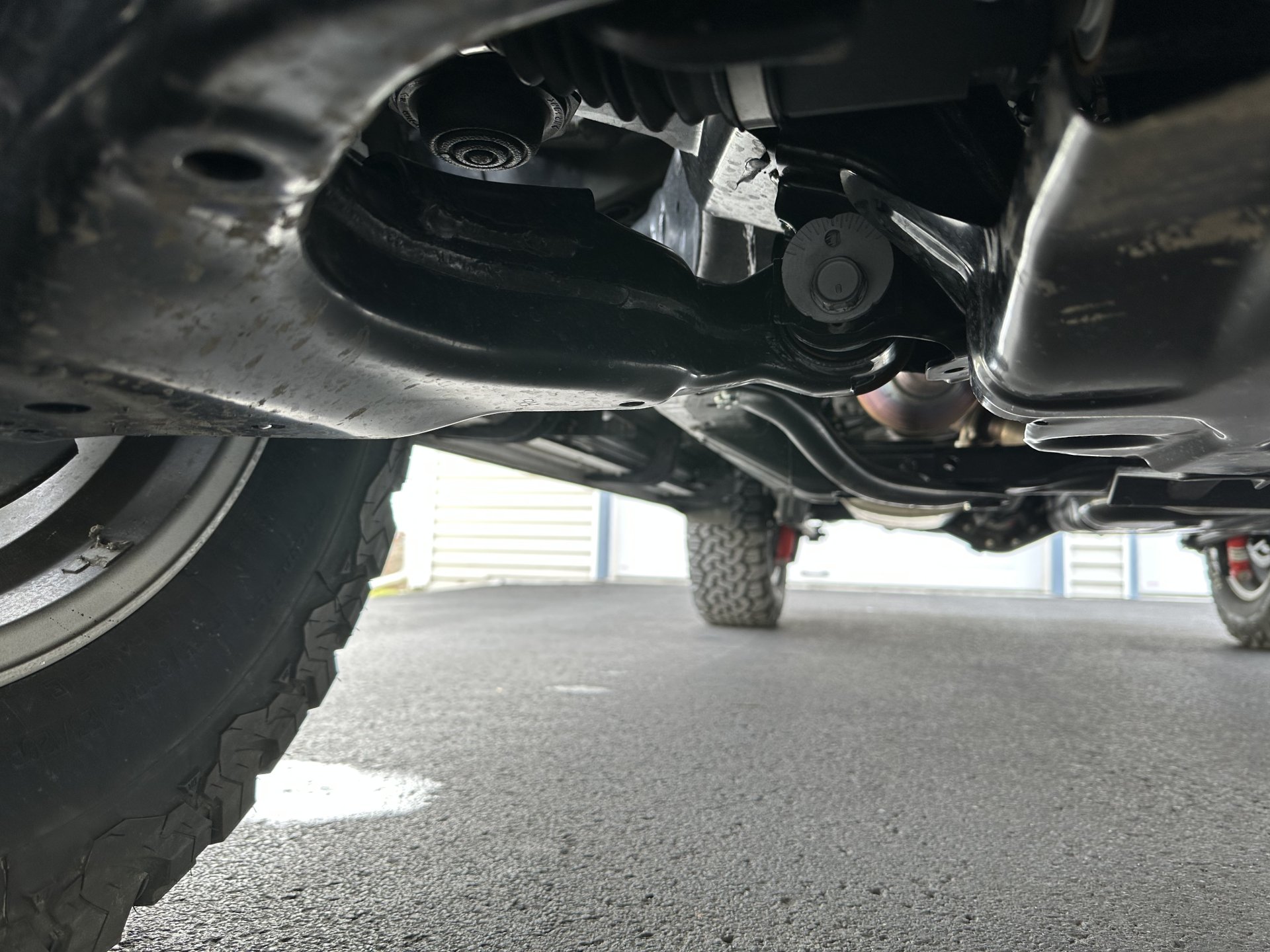

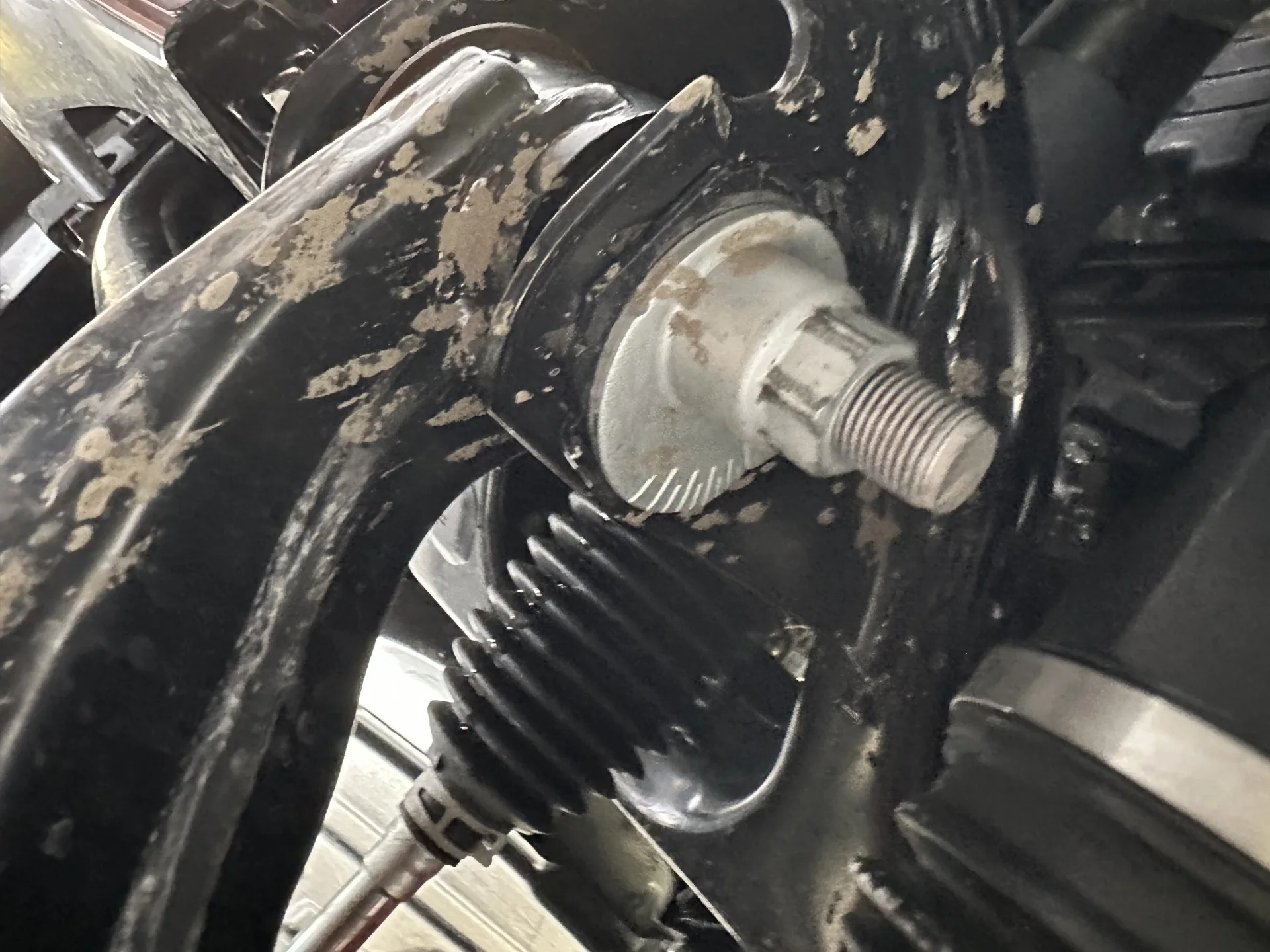

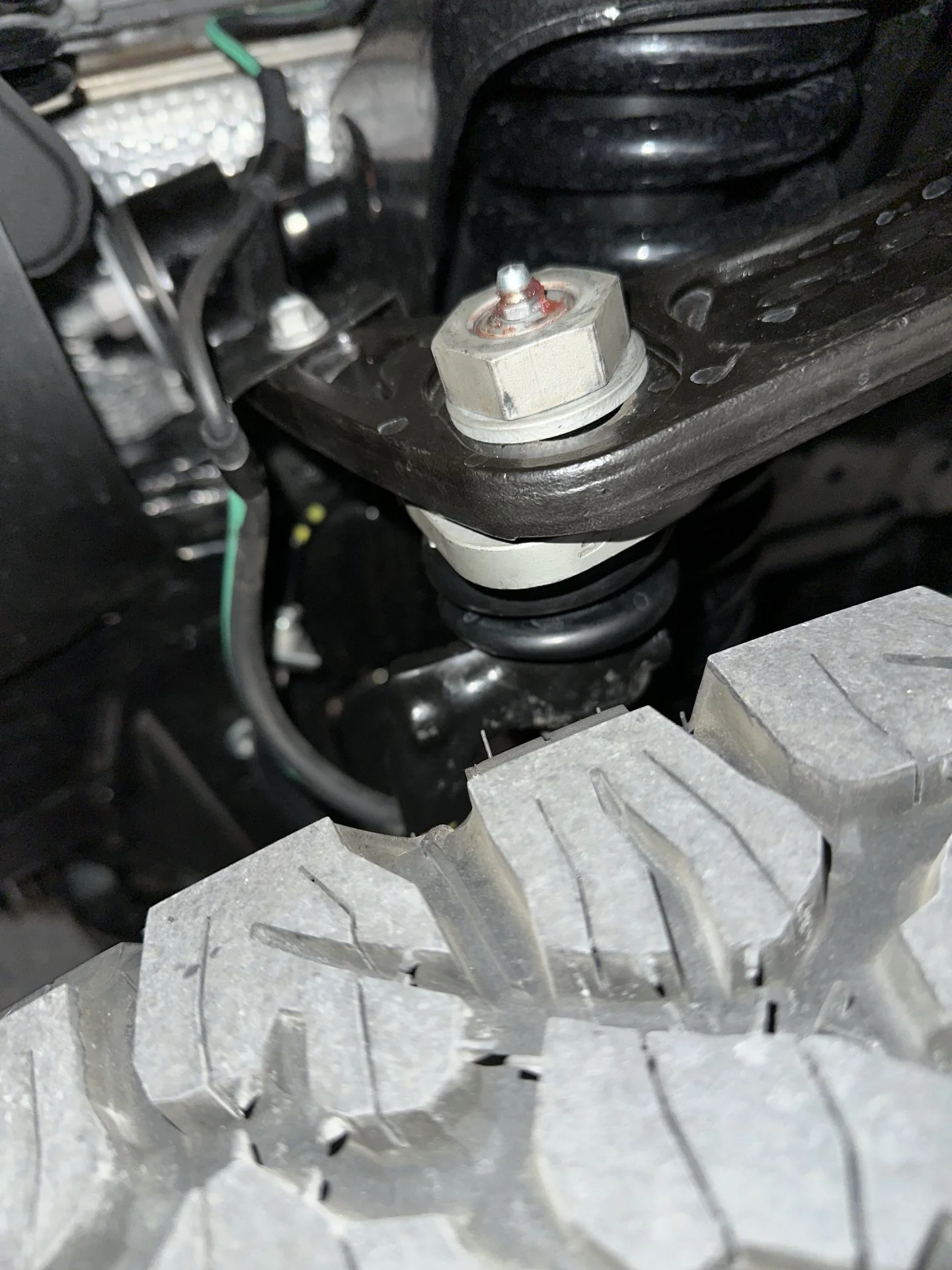

So sorry for the bad pics…ugh, I feel your frustration. Hope this UCA angle help?
Well the good news is that at least your tech set the upper ball joints on both sides the same (position D), and greased your ball joints... The other piece of good news is that it probably drives pretty well at speed now. I doubt you could tell the difference of 1 degree between the L/R side, except that you mention your steering wheel is off center? That is strange, since That shouldn't have changed much based on your toe measurements.
Are you still getting rubbing?
Confirm you rig was purchased brand new? no accident history, frame damage, etc? that would prevent good mechanical alignment?
This has to be really infuriating for you. 2 Toyota shops with idiots in the alignment dept. 2 other shops with equal idiots. This really shouldn't take a competent alignment shop more that an hour to dial in. Your tire size is close to that of having rubbing issues, especially with the offset on the 18" OEM rims (the rim center line is closer inboard to the center of the car). But really again, with SPC uppers, the process is rotate the lowers as far forward as possible to avoid the rubbing in the back, and not rub up front, then dial in the alignment with the upper ball joints by rotating their position to dial in caster and slide them in and out to dial in camber. Adjust TRE for toe. There is just no reason for your steering wheel center position to have changed that much. When driving straight down the road, which direction is your steering wheel point relative to straight?

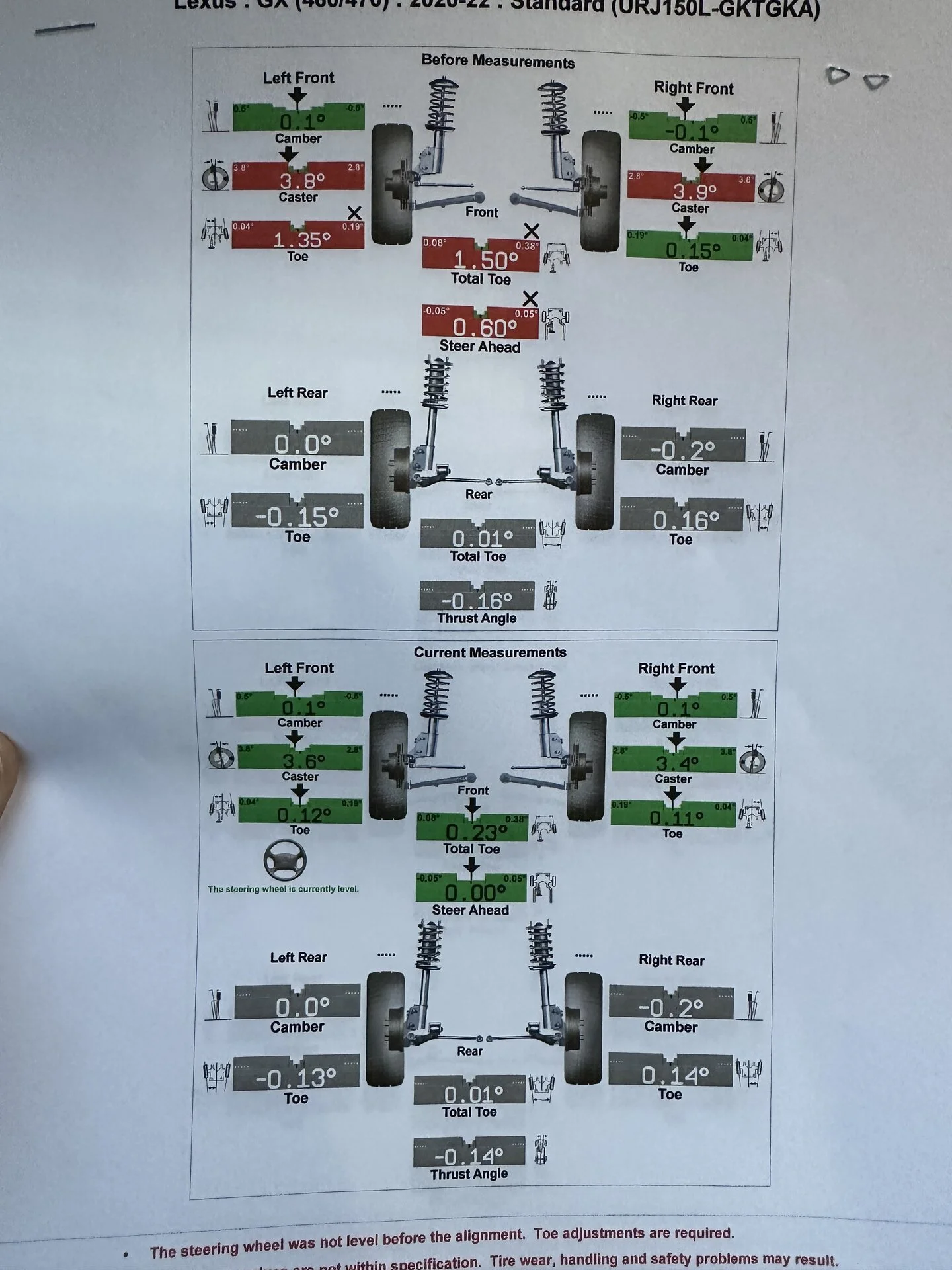

My rig is new, and just passed only 1k miles. Ok, here is an alignment I had done today by the original Toyota dealer whose tech told me I needed aftermarket UCA’s. So, everything is in the green now which is good. It drives straight and steering wheel is straight. The caster is in the green on both sides but visually the tire still sits slightly back favoring the rear wheel well slightly rather than centered in the wheel well. There is zero rubbing but could he have gone higher on the caster spec and still been in the green? On the sheet, it says “2020-2022 GX 460”.
