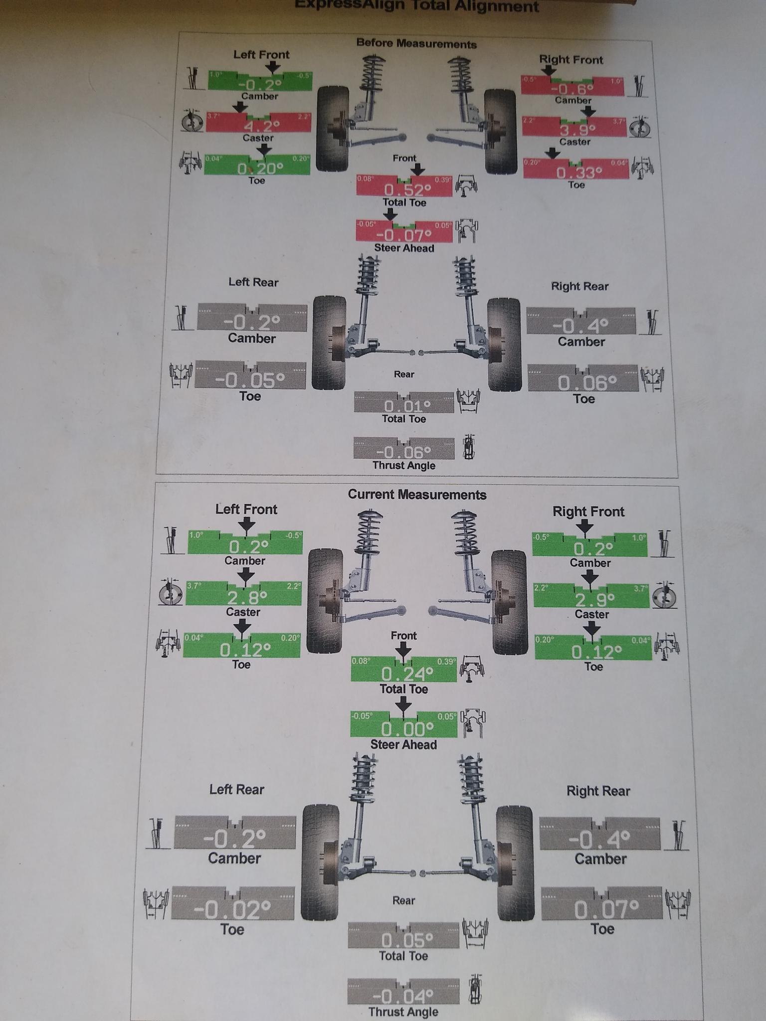

Have a printout of the current alignment angles? Any prior crash damage?
I just had mine done at Schwab after new UCAs were installed. no major issues for $114 and they hit everything but caster (cross castered by 0.1 deg but close enough)

Give Tustin Toyota a try. I have had them align my land cruiser twice, OEM front spacer lift and bilstein lift. Both turned out well. Make sure to let them know what they need to correct with the current alignment when talking to the advisor. I asked for a print out of the alignment and they obliged. They always give me a small discount even though they perform no other services on my vehicle.

Did the UCA installation myself. I used the cheap NitroGear UCAs and a coupon code from mud for ~$250 shipped. I'd have prefered to stay on stock OEM UCAs but the lift blew the camber out
