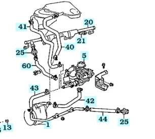

i need parts 41 and 40 above. A bit expensive for used hoses on SOR. these are the air injection and smog pump to air cleaner hose. Is there anything special about these hoses or can i just order generic hoses with this diameter from NAPA? appreciate the input.
also does anyone know what diameter these are, i still looking for my calipers :bang:
Most of them have sharp bends. Do yourself a (expensive) favor and just pony up and purchase the used hoses from SOR

There was a thread about someone having silicone hoses made to match...but that kind of dried up. In some sense hose 41 isn't really needed. It is for when air is not injected into the exhaust but bypassed to the air cleaner. Just let the ABV blow bypass air into the engine compartment. Also for hose 40, I suppose you can attach a breather filter to directly to the smog pump inlet instead of pulling from inside the air cleaner. This empty port on the filtered side of the air cleaner would needs to be capped. You may not pass visual inspection if that is a concern. The other hoses you may be able to piece together from existing molded heater hoses, etc.
For 40 and 41, these come off and on quite often at the air cleaner end. I use some silicone grease inside the tube. It helps the tube stay flexible and it doesn't stick to the hose port, reducing likelihood of damage.

If all the used hoses disappear tomorrow you could go to your local fab shop and have some metal pipes bent up close enough to the shape to work…use some silicon straight pieces to connect everything and carry on.
I've got 41 but shipping will probably be a deal killer. PM me if you're interested. It's has a serious u shaped bend in it right before the air pump. Doubtful you could get a generic piece to bend like that w/out kinking.
