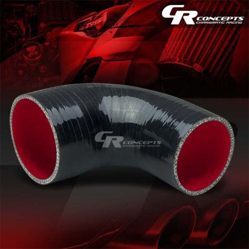

My air filter housing (60 series) flex pipe to smaller diameter (I haven’t measured yet) turbo is on its way out. Anyone found a suitable tapered flex pipe? Toyota part number? Or have a good used one?
I talked to a friend from MUD here in Ontario. He’s got the nicest rust free 60 I’ve ever seen. California truck. 3B with new turbo.
This is where he got this replacement.
Just have to look J
Screen shot. He said he had to modify the air cleaner housing or something to get the angle right. I might see him again so if I do I’ll get better pic and info. BTW, I've got the same almost onto my GTurbo, and it's running 20+psi at times. It came with the turbo, so I'd not give collapsing
much thought, this stuff is pretty rigid in place, more worried about sealing and clamping
For some reason even if I turn my cleaner lid I think I have much more reach than that picture, different manifold maybe? That turbo appears to be towards the front more than centred on the manifold like mine.
