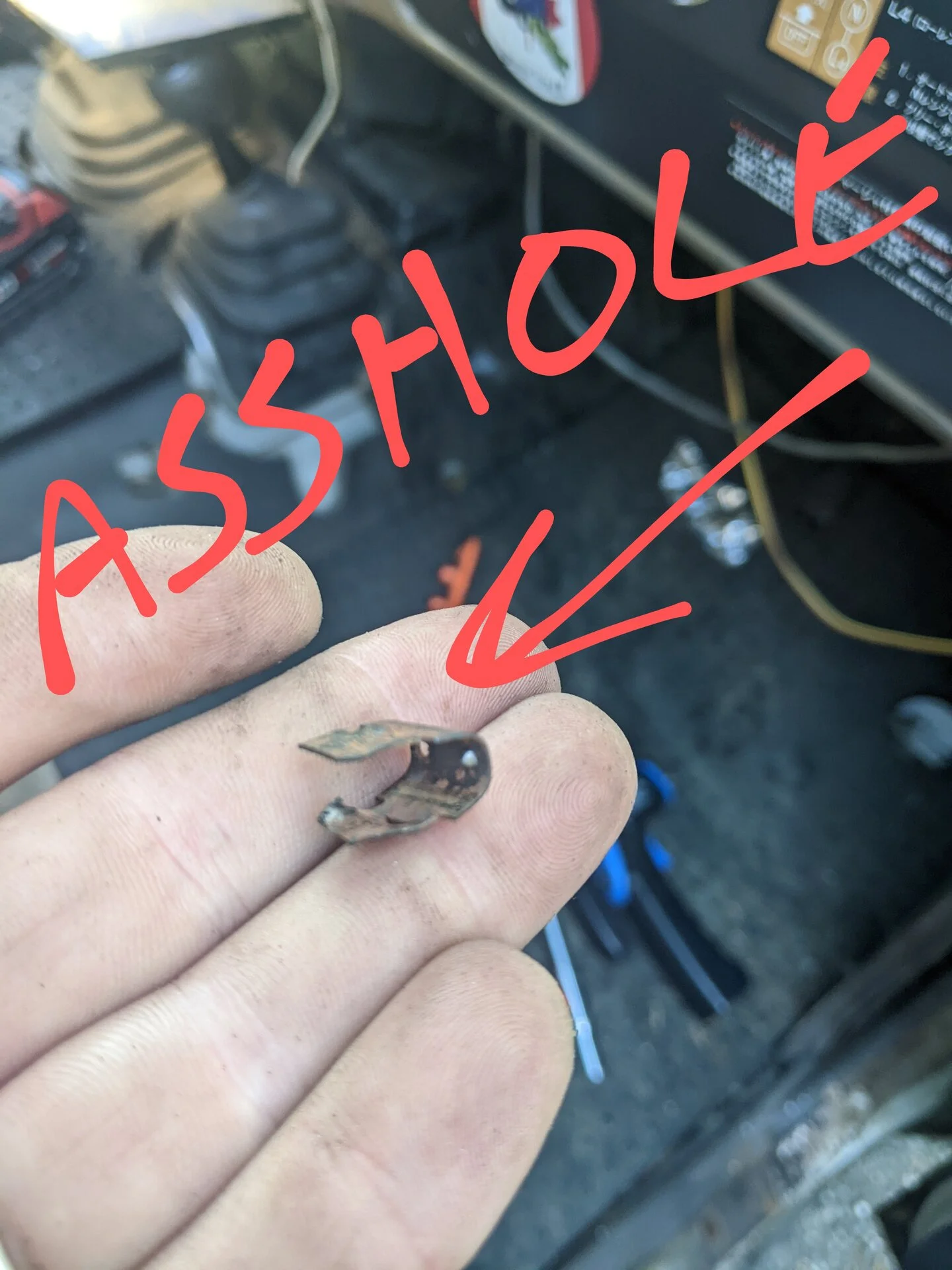

Lol found the culprit.
That'd be the clamp for the heater control in the air duct. Annoying thing is I checked it last year and it was holding ok...but I bet it wasn't going to full heat.
In my defense for not looking at the stupid first, I wanted a new thermostat anyways. I hadn't replaced it since that electrical ground issue and always wondered if the copper in it had gotten nuked.

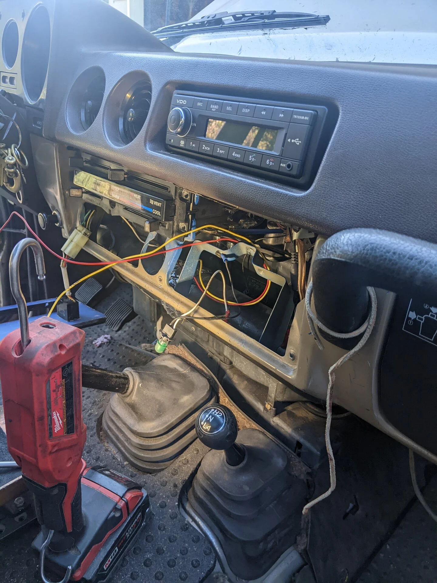

Added bonus of the big dash panel I made. Access is way easier. 4 screws to get here.

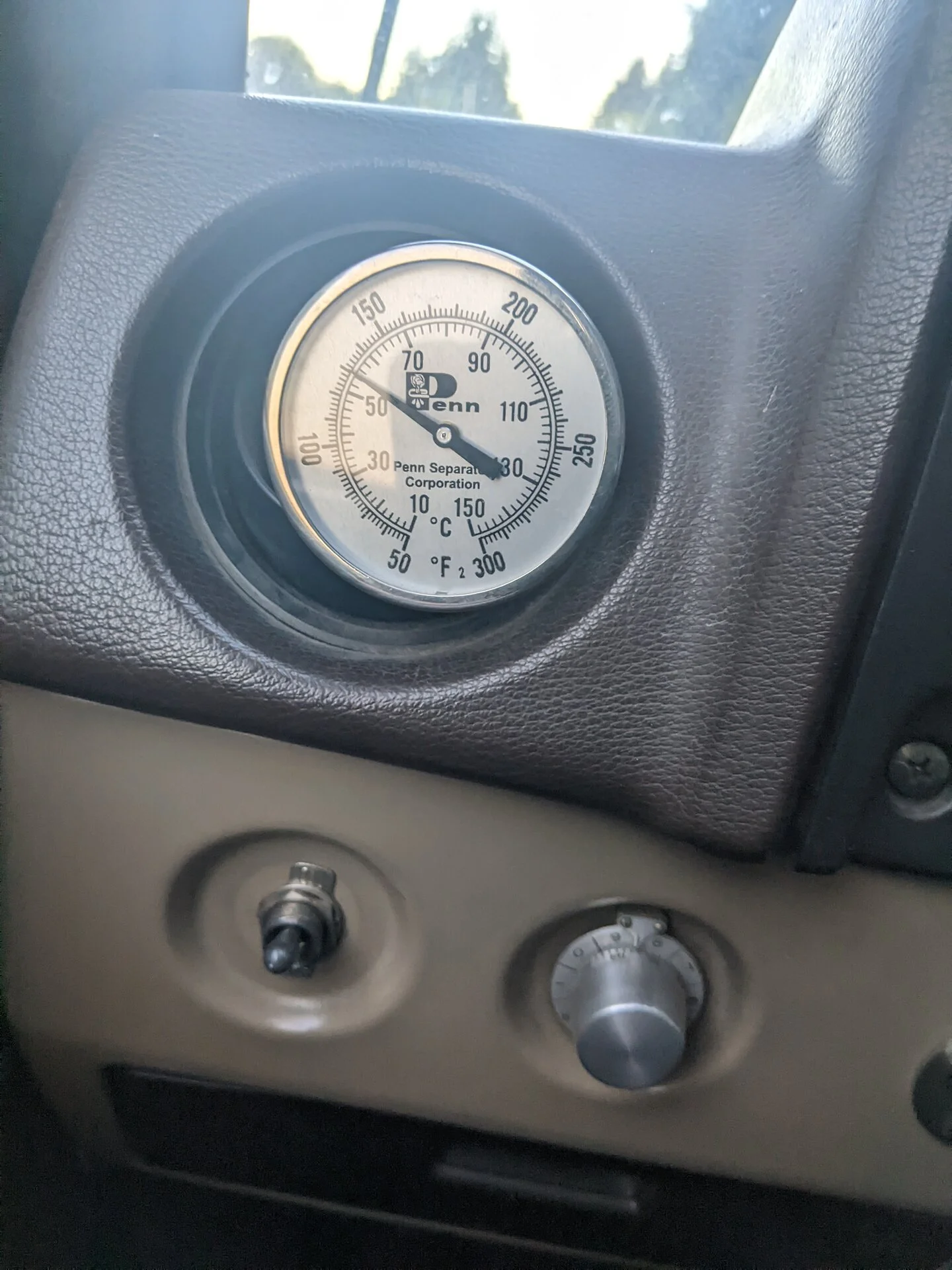

Curious to see what I get for heat after this. Maxed out at about 35c before.
More like it. Actually had warm legs driving to work tonight. 😁
I want to put that thermometer in my 40s vent now. That f***ing thing wants to melt my right shoe 🤣
Sounds about right for your 40.

That little clip up above you found is the reason I gather all of everyone’s garbage bits. Thanks to your donation
of RHD stuff I got that for mine which had been broken since I got the truck. Worth it all for that little piece!

Yeah those clips suck, and unless you rotate the jacket of the cable to make sure the teeth bite in they just slip again.
