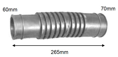

My air filter housing (60 series) flex pipe to smaller diameter (I haven’t measured yet) turbo is on its way out. Anyone found a suitable tapered flex pipe? Toyota part number? Or have a good used one?
Have you done any digging on this yet?
I actually managed to use mine on my turbo install and it's looking like yours, not quite as tight a bend but probably close enough.
I have been looking and it’s going to have to be a custom multi piece thing unfortunately there’s nothing worthwhile available. The fact that tapers makes using a one piece flex hose not an option, interestingly that taper is by design to compensate for any restrictive flow caused by bends.
My thought is to use a 3 inch hard pipe with the bend and a 3 inch silicone boot to the air filter housing lid and a 3 inch silicone reducer to my 2 3/4 turbo so it’s three inch the whole way until it necks down right at the turbo.
