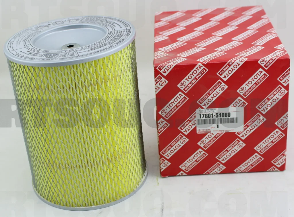

Anyone actually tried compressed air and washing these as described by toyota?
Legible instructions on an 80 series one:

It's about 10x cost of a regular filter on partsouq as an example. I didn't buy it because it made economic sense. More just fascination with Toyota's impressive OEM design.

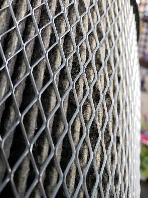

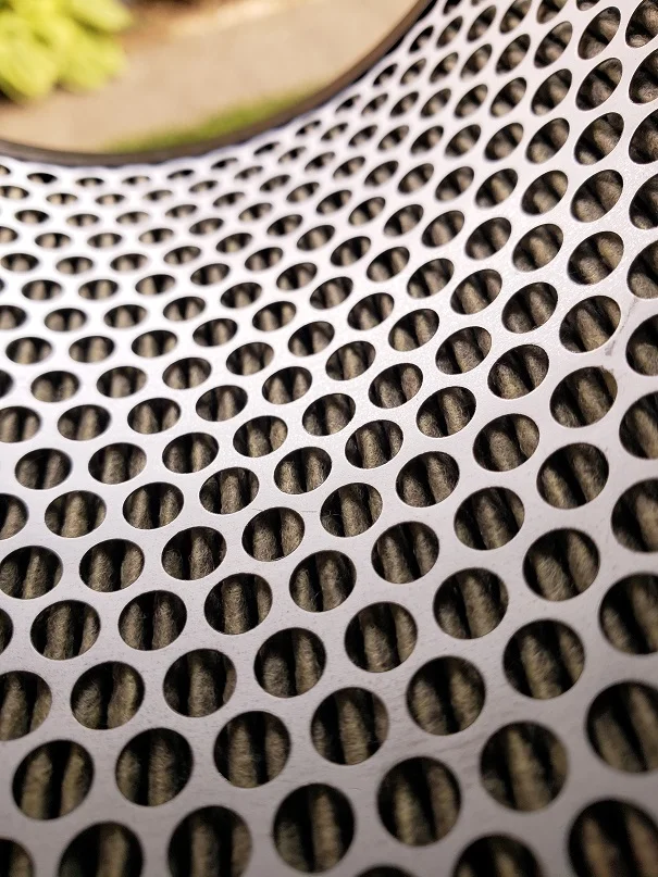

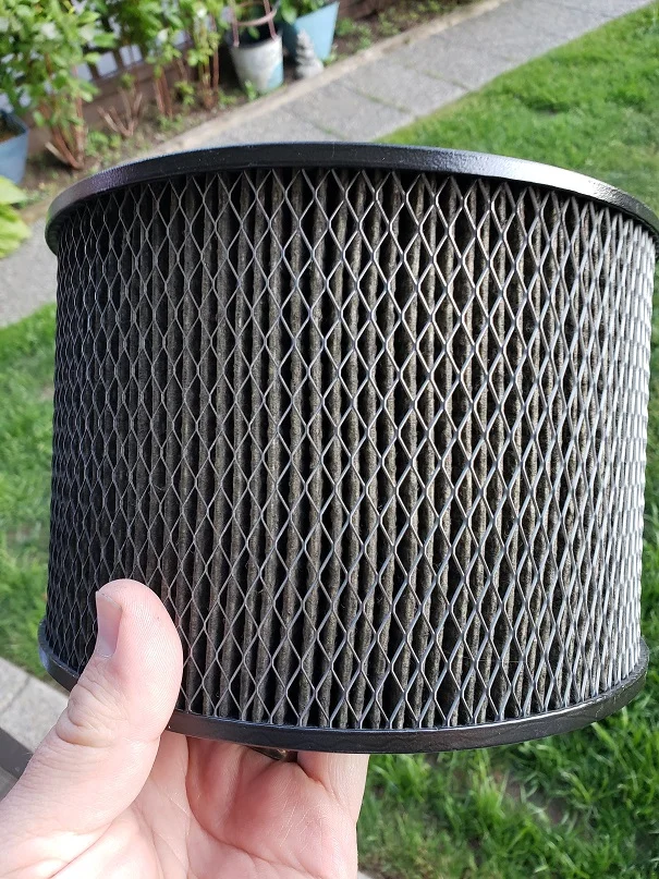

Hey Nick, here are some pics of mine. I have probably washed this about 3 times myself and who knows how many times it was washed by Steve.. The inside still looks clean-ish.
I think the biggest issue with washable filters is that it takes a whole day or more to dry out, even in mid summer sun! Don't cook them in an oven.. they might shrink.. ask me how I know.
Not quite the bright yellow as the new ones..

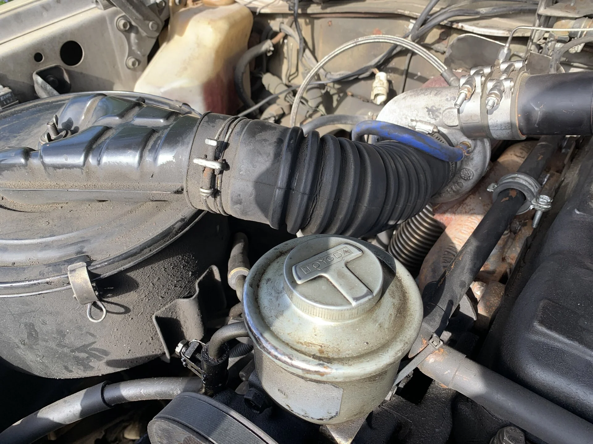

My air filter housing (60 series) flex pipe to smaller diameter (I haven’t measured yet) turbo is on its way out. Anyone found a suitable tapered flex pipe? Toyota part number? Or have a good used one?
I used silicone bilge blower hose on my 12ht, but it doesn't taper.
There's a billion silicone fittings out there... I figure I'll have to use those on my 40. Trying to avoid the hose clamp farm look tho.
And I dimly remember someone saying a ford of some kind had a hose that fit. One of the cheap s***ty Fords. Like a merkur or something
I just looked it up the OEM 60 air hose part number and they're discontinued. (17882-58070 I believe).
Depending on how much of a reduction, an exhaust shop could make one in a hard pipe for beer money. ;)
I and a pipe made for my fuel filled when I couldn't buy pipe the sizes I needed.
