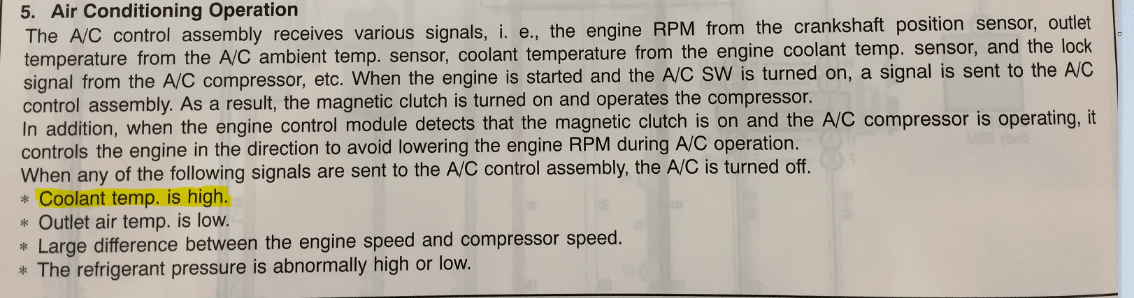

If your coolant temperature gets too high, the compressor clutch will be disengaged, disabling the AC, until the coolant temperature drops:
Properly service your coolant system, see if that helps.
