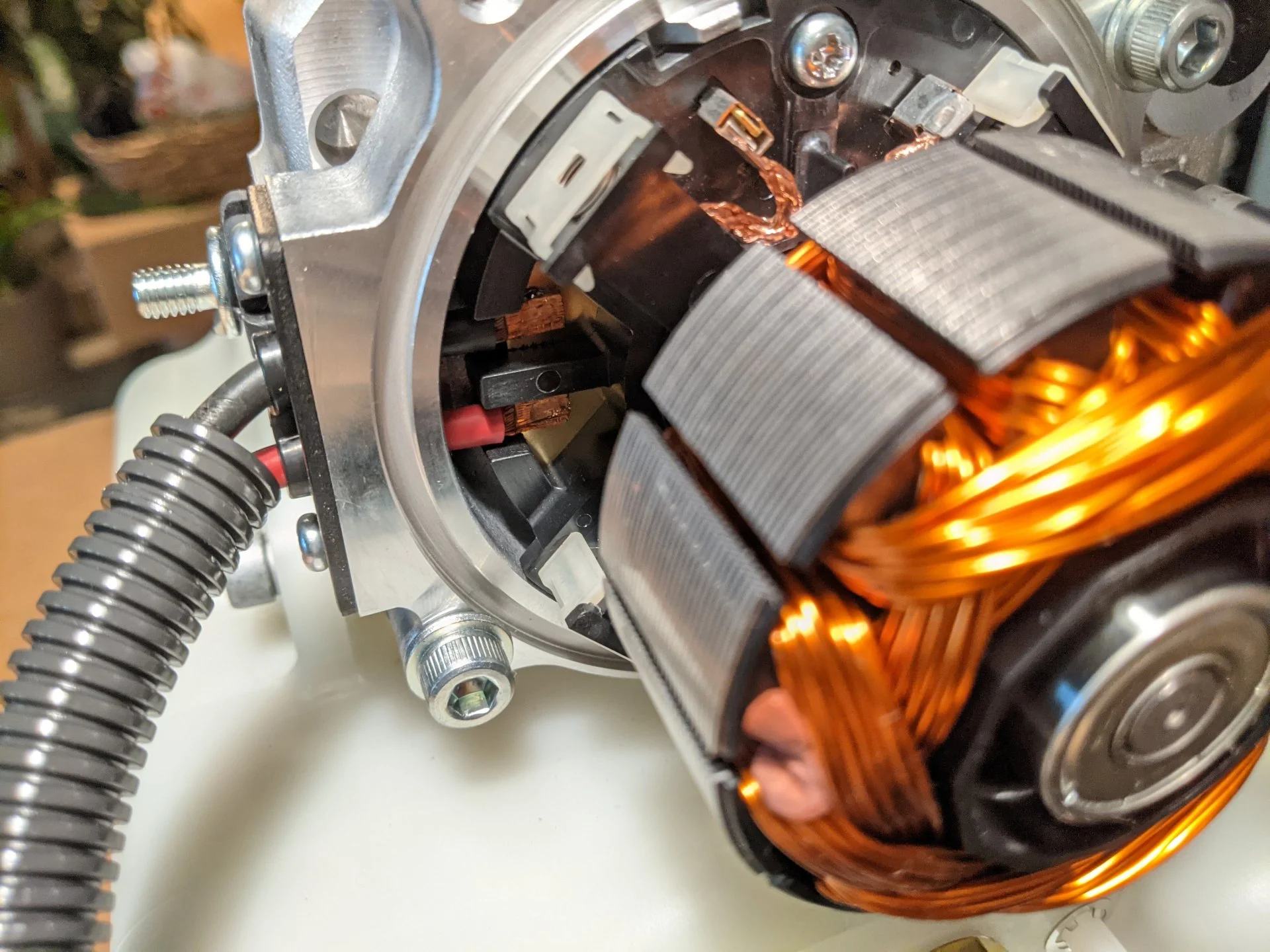

Stumbled on this thread that is a few years old. It has pictures of the filters removed from the pump housing. Sounds like the OP destroyed the filter trying to remove. So i guess if you don't have replacements, i wouldn't try removing.
Yep, Zel and I have quite the DM history! There's a huge AHC thread on a Russian forum with a lot of diy repairs to various parts of the system.
The 100 series pump head can be ordered separately and it comes with the filters, so that might be a route to go in repairing a 200 series pump head instead of a full assembly swap.

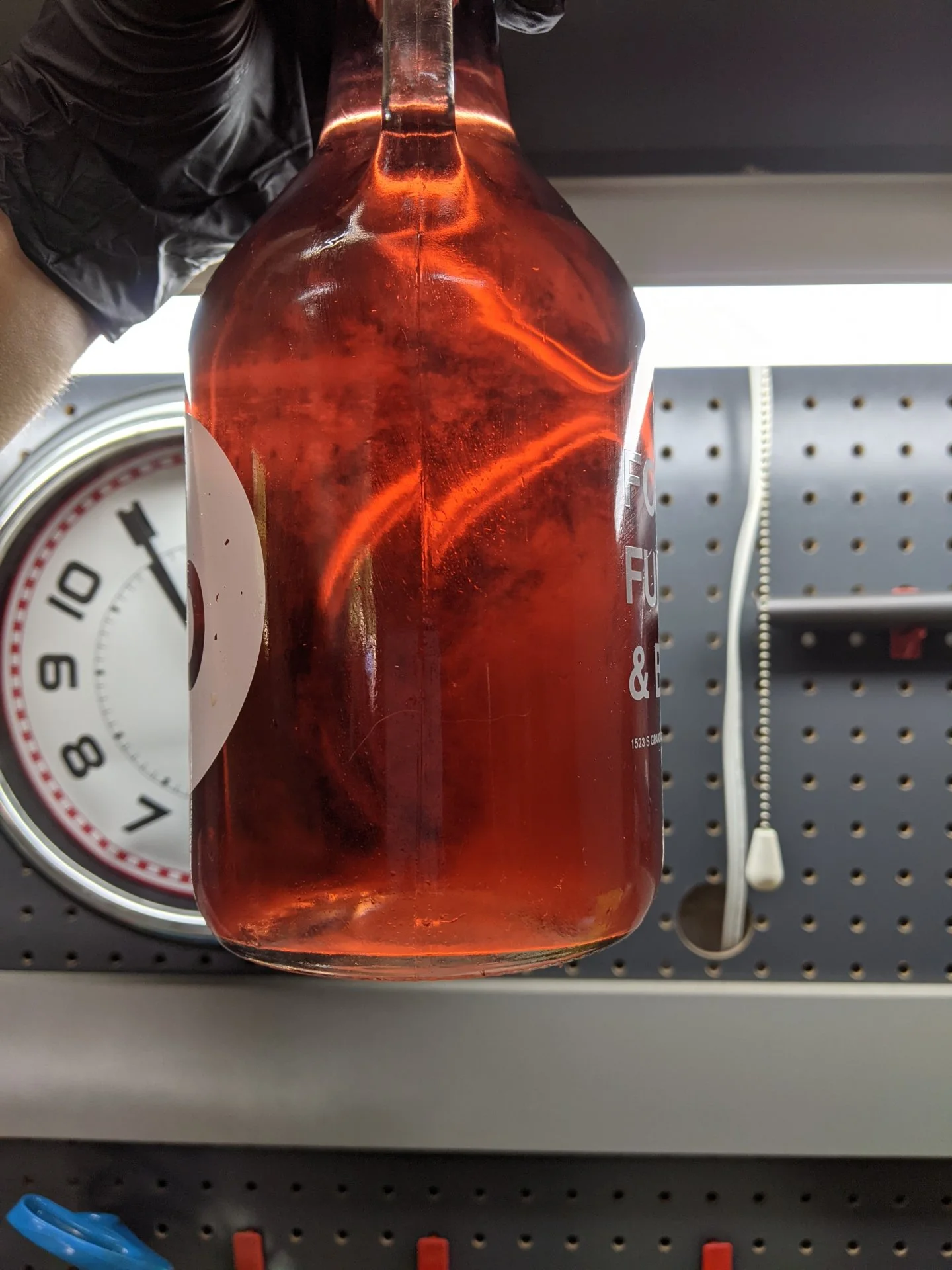

As kind of an update here, I am working with a local dealer in assessing if the AHC fluid was to blame. Two of my bottles have a haze or a cloudiness when I put it into glass to check. The sludge found on the filter screens aligns with what I'm seeing in the glass.

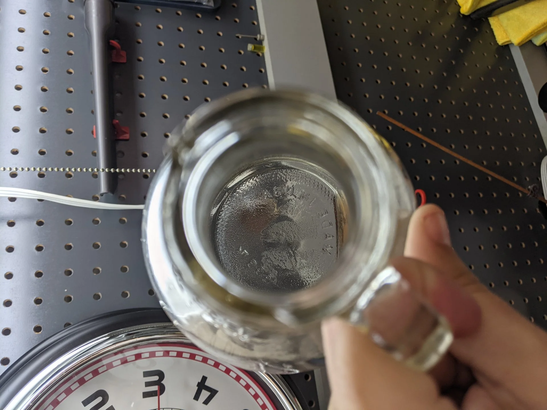

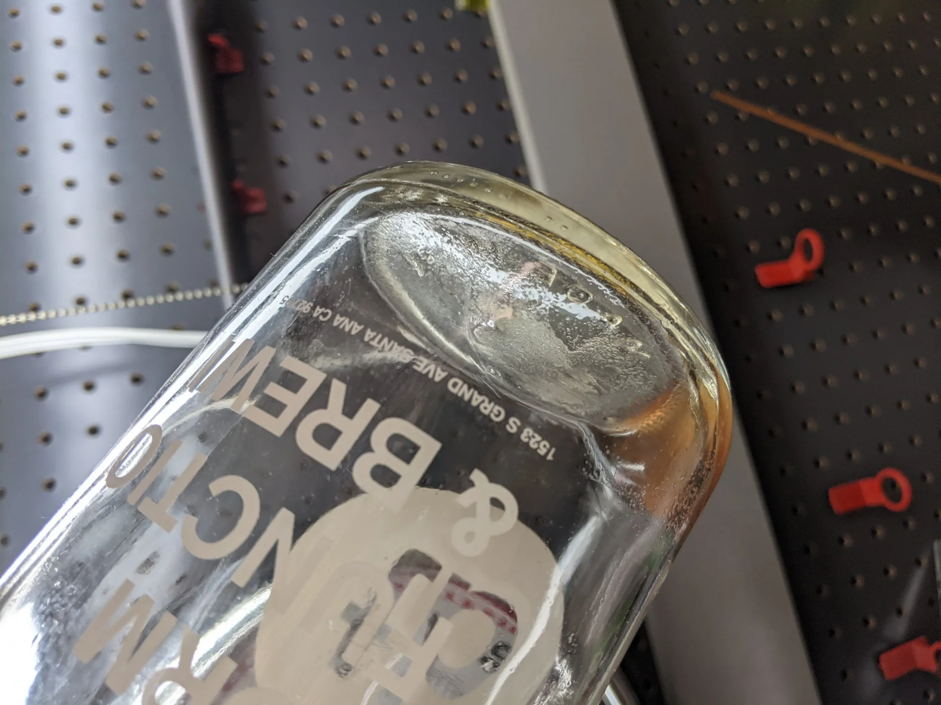

Here's what 2/5 of my bottles looked like, and what I've been discussing with a local dealer. If I had more time I would've purchased a 100 series pump head and swapped the filters, but life has been a bit crazy with a babe on the way and buying a second home. Wanted a quick swap, but I do think a lot has been learned about the whole system and how robust/easy to work on it is.
There has been a lengthy chat with some guys here held in private as well and want to shoutout @TeCKis300 @grinchy @tincan45 @Zel for being awesome.
On to the photos of the separate bottles in some blank glass I had:
That fluid sure looks suspect!%# I hate if that's what caused you all this grief.
I can't say I've ever noticed anything but a clear crisp coloration to the AHC fluid I've used before. Definitely didn't notice any cloudy quality like you're showing. I wonder if fluid sales are still on hold from the other thread and this is related?

Yeah, like I said I got in contact with Longo in El Monte - no service advisories or bulletins for our region. I filtered fresh bottles through fine stainless mesh as a precaution. I'm going to chat with them and email corporate this upcoming week.
Happen to get a shot of the filter after running the fluid through? Any thoughts on what the haze was? Was there anything left behind in the filter?
The filter had a bit of a clear-ish grit that is slightly gummy - although it could be the fluid itself giving that quality. I believe it kinda shows on the videos I took initially of cleaning the filters.
If I were to compare it to something - I'd say plasticizer if anyone has worked with sub-par tubing.

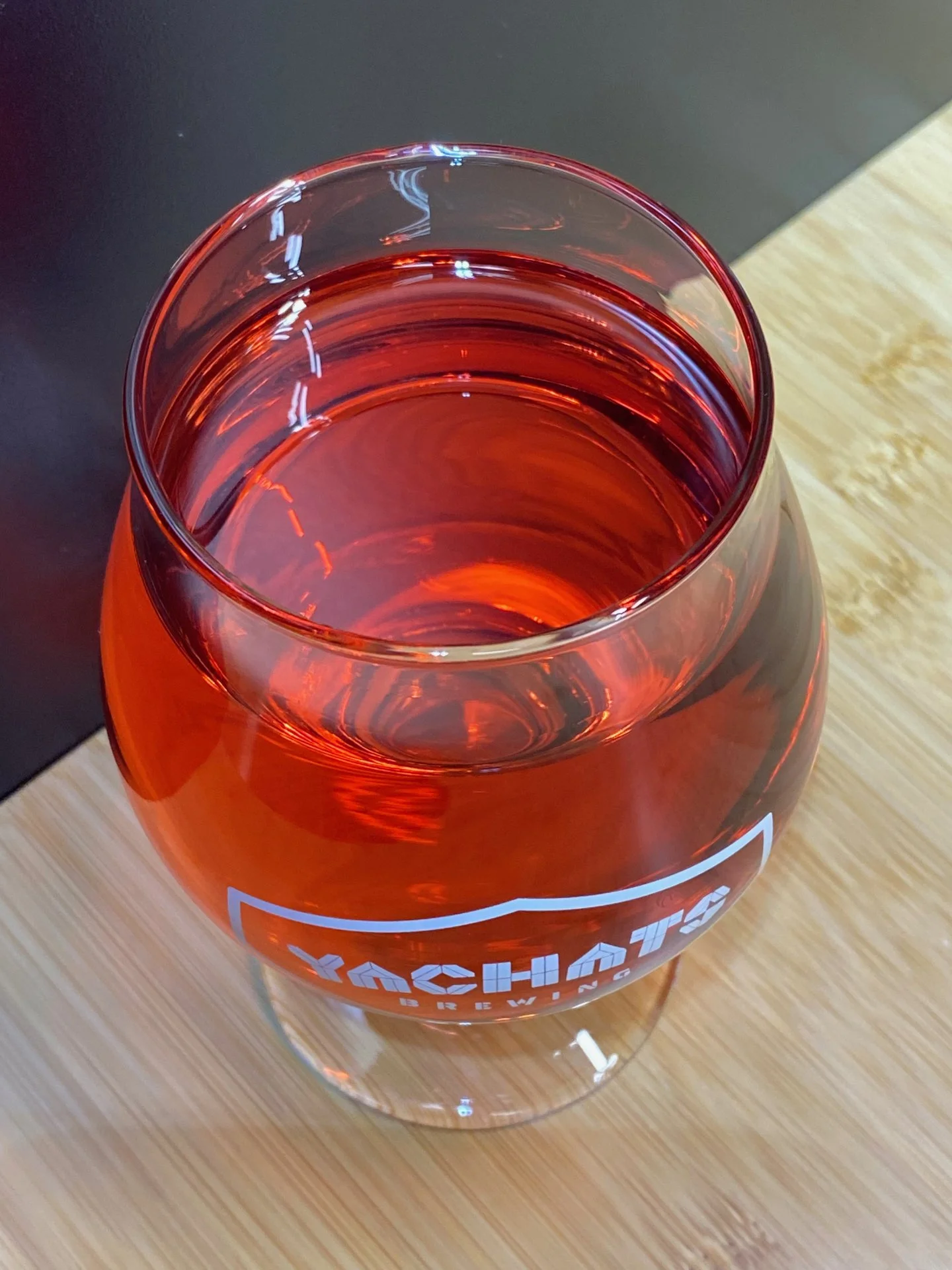

I recently bought some fluid to do a flush but am now too scared to use it, so here’s what it looks like:
Doesn't appear to be hazy like what @chalice posted above. This fluid was bought from Toyota dealer in NC in June, 2021. Date on attached label says 09/18/2020, but I'm not sure if that's when it was shipped to dealer, or closer to when it was manufactured at Idemitsu Kosan in Japan.

I’d use that. Proceed!

As mentioned above, that fluid looks great!

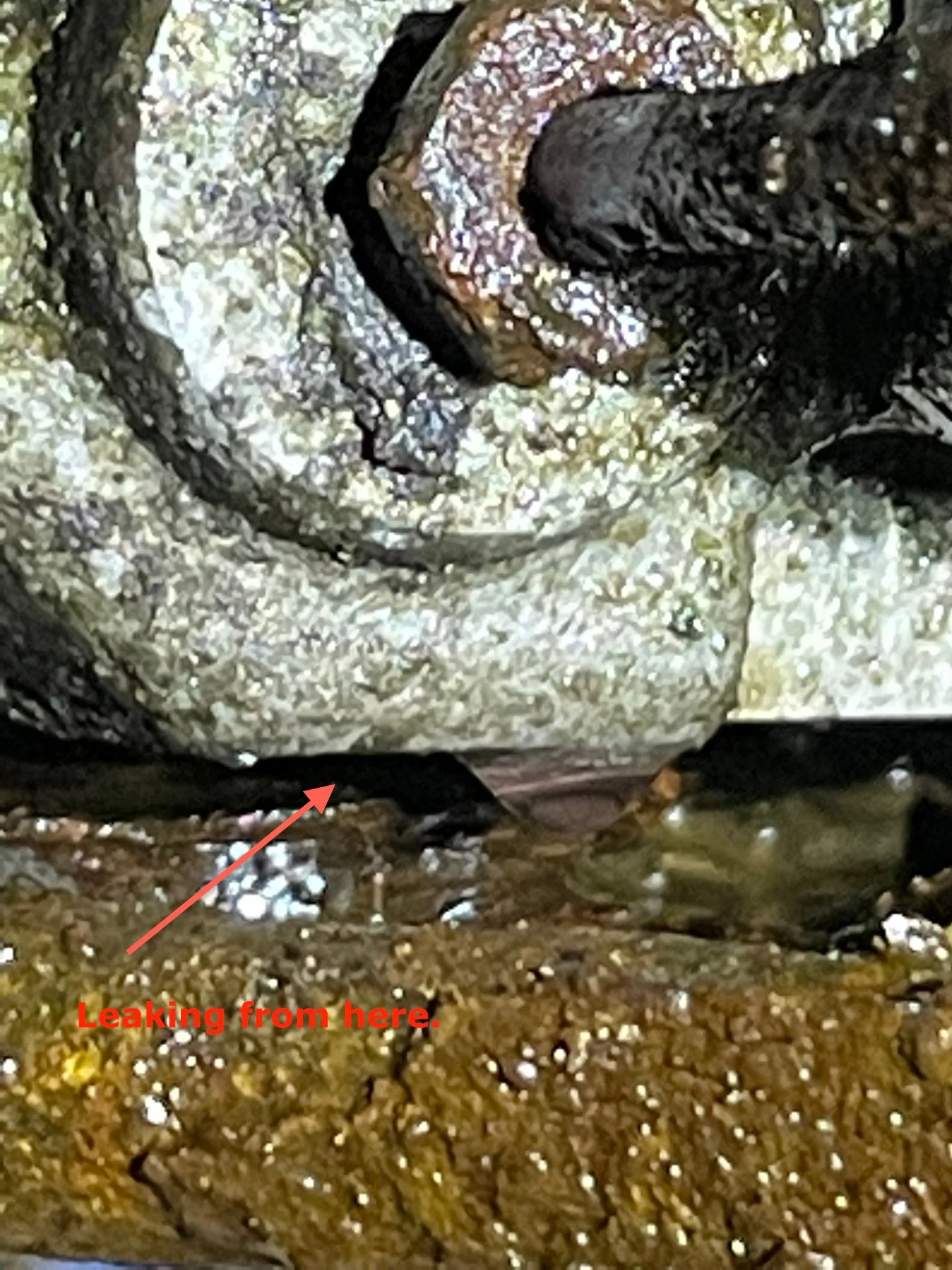

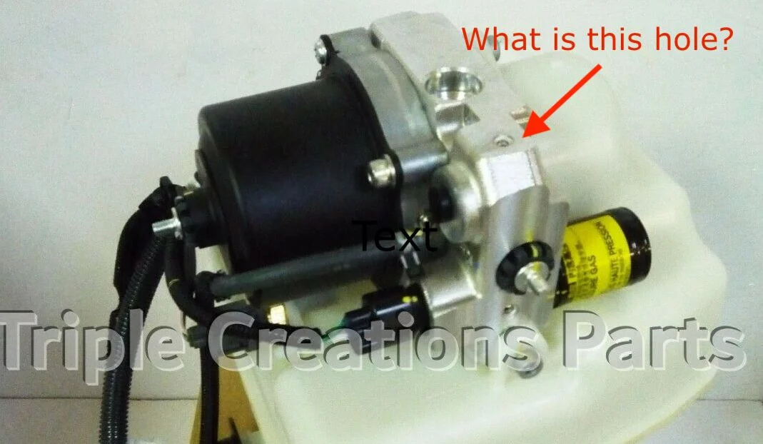

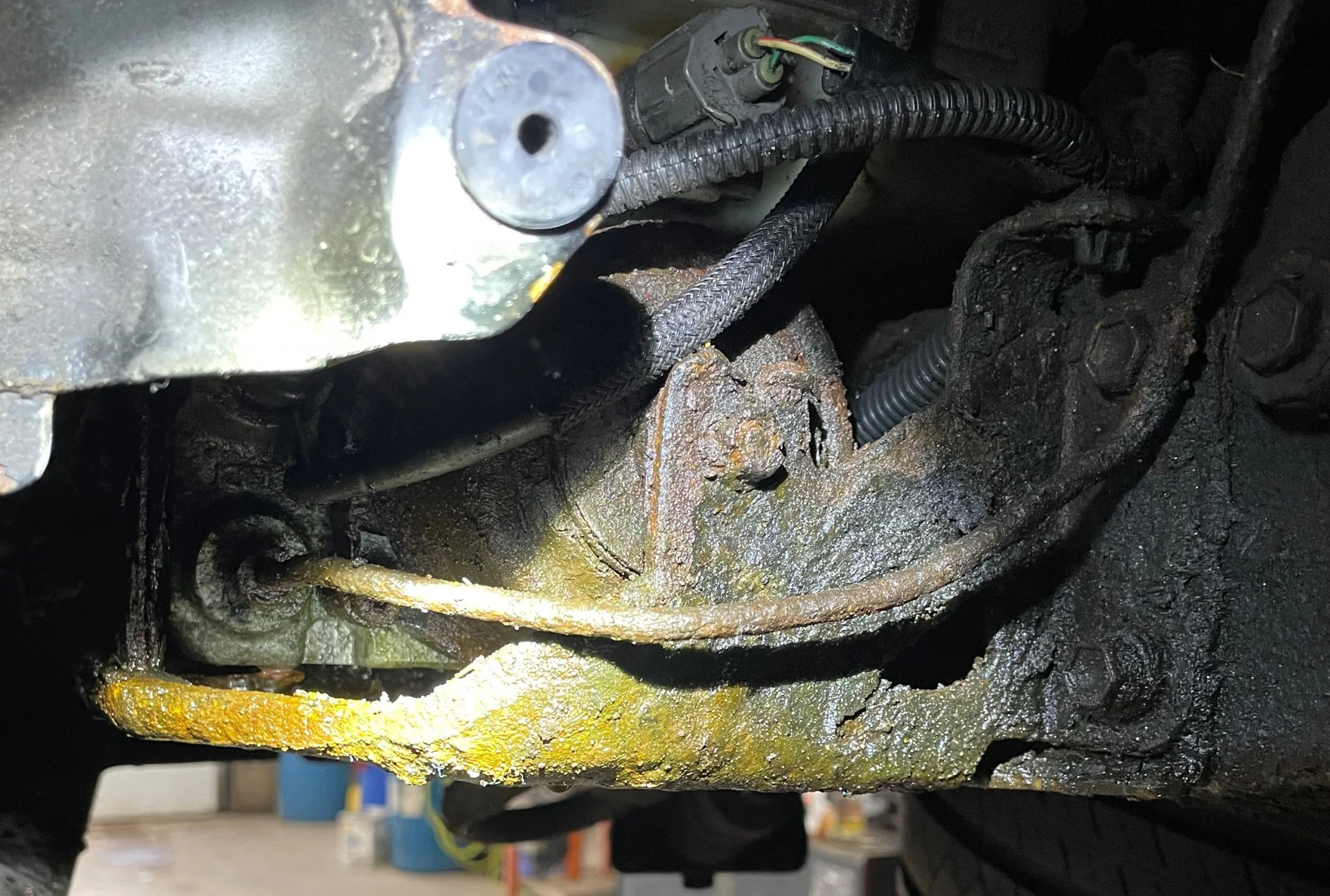

My pump is leaking from a hole in the pump housing almost directly below the pressure / return line. I think the hole is part of the pump, but guessing the rubbers, or seals are compromised, which is why it is leaking there. Can you help or add any info. Anybody replaced, seals, or made new ones? Rebuild kit, or just replace pump?
I called local Lexus dealer here in Canada today. $4000 plus plus tax. for the AHC Height Control pump and reservoir. lol
