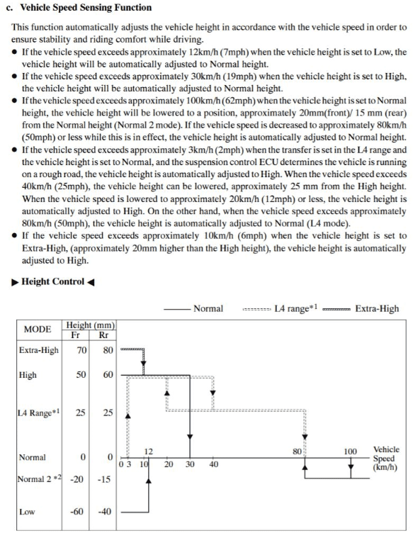

I'm sad to hear sensor lift didn't work out for you. It is strange that you see issues at positions both higher and lower. Is your AHC fluid refreshed? What year and KM on your rig? How many previous owners? Have you looked at the lexus site to obtain previous service information by VIN?
@NL4x4 How much of a lift did you dial in? I'll say I'm a bit surprised by how much you describe the ride to change. Is your 200-series a Land Cruiser or LX? Diesel?
I did a mild 3/4"F and 1/2" lift with mine and it still rides silky. Granted I also put spacers in my front and rear shocks, OEM front spacer, and 20mm rear spacer.
I'm a little surprised AHC rides that much stiffer with a mild lift. I say this because off-road, in low range, AHC lifts upwards of 2", and it seemingly maintains a plush ride quality. A mild sensor lift within that height should be somewhat the same? Maybe you can run around a bit in low range high and see if that preserves a good ride or it's immediately stiffer?
It is possible what you say is true in that the system assumes at neutral height, that a certain significant percentage of weight is carried by the springs. So it defaults to a certain valving. By sensor lifting, it logical that AHC is carrying more weight. With more AHC influence, by keeping the same valving, it would inherently mean more damping - i.e. sport feel as you suggests. Whereas when using "H" mode, the system knows AHC is carrying more of the weight and choosing lighter damper valving. Yet the whole system should have accelerometer feedback loops to tailor behavior to some degree but maybe not enough.

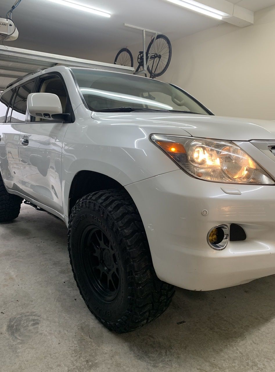

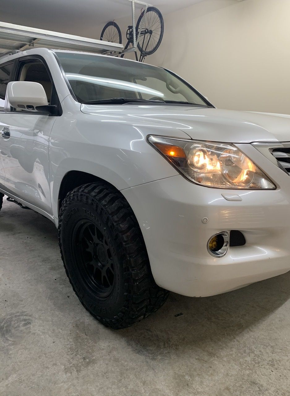

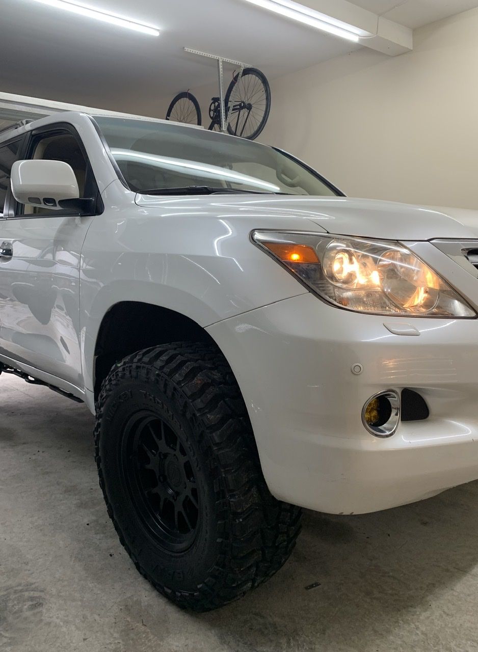

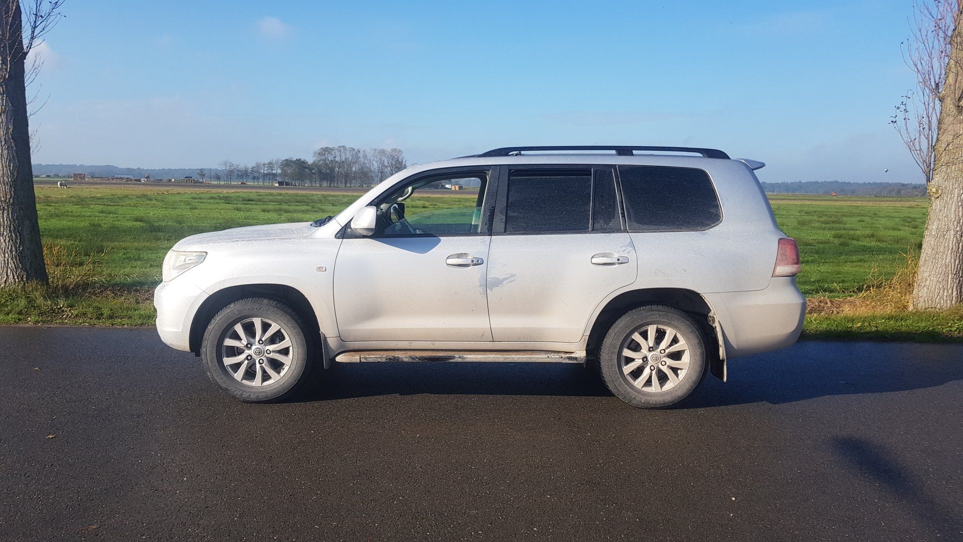

A previous owner had already replaced the shocks.
As mentioned before, the rear left sensor was all the way down, the rear right was all the way up.
before i started all this i've never noticed any tilt from side to side, and of course never paid any attention.
I always felt like the left rear was a bit harsh.
So as seen on the pictures my guess is somebody fooled around with it some time, and tried to fix it by lowering one sensor to the bottom and the other to the top.
I added some numbers, like 20mm and 10mm,, than 40 and 20. And what do you know, it lifted the left side even more instead of lowered so i added a higher number first and a lower number after, and its now about the same value left and right with the sensors both in the middle of its capability.
I drove of a speed bump and that is allready way better than it was before so now i'm really excited to try to lift it again and see if it will be a bit smoother.
We'll see tomorow.
Again, thanks for thinking along with me :)
Update.
Couldn't wait till tomorrow :p
I tried a few things this evening, my guess is that the rear was lifted by somebody before and they scr*wed it up or somerhing and corrected it back with the sensor position, i have no idea really.
I tried to level it and turned out really good in such a short time and in the dark.
I tried a bumpy farmers road on different heights and it does drive better on all positions so we have gained a lot today!
No rear left harsh feeling what so ever :D
A gravel (!) Rock/dirt farmers road like this i hardly ever drive on on normal circumstances ( Unfortunately lol )
I always felt cornering right was firm and turning left had more body role, probably has something to do with this also.
But, only when noticing, not like it was annoying or anything like that, lots of cars have that.
The fact remains that when i lift it in techstream, the ride gets rougher, lower it again and it's better again.
I also learned that the rear needs to be a bit hinger to drive perfect. Front and rear level looks good also but i would choose the rear a small bit higher.
10mm lift makes a lot of difference in the drive, up or down

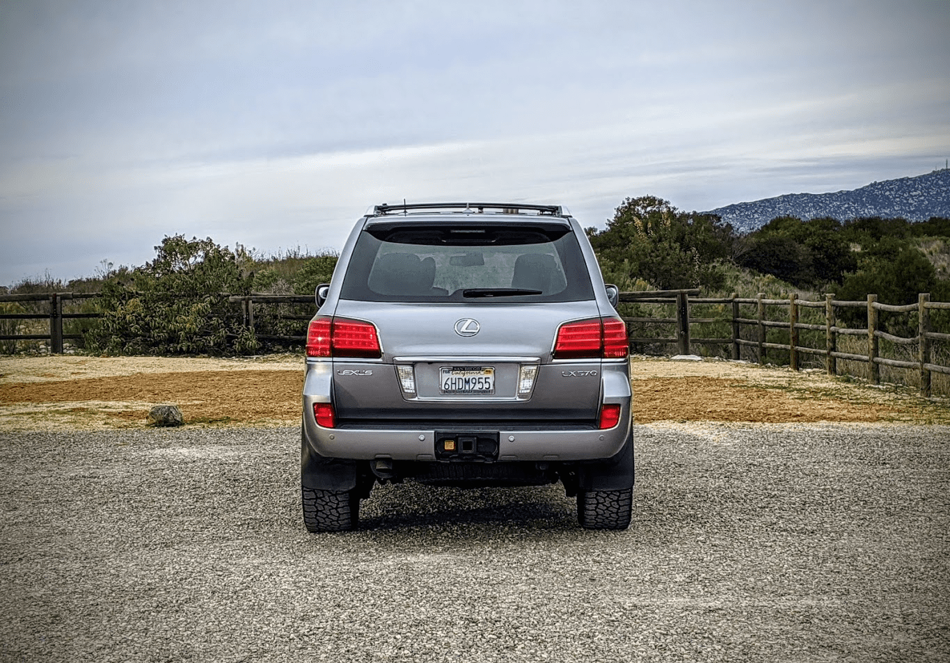

From my sensor lift post, here's the heights before and after the lift
Succumbed to the voices in my head telling me to lift. Or was it all y'all?
Did a mild sensor lift. Paired with install of an OEM front leveling spacer to make sure I can maintain payload capacity to tow heavy. Along with existing 20mm spring spacers at the rear.
EDIT: spacer part number - 43136-60020
I opted for a mild lift so I didn't max my adjusters. Increase of .75" front and .5" rear was the target. To remove a tad of rake. Balance to maintain as good of suspension geometry as possible as I do enjoy driving hard on tarmac, while getting a bit more obstacle clearing lift.

Curious now that you have the ride setup nicely at normal height. What's the ride like in H?
What i've found out is that, when on the new higher neutral position, the small bumbs are not comfortable because the load is carried with the ahc system instead of combined with springs, but the flex is still good when driving slow, like it's opening a valve automaticly on a certain height same as high mode (!?), because when i drive over speed bumps when setting the new neutral on a heigher position, it keeps bouncing 2 times after the speedbump, i tried every posible position to minimize this, i could bring the rear a bit higher but i don't like that look.
In high mode it was always less confortable.
Its a 2008 model nearly 350k kmers so perhaps they changed a few things over the years, for example the oem coil spacers.
I prefer a smooth ride over looks and i still have the ability to press the heigh button whenever i need it or want to make a picture :D
Yeah that’s the thing. I can get it to read anything I want, but the FL is 10cm lower than the right no matter what It says. Even after sensor “balancing”.
