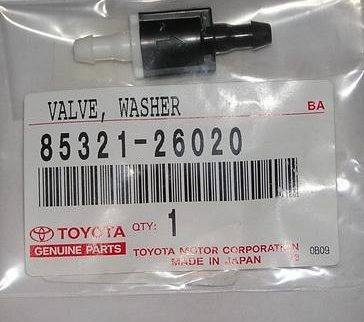

I think the best way to upgrade the nozzles is to use Dorman 47137. These are spray type nozzles (like modern OEM), adjustable.
Dorman Products - 47137

They don't have an internal check valve, so you would need to buy one. Toyota part#: 85321-26020, it costs a buck at ur dealership.
A lot of members of Russian LC100 community have done this mod and they report outstanding results. This set up works for them even below 0 degrees F.
What does the internal check valve do?
Keeps the water from eventually flowing back down the line. Basically without it when you pull the lever and havent used the washers in a while it takes a minute for the system to build pressure and spray. This keeps the fluid in the line because it is directional flow only.
