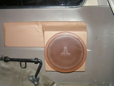

Yep, I just finished a custom 10" sub install a few weeks ago. I'm really happy with the way it sounds. I used plenty-o-dynamat to eliminate any possible resonance issues.
https://forum.ih8mud.com/attachment.php?attachmentid=72176&d=1146884288
I'm not sure how to direct you to it, but search this forum for "subwoofer" for my original post about it.
