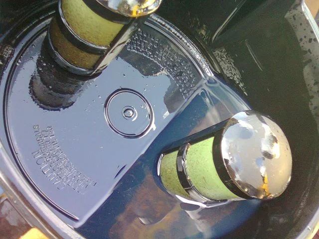

We've moved from Guatemala to Sierra Leone and brought our trusty BJ60 with us. When we arrived back in January all I had to drive was a Ford F350 with a 5.4L gas engine. We had numerous problems which we finally traced to abnormally dirty fuel. It ended up needing to change the fuel pump after pulling the tank back in March to clean the pebbles and rocks out of the fuel tank and pump. Of course I was concerned about the diesel quality with the LandCruiser on the way.
Thanks to Rob I have a Mr. Funnel filter funnel to clean my fuel. Attached is a photo of the filter after just 5 gallons of diesel passed through it. This is diesel that came out of a jerry can that has not been used in Africa before so this is just dirt from the 5 gallons.
I'm not surprised about the problems folks have with vehicles here. I'm only surprised that no one else has figured out it's the fuel. I'm the only one filtering fuel and everyone comes looking to see what the weird contraption is that I'm using. I even had one gas station attendant refuse to fill the Ford when I wanted to use it because "it was too strainful"!
I'll take another picture this weekend when I fill up with 30-40 gallons and see how it looks.
Charles,
Glad to see that you made it safe and sound. Question, what is the diameter of the funnel? Also does yours have two filters in it or just one? How much time does it take to fill up a tank with the funnel vs. w/o the funnel. Last, how do you clean the filters or do you simply replace them and if so, how often do they have to be replaced? Thanks.
John
John, the funnel is probably 10 - 12" diameter, has two filters and these filters are teflon coated so if necessary you could rinse them but the dirt falls off anyways. The filters are NOT replaceable. It takes a little longer but it is really dependent on the cleanliness of the fuel. We have one jerry can that has been in use here for a while and it's all slimy inside so the fuel in there takes a while to pass through the filter. Cleanish fuel at the gas station should be better, I'll find out this weekend for sure.

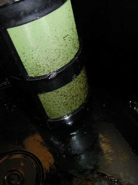

Mr. Funnel also filters out water believe it or not! I'm planning to make sure as little dirt or water as possible makes it into the tank. I figure if I can keep it out of the tank that's 99% of the battle.

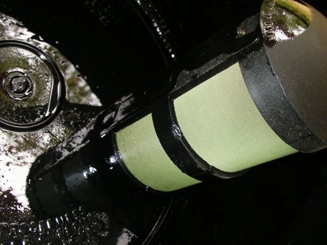

Well I filled up with 25 gallons at the local station out here where we are stationed. I used the Mr. Funnel and it stopped flowing at 20 gallons due to water and dirt on the filter (see first picture and the dirty water in the bottom that the filter funnel caught).
After the full complement of 25 gallons I took a couple of other photos of the filter.
All I can say is I'm glad the dirt is NOT in my tank or worse in the engine and injection pump!
