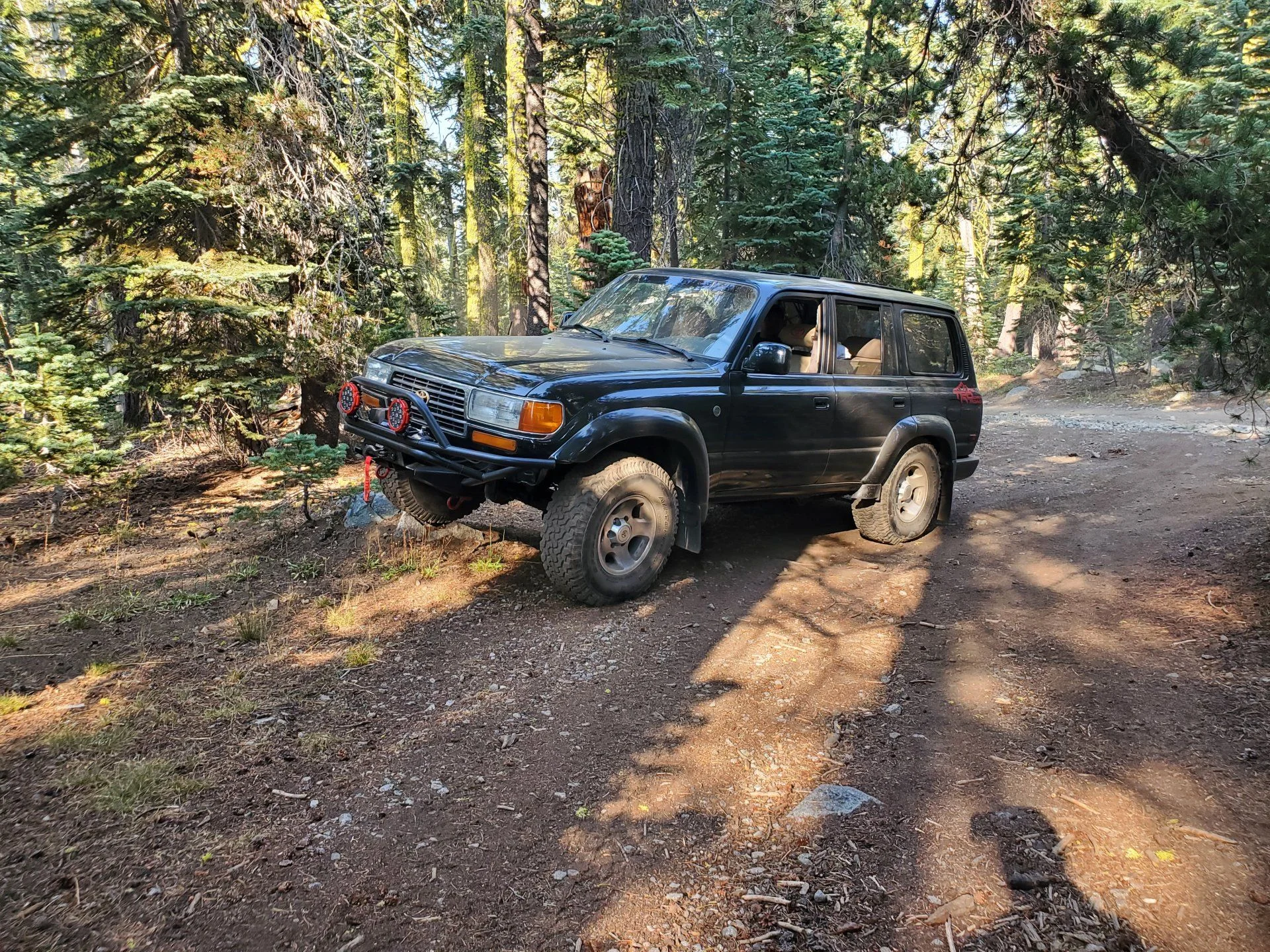

Hey guys, looking to start really upgrading my 96 and I'm looking for a good lift kit. Currently have a trail gear front bumper, smitty built XRC 9500 winch, and 33 BFG ATs. I just moved to colorado and im going to be doing a lot of overlanding this summer. I also plan on doing a lot of road tripping so I don't want to go too big,, im thinking 2". I will definitely be putting a rack/ light weight roof top tent at some point along with a rear swing out bumper so I will be adding weight. Again, I'm not looking to go too big as this is my everyday driver. Biggest tire size I'll do is probably 35s maybe 37s. What do you guys think? Thanks for the advice

Given your pic I am going to assume you have been wheeling your current set up and are determined to upgrade. For what it's worth I would put rock sliders and some skid pans on that truck before I looked at a lift. It's amazing how much more you will try with smaller tires when you are confident that the dragging of the under body isn't going to hurt anything. Add your rear bumper before the lift too, not so much to know the weight, more to see if you're happy with the tire/lift size you already have knowing you have some additional protection. If you get all that on and are still not happy then go for the lift. Anything under 3" will help with the road manners but you may still need to add things like adjustable pan hard rods or brackets and fixes for the front caster. I am happy with my ICON lift and recently helped a buddy install a Dobinsons 2.5" kit which seemed very nice and he is happy with.
