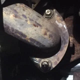

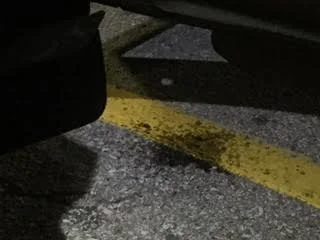

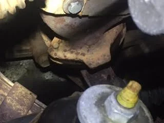

After several mechanic shops and many tests including a leak down test it was decided that the head gasket was blown between cylinders 1-2. So off it went and my pockets went empty. I just got the truck back several days ago and it was driving fine around town at 45-50mph then yesterday I went to get my emissions test and it Past then decided to test it on the interstate at 65-70mph filled the tank with 87 before I got on the road and was at 65mph for about 5 mins before I lost power with pedal to the floor could not get above 40mph and a slight shake came back with a burnt smell. I made it off the road and saw the puddle of what smelled like and felt like gas and oil colored black dripping from the rear exhaust manifold flange (PICS ATTACHED) so I had it towed. WHAT should I do I am burnt out, this has been an ongoing battle I feel like I cant win especially financially. I will bring it back to the shop that did the head gasket set, the work is under warranty ( Could this have been caused by putting in a new head gasket set and replacing several retainers?) . From what I can find online the most likely parts causing these problems are a leaking fuel injector, a fuel regulator that's stuck closed, or a restricted fuel return line. What would you do in this situation I would appreciate advice. Has anyone been in this situation?

Did you figure out where the dripping was coming from?
It only drips out the manifold flange when the engine is running then stops dripping when the engine is cut off. I cant tell where its coming from Im guessing an injector? For some reason this truck keeps over fueling.

My guess is ur fuel pressure is to rich due to the power issue and the fouling after changing the plugs. Most likely a bad fuel pressure pulsation damper maybe a fuel pressure regulator.
While idling, look for the fuel leak by the fuel pressure Pulsation damper, Its on the back side of the fuel rail above the exaust manifold.

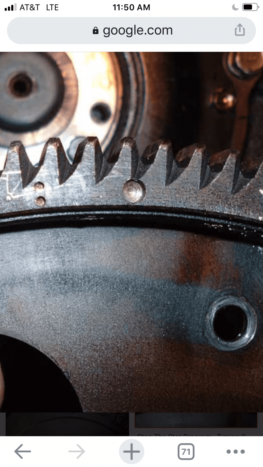

I forgot to mention I was having the same symthoms ur having with acceleration when my timing was not right at 7 degrees (Minus the Gas leak). Make sure ur setting it to the big drilled out mark and not the two small holes close together (TDC) or the big hole that you can easily see (my original mistake) if ur not contorted.
