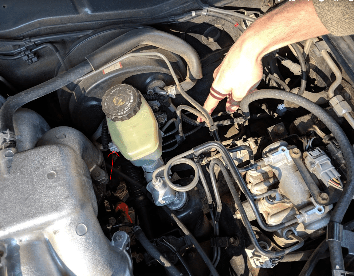

Mine is hooked up to the brake fluid reservoir. This is for something else I think.The 4 conductor plug you have unplugged looks like it goes to the brake fluid level sensor. Small red arrow on mine.
