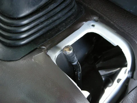

On the first day i initially drove the car, once i got home i figured i'd go for a play on frozen, snow-covered fields next door. In four-wheel-drive, of course. I figured i'd check out the low-range, but was unable to get the transfer case in low-range; i attempted shifting it perhaps twenty times, without success, and finally the transfer case lever came off in my hand. I'm not kidding.
The steel of the transfer lever shaft looked exactly as if it had been cut, with a powered tool (portable band saw?), as the heat marks showed. As well, it looked as if it had nearly micoscopic spits of welding metal on its circumference. Not enough, and not good.
