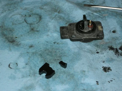

I spent the last three days fiddling with my car, with professional help. A few things were done: the oil pan was modified to prevent the electric-diff-lock mechanism's protector plate from bashing into it. I could have had a new pan (correct for my pre-1990 axles) installed, but didn't as i had already bought a new one (as mentioned a few posts back) and didn't feel like buying another; as well, there was also an important modification done to the existing one, the addition of an oil return pipe from the turbo, which i remembered to photograph for a change.
When the oil pan was removed, a small, perfectly circular pile of silicone was waiting for us at the bottom of it, giving away the location of the oil pick-up screen; a lot more silicone was used than was needed. Nice to know the engine will no longer be in danger of oil starvation. I forget the exact number of bolts there are to hold the oil pan on (16? 18?), but there are also three nuts that fit on studs to go with the bolts; the paired nuts, at the rear of the pan, were not even hand tight.
The 1HZ in my troopie came from an '05 or '06 HZJ77, according to Crushers, which is a model that had an oil-level sensor in the pan; that's the purpose of the hole in the side that can be seen in the first picture. That item was incomplete on my pan, and in the fourth picture are two pieces of that sensor that were found broken off, and having an easy life of doing didley; the larger bit in the same picture is the inside of the sensor's mount, with the sensor bits removed (it wasn't wired in and so had no real purpose any longer). The front bump stops were replaced by items that are two inches longer, providing me with a little more piece of mind.
I found it interesting to discover that the oil pan is made of two steel stampings, with one fitting into the other (two welding passes were made for each of the interior and exterior of the pan, plus some type of sealant was applied, again both inside and outside). A good pal of mine, who is a seriously accomplished bike mechanic (he spent years on Japanese bikes) told me that Japanese bikes had doubled exhausts, in order to prevent blueing of the chrome; so the only reason or guess (thanks to Jake, the bike mechanic) i can think of for the existence of the doubled pan is heat-transfer prevention; if anyone knows any better, i am curious.
Five images are the limit per thread, so i'll go on to the next post.
troopiestuffagain 003.webp troopiestuffagain 006.webp troopiestuffagain 007.webp troopiestuffagain 008.webp troopiestuffagain 004.webp

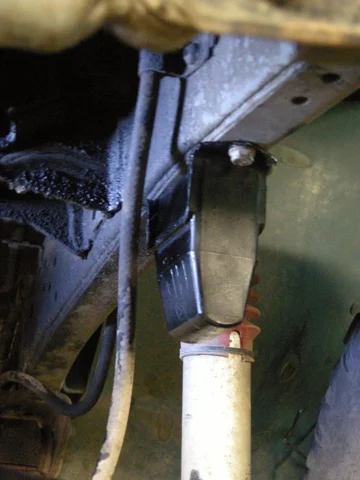

Here are shots of the finished oil pan back in its home, as well as the bent Slee protector plate. That plate was bent back to level after that shot was taken.
About five weeks ago, a significant oil leak developed. It turned out to be from the power steering pump housing (it is lubed by engine oil), as its bolts weren't tightened enough; a gap between it and the mating surface could be seen, too.
The air compressor on board was low on oil, too, so that was topped up (using 10W-30 engine oil, as per the manufacturer). It no longer bleeds air out so quickly once up to pressure.
