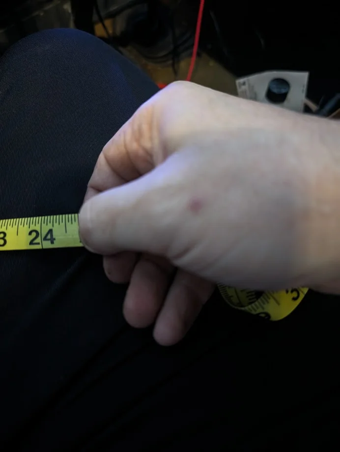

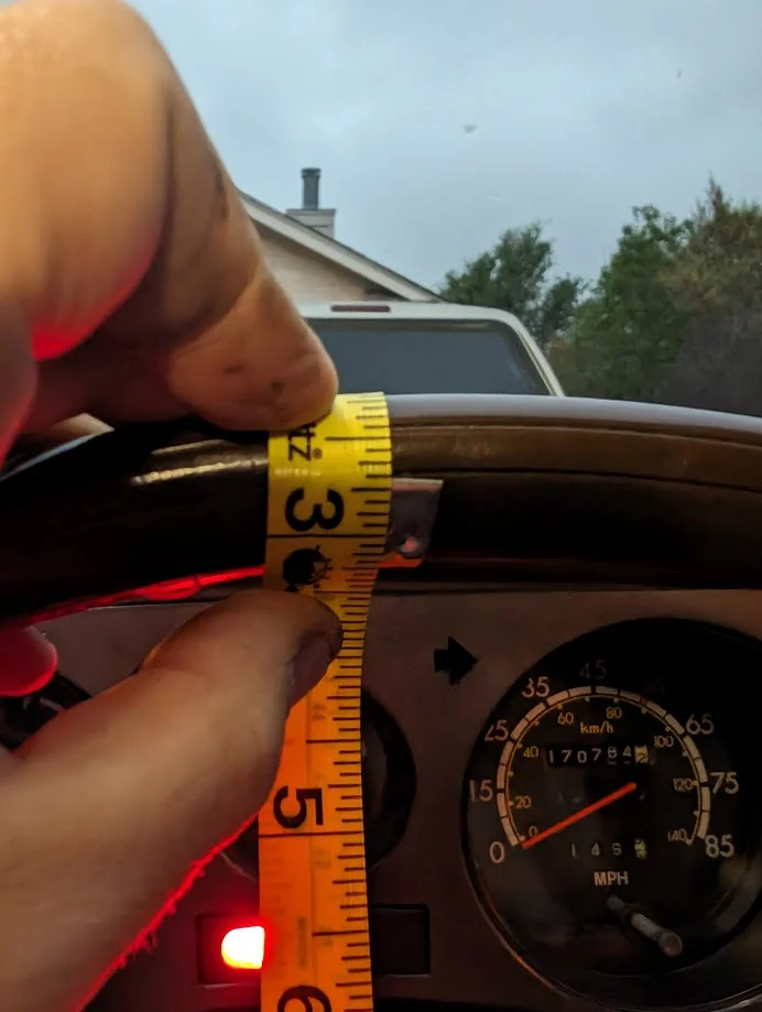

Wheel Grip curcumference: 2-11/16" (51.4875mm)

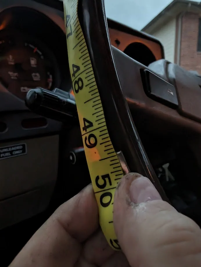

Complete wheel outer curcumference: 49-7/16" (1245.0375 mm)

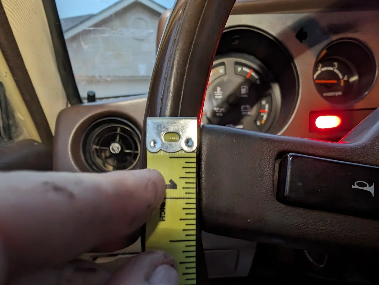

Side spoke width: Lots of parallax here so I'm going to call it 1-3/8" (34.9250mm)
A little extra is is okay.

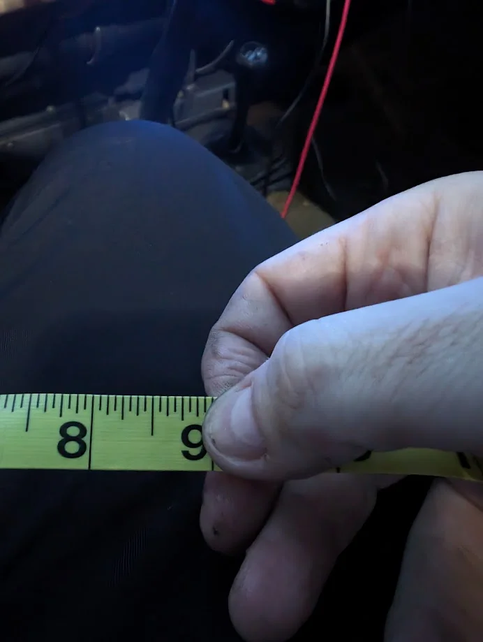

8-7/8" (225 mm)

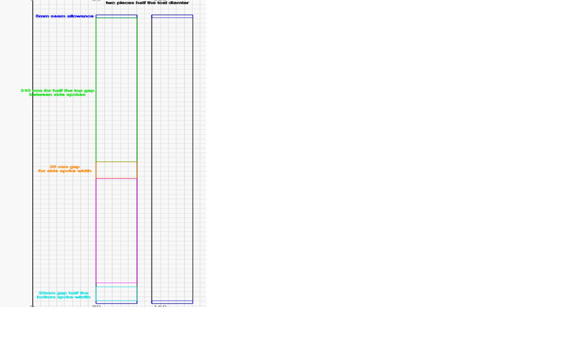

just because there is going to be a seam at the bottom anyway, and 49+ inches of leather has to come off a big piece of leather, I'm going to cut
2 pieces and stitch them together top and bottom, so I can get it from a smaller piece of leather.
To do this I need to add a seam allowance. I'm going to use a seam allowance of 1/4" or 6mm, since I'll be hand-stitching the one in this tutorial..
in that picture, the black shapes represent a piece of leather. the green represents stitching, and the part that is sticking up is how much extra leather I need to be able to stitch these pieces together and get the length of the resultant leather to be the desired length.
That's all seam allowance is.
Layout of the two pieces of leather, pre stretch.
So I'm going to draw up 2 rectangles using the following dimensions
Side spoke width: 1-3/8" (34.9250 mm)
Bottom spoke Width: 2-5/16" (58.7 mm) (round up to 60mm, halve for 30mm for gap at bottom of each strap
Inner radius between the side spokes and the bottom spoke: 8-7/8" (225 mm)
Inside curcumference, side spoke to side spoke around the top:24-3/8" (619 mm) (round up to 620mm, halve to 310mm for gap at top end of each strap)
if you add all these up, you wind up about 1cm shorter than the outside curcumference, which is roughly the difference between the inner and outer circumferences divided by two... this is the minimum possible stretch allowance, as we want the inside curcumference where the stitching occurs.
Here is my layout, it's hard to read because I just took it out of the laser tool and stretched it big enough to see
The other upside is, I only need a rectangle of leather 24-25" wide, which is a lot cheaper and easier on amazon than buying a bigger piece from a leather supplier.

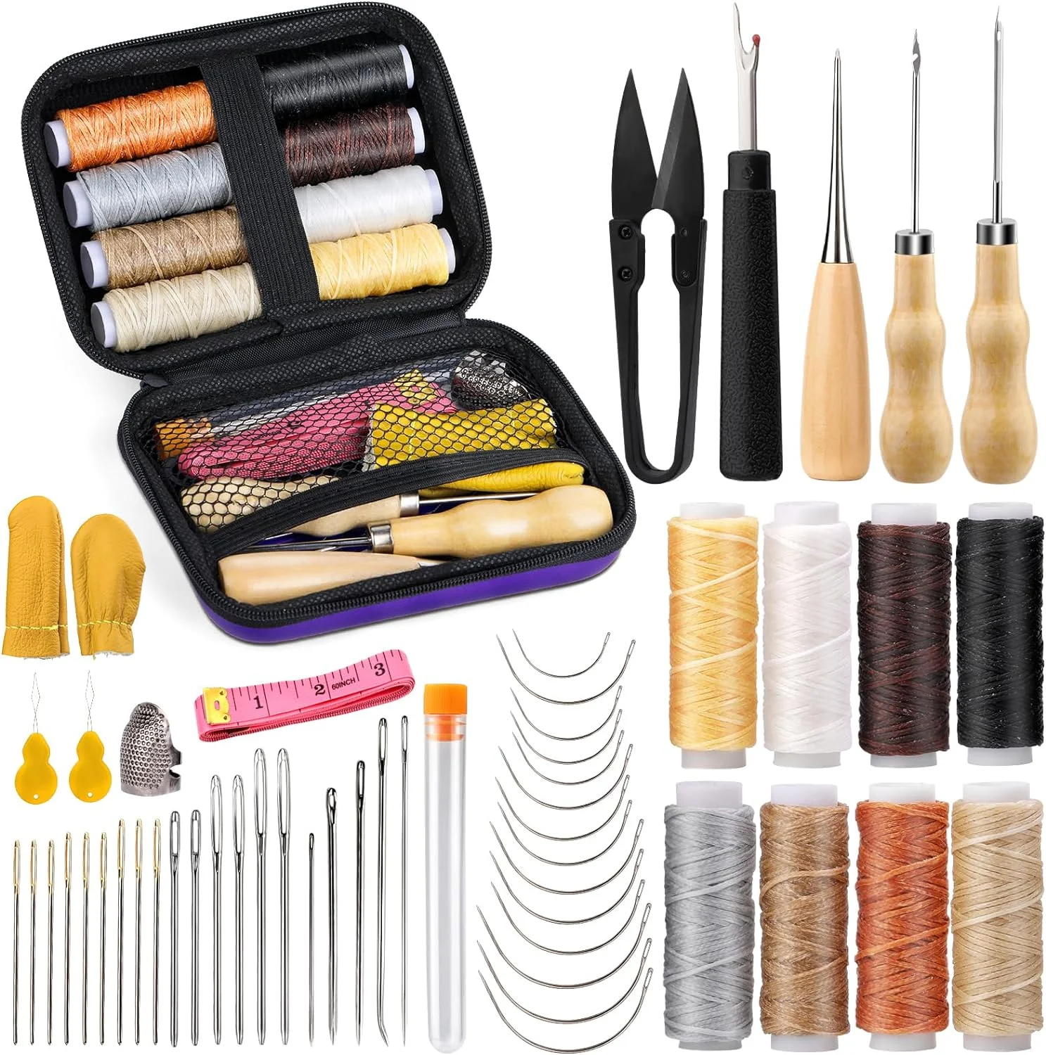

Tools:
Note: I'm trying to build the Tool Kit as cheaply as possible using Amazon. This means cheap Chinese tools. You can absoloutely get better, longer lasting American made tools.
Required:
$10 leather repair kit...
https://www.amazon.com/dp/B0C8N8NLQC?tag=ihco-20
2x24 piece of thin, stretchy leather from amazon, or wherever. (around $30) I'm going to use stuff I have around the house, so this is excluded from my budget. (Veg tan shrinks when exposied to heat and uses chemicals you can get from plants, Chrome Tan does not, and uses nasty chemicals, I would not eat either kind)
Example leather, close but not identical to mine
This includes all the basics to do this job, aside from these tools/materials, I assume you have access to:

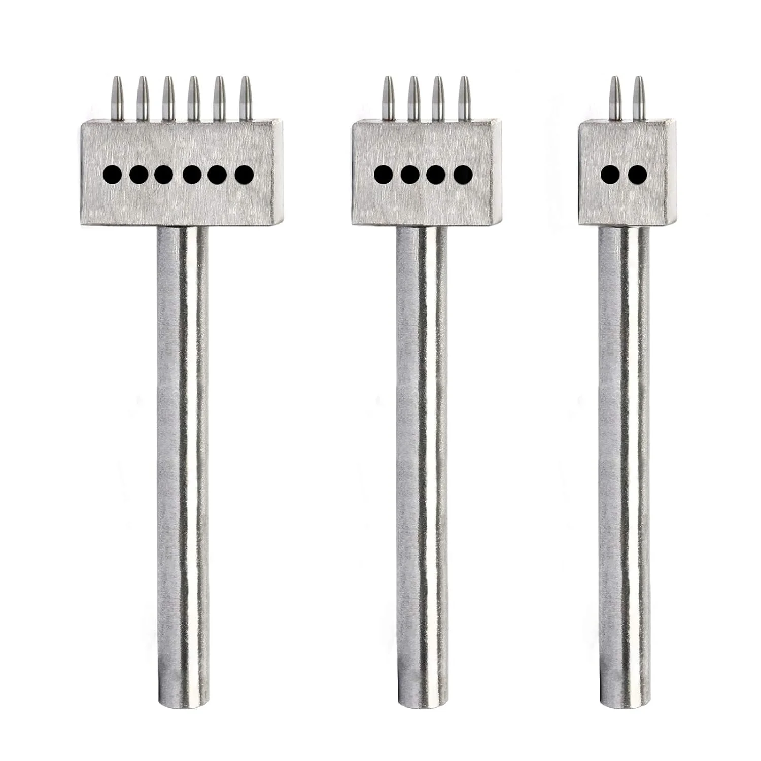

Hole punching chisels, I normally use smaller ones that just cut slits incited of holes, but this will make it easier to lace up later:
https://www.amazon.com/dp/B0BRBZV92S?tag=ihco-20

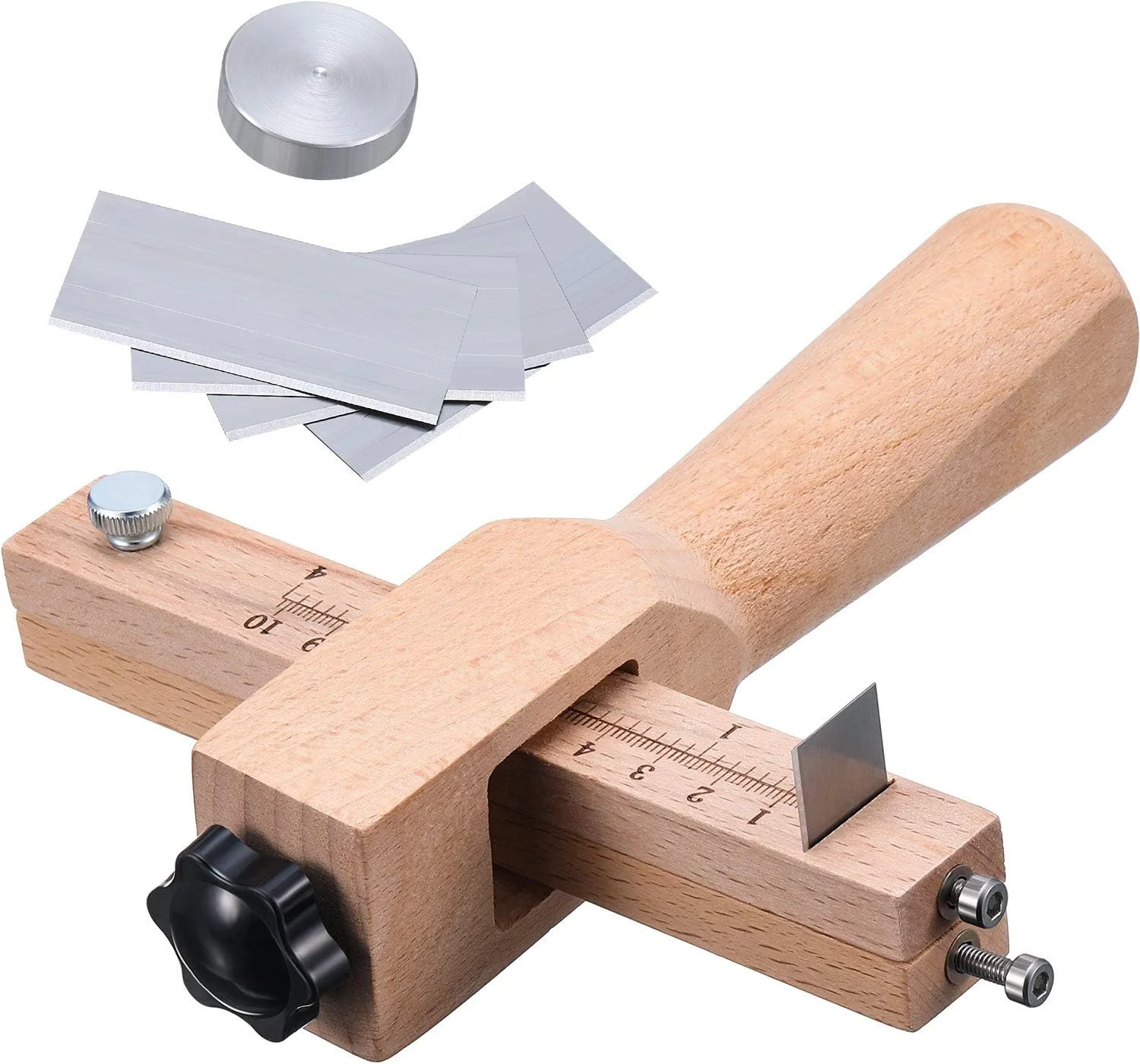

Cutting the Straps
1. Assemble and the strap cutter
2. Set the strap cutter cutting thickness to be as thin/tight as you can and have the leather slide easily...(This is critical for accurate cutting)
3. Set the strap cutter width for 1/8" (3mm) to 1/4" (6mm) less than the Grip Circumference of the wheel. (1/4" for leather stretch with my soft leathers, I used 49mm)
4. Carefully start the strap cutter till enough is cut and sticking out the back you can grip it.
5. Cut the rest. (going to film a video of steps 2-6.)
6. Repeat if you are making a two piece wheel cover as I am.

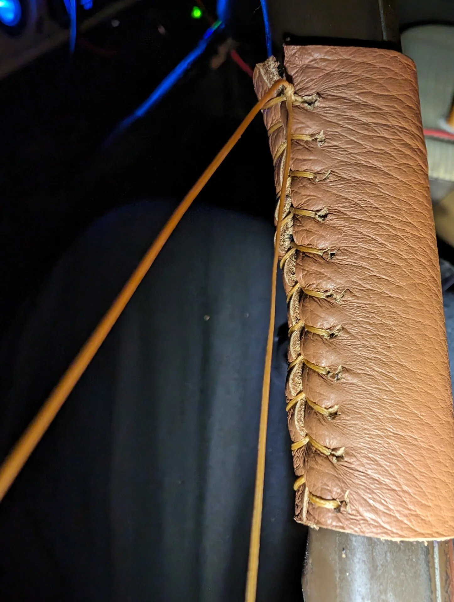

In case anyone cares, Here's how to stitch the ends of the pieces together to make a ring.
Here's how to stitch it to a wheel.
With those two pieces of information and the bits above, there is enough to figure it out for yourself.

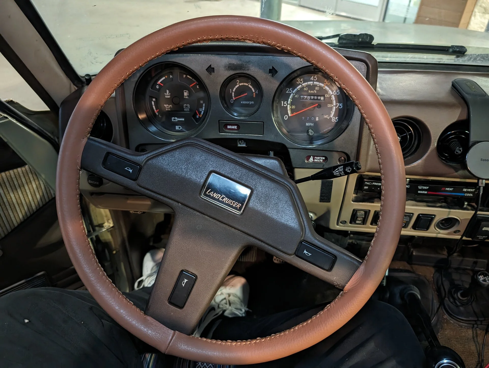

Here is what it looked like when done, since I picked the leather, it's soft and butter smooth
