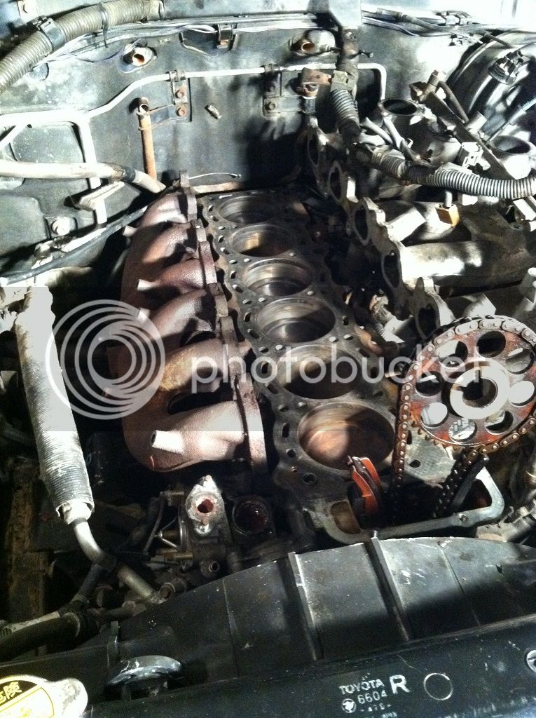

Oh so the head's not even on? That's easy. Just turn the crank bolt until it's at 0º on the timing mark and piston #1 as at TDC.

Good to hear! When turning the crank make sure you lift up on the chain/sprocket to keep tension on the chain so it won't fall off the teeth at the bottom or get bound up.

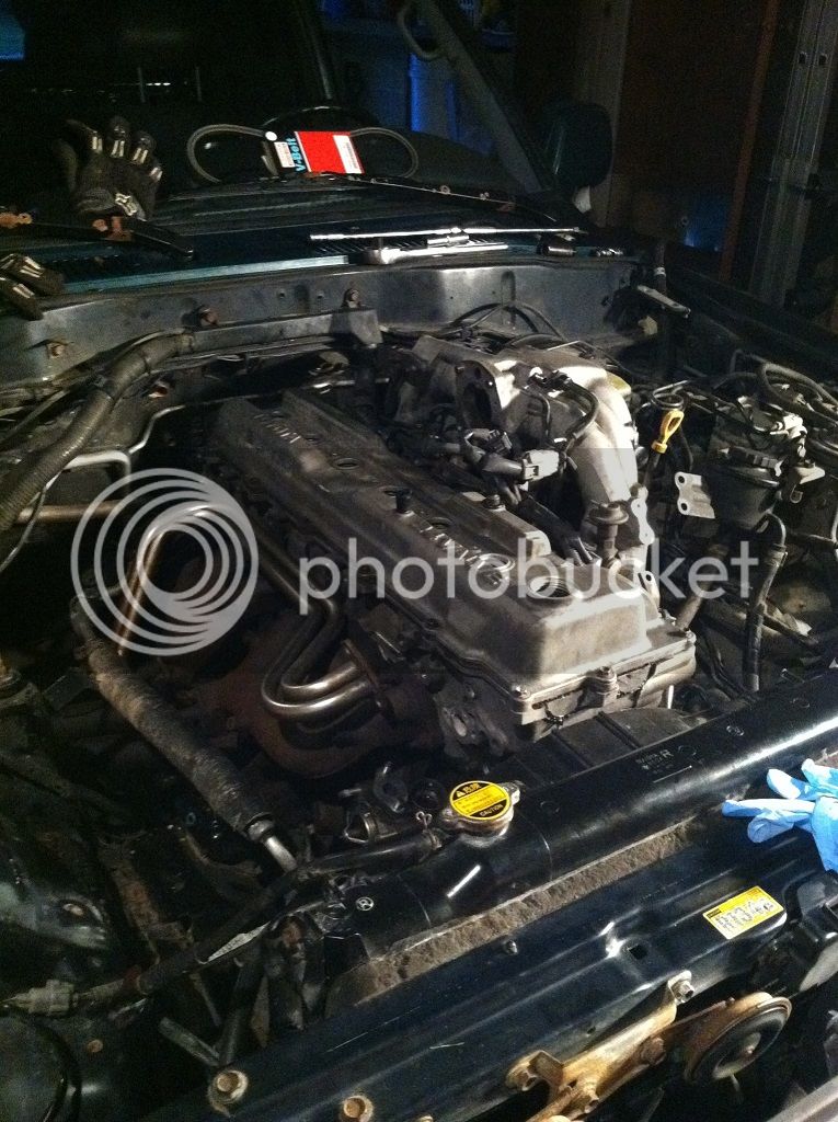

Fortunately the head bolts arrived on Saturday. Spent all day Saturday cleaning and prepping for reassembly...
and den Sunday:
block cleaned
head gasket installed
head installed
head bolts torqued to spec
cams installed
cams degreed
caps torqued to spec
replaced the spark plug rubber grommets? (old ones were cracked and brittle, glad these got replaced)
plugs installed
valve cover cleaned
new valve cover gasket installed
new boots, grommets and O-rings on all of the injectors
fuel rail and injectors reinstalled
upper manifold cleaned and reinstalled
Oh... and the PHH... yeaaaaaaaaaaaaah... here's what it looked like:
replaced with Gates silicone hose and constant tension clamps!

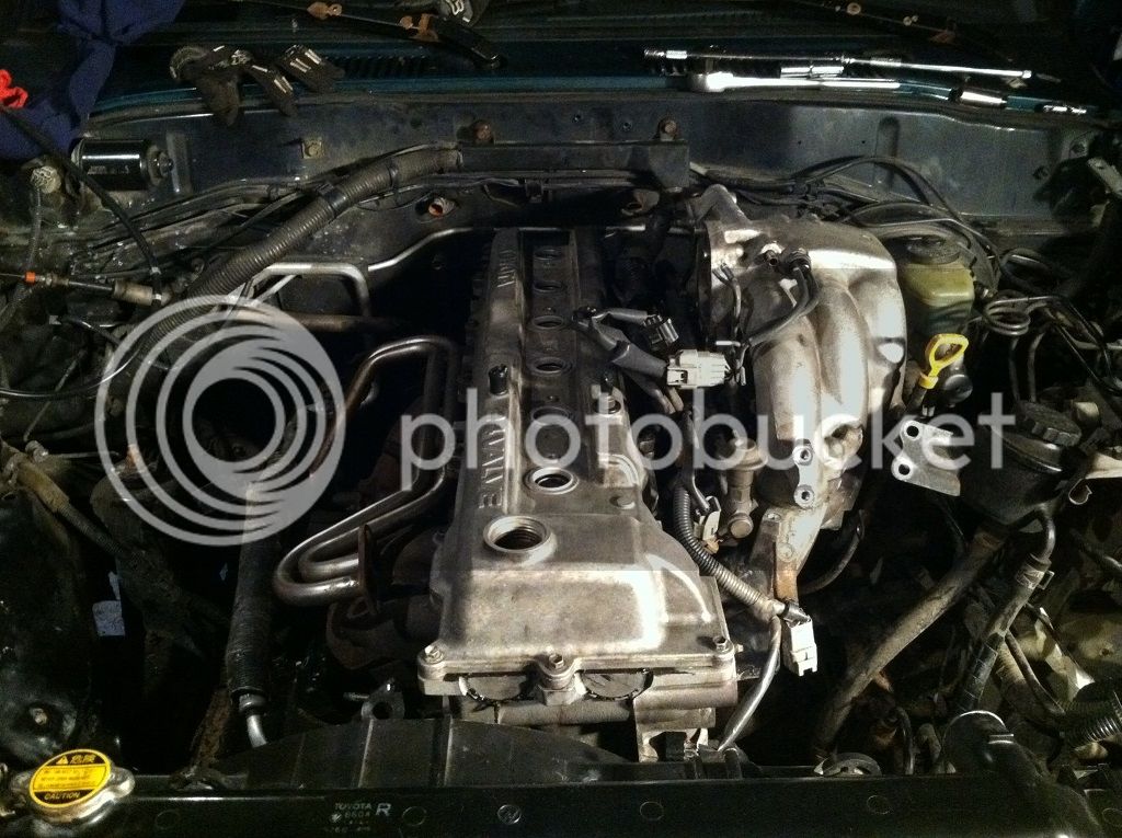

As I'm getting close to buttoning this up... the reassembly questions come...
Are there no gaskets for the t-stat housing and this other hard pipe?
I tried to keep corresponding gaskets with whatever I took off...
I can't recall the answer on the red arrow but I know that the green arrow has two O rings.
