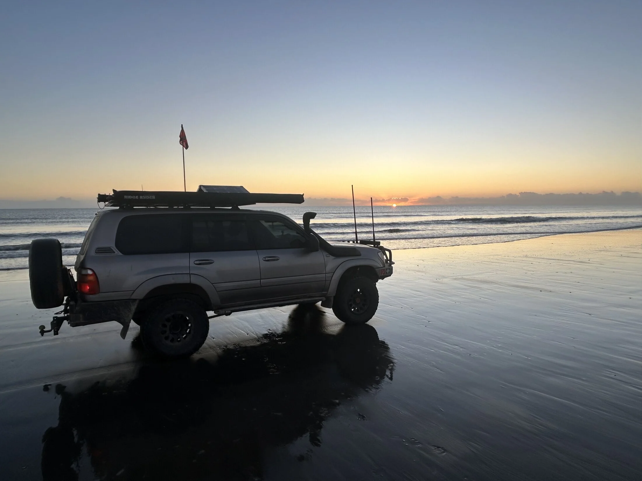

Hi muddies,
In a month or two, I'm heading off-road into the Australian "outback" and wanting to have the best communications I can afford.
I've got my UHF and my mobile cell-phone repeater installed and would now like to have good access to AM/FM radio.
Can someone recommend either a booster for the standard suburban radio aerial (are they any good?) or a decent aerial to replace it?
It's going on my Landcruiser J100.
Thanks,
Rob
