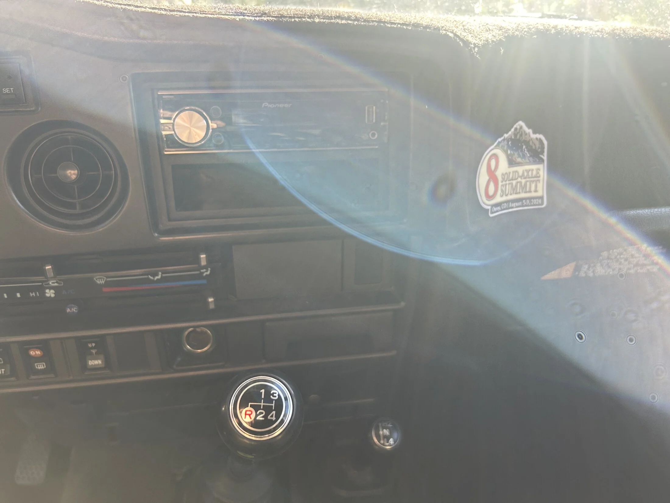

In other news, truck is buttoned up for the most part. Drove it a bunch yesterday and holy sheep droppings is it a new truck. As everyone says, it really wakes up the 3FE. Feels more like I did an engine upgrade.
I really want to thank everyone who has contributed and encouraged me through this. I really thought I was going to have to give up this truck after it ate its second transmission but Mud truly banded together and gave the great gift of community.
Also, tackling a project like this seemed very daunting a couple months ago, now I have much more confidence to tackle bigger and bigger projects, though I’d like to give the big projects a rest for awhile. 😉

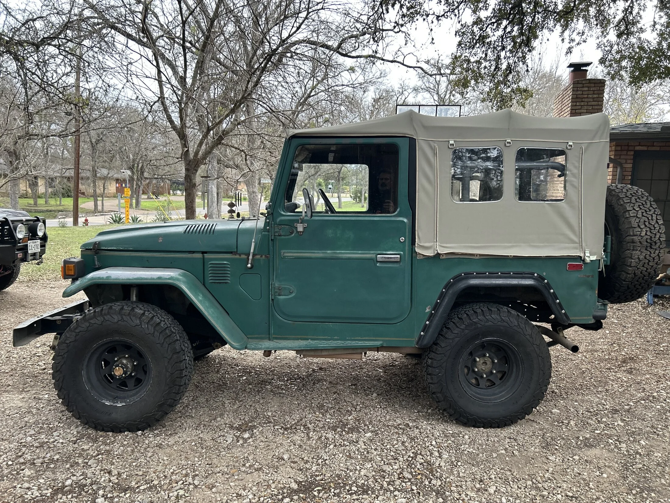

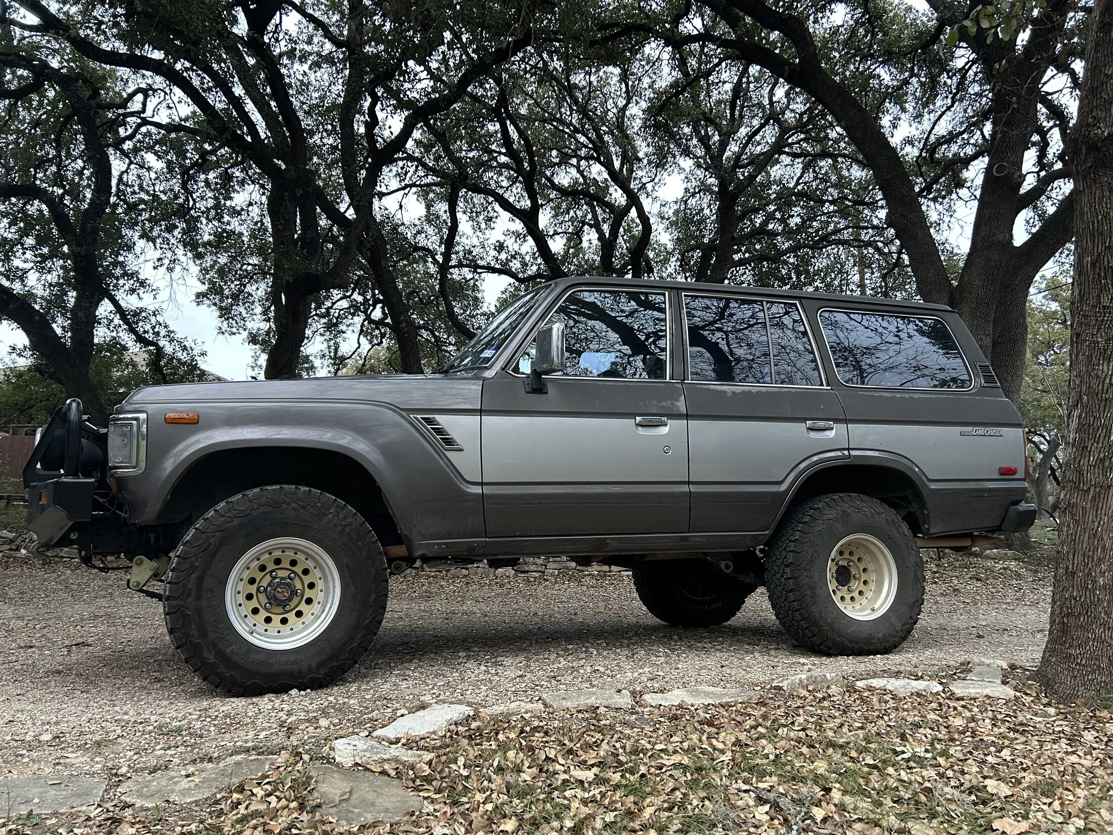

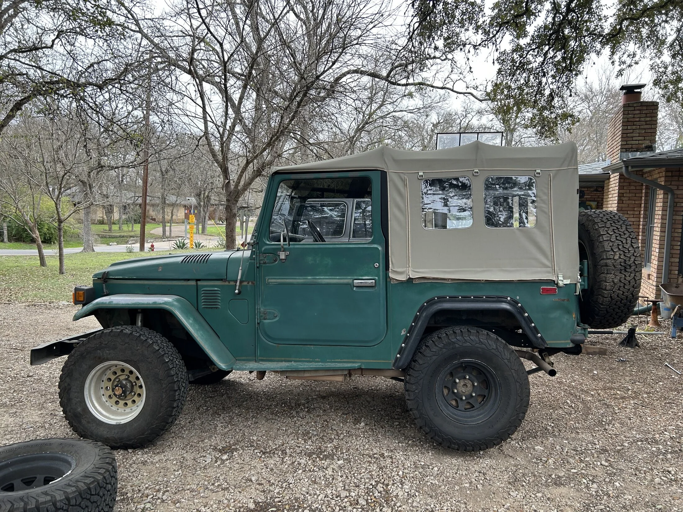

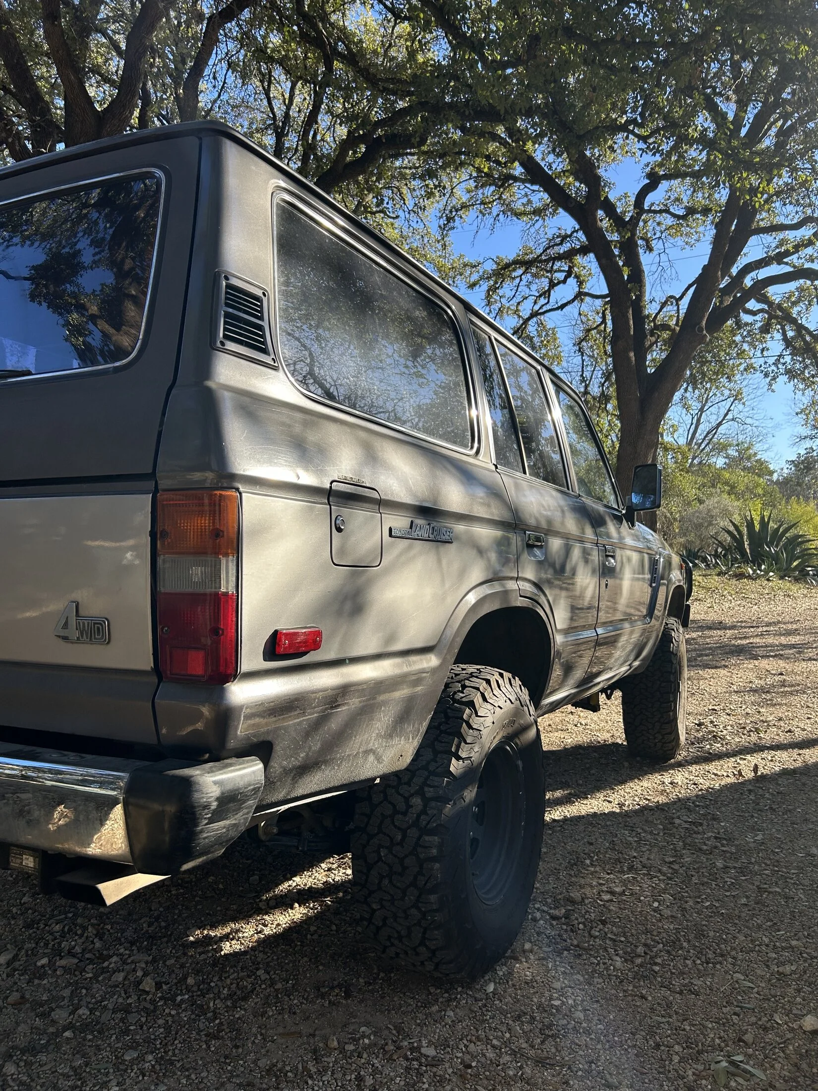

So I had 32” BFGs on here. So, 30.8” in reality.
The terribly named but awesomely contented site:
Grimmjeeper.com a final gear ratio calculator suggested my tire size was too small. And it really was. So I swapped the 33” BFGs from my 40 (32.5 actual) and what a difference. Haven’t driven a ton at high speed but I can really tell the difference.
Thought I’d loathe the look of swapping these, as if it matters, but I actually like the outcome on each.
