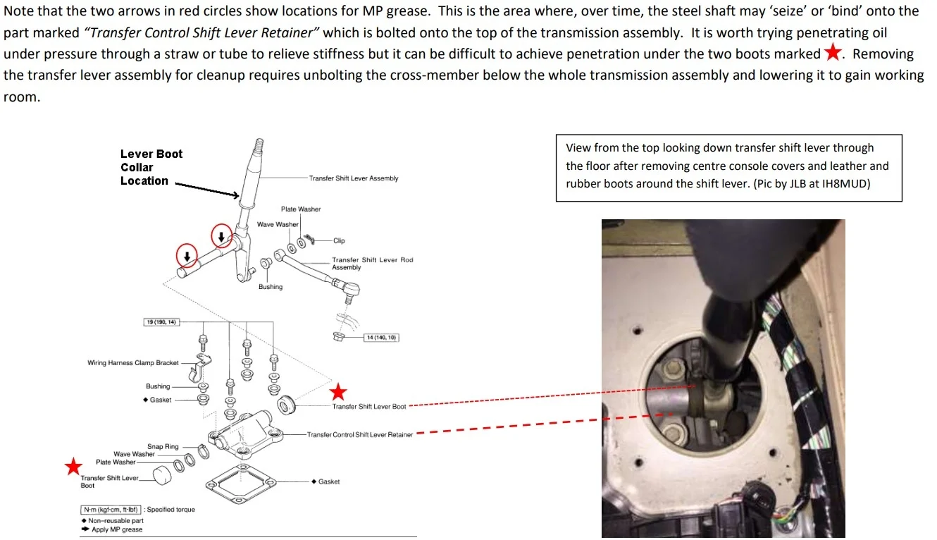

Here is a description of the problem and the shift linkage and one of the methods used to fix:

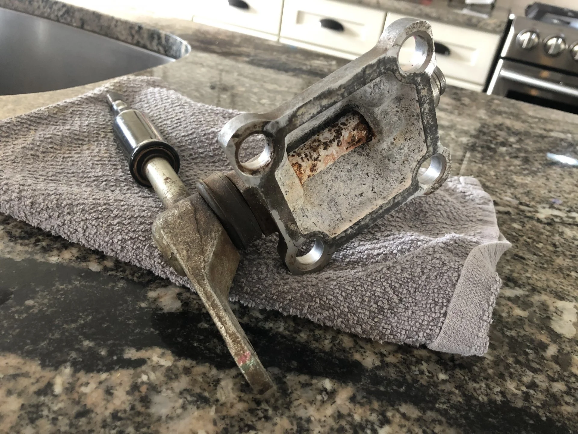

If the HI Range / LO Range shifter is not used much, the situation gets worse with time. Mild corrosion eventually causes the offending part to look like the pic below, at which time the shaft inside the retaining cover refuses to move. This is 'inconvenient' if it finally seizes on a trail and you need LO range but are stuck in HI range (my personal experience!), or, you are ready to come home and cannot get out of LO range ....
A flood of penetrating fluid like PB Blaster may help -- but this has to get past the little rubber boots at both ends of the relevant shaft as shown on the diagram and pic above -- not easy with the part in place on the vehicle.
A lot of working of the lever may be enough to correct the current situation if is not too far gone. Thereafter, remember to "use it or lose it".
The main point is to be aware of the problem and know that it will have to be addressed eventually.
