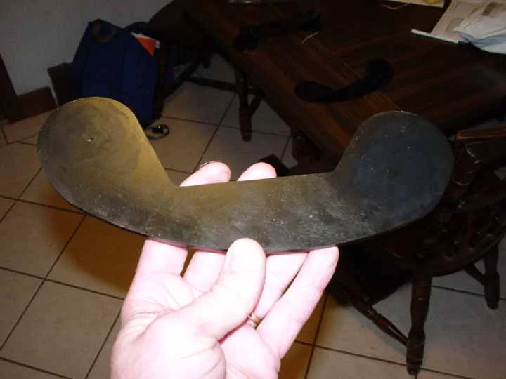

The steel was laser cut and the dowel was welded into place and the back ground flush and black oxide plated. I checked it's shape with my caster templates and the fit is perfect.

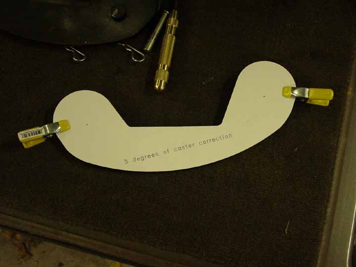

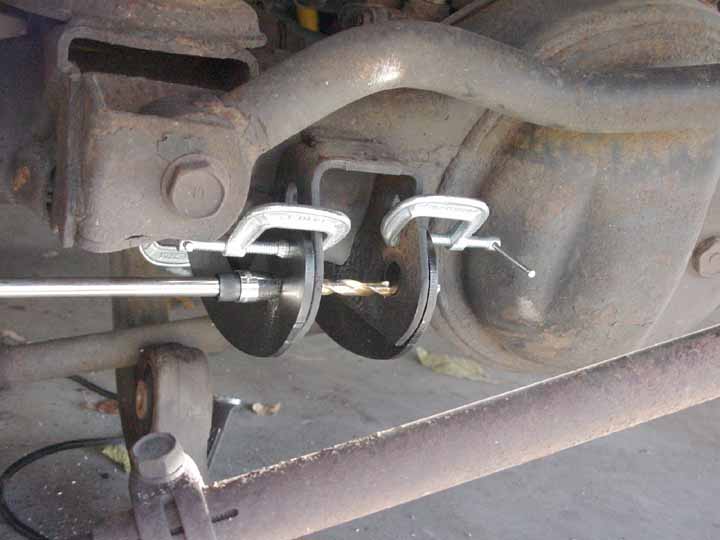

Fiorst pics are the positioning of the 5* template for pin punching and the 1/8" pilot holes drilled into the plates.

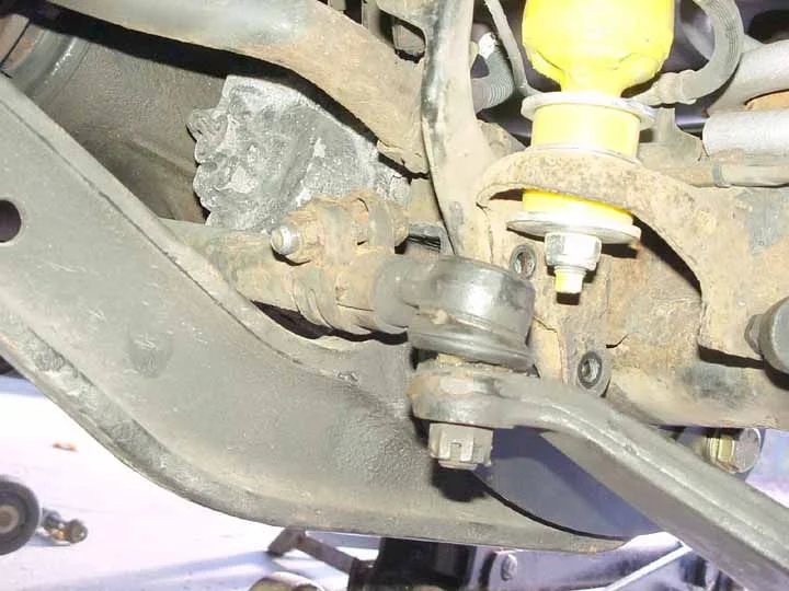

Now it was just a matter of bolting up the arm and checking clearances. I haven't finished the birf job yet so it will be tomorrow before I can comment on the handling. One thing I did notice is a much better angle of the diff to the T-Case for my DC shaft. Also, after rotating the axle I noticed that the spriong sits quite a bit tighter to the axle. This is do to the fact that the axle basically rotated up on the shock mount.

Rick, what is that drill extension tool shown in your photo? It's has a very small diameter to hold that large drill bit. Never seen anything like that.
I drilled the pilots on the DS from each side and then the rest from the outside in through both plates. On the PS I had to drill all the holes from the outside in. For the PS you basically centerpunch and drill the the plates, then mount the outside plate on the outside and drill the axle plate using the pilot hole of the plate as a guide, then you mount that same plate on the inner side of the axle and drill that one. Now that both sides of the axled have been drilled you mount the plates appropriately. Then you just step up the drill sizes to enlarge the hole to 5/8".
That extension you see is a 1/4" hex drive extension. I bought that to go with a 5/16" hex drill bit for the first size up from the 1/8" pilot hole. The 2 remaining passes of a 1/2" and then 5/8" where done with a modified 7/16" extension drilled out to except the 1/2' shank of the larger bits.

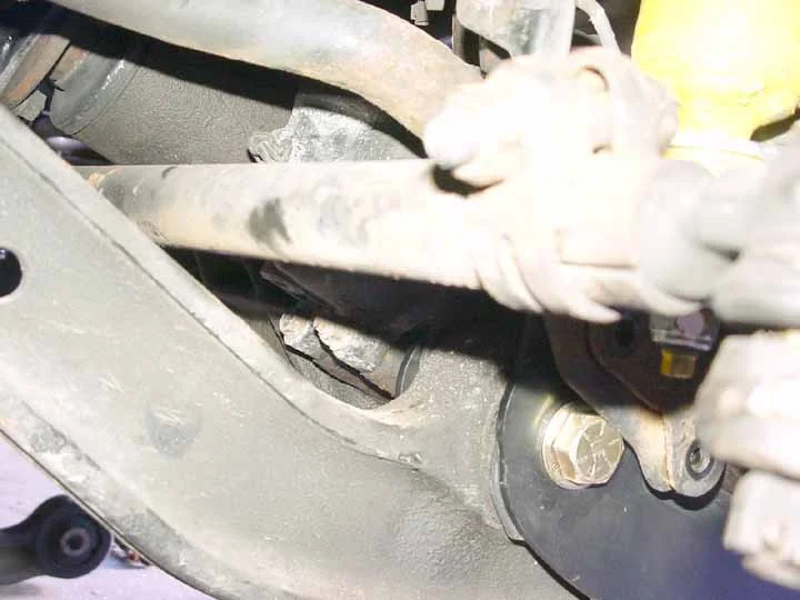

I don't mind flexing out the front end it's just not sure how to do it, I don't have a fork lift handy. One of the main reasons for my design was to continue to capture the bushing with the original plates. If you look at the pic of the drilled front of the PS you'll see that there is still plenty of the original plate to contact the bushing. From this I'd think it's pretty much the same as stock.
