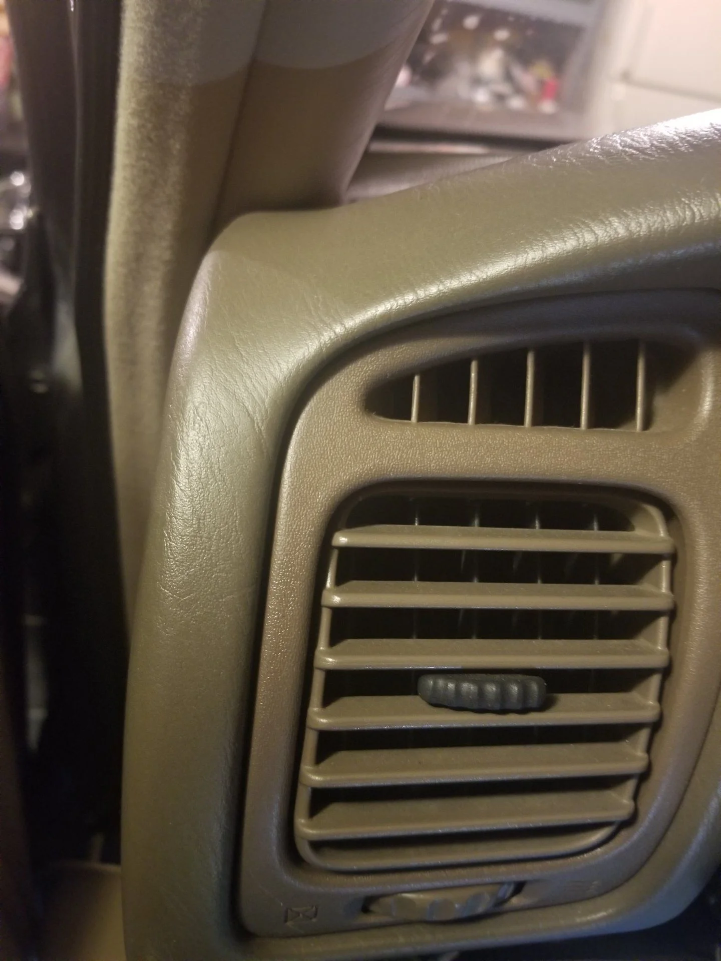

Attached is a pic of the interior temp sensor below the ignition if anyone needs it for reference.
I also uploaded a pic of the warm air coming out of the vent:rimshot:

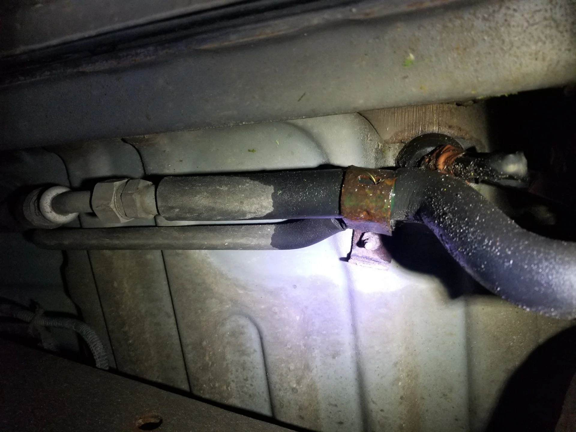

I had r134 added with some dye. After about a week of driving I found this on the rear A/C line.... This must be the infamous rear A/C line leak? Is this costly to repair through an independent shop without capping?
