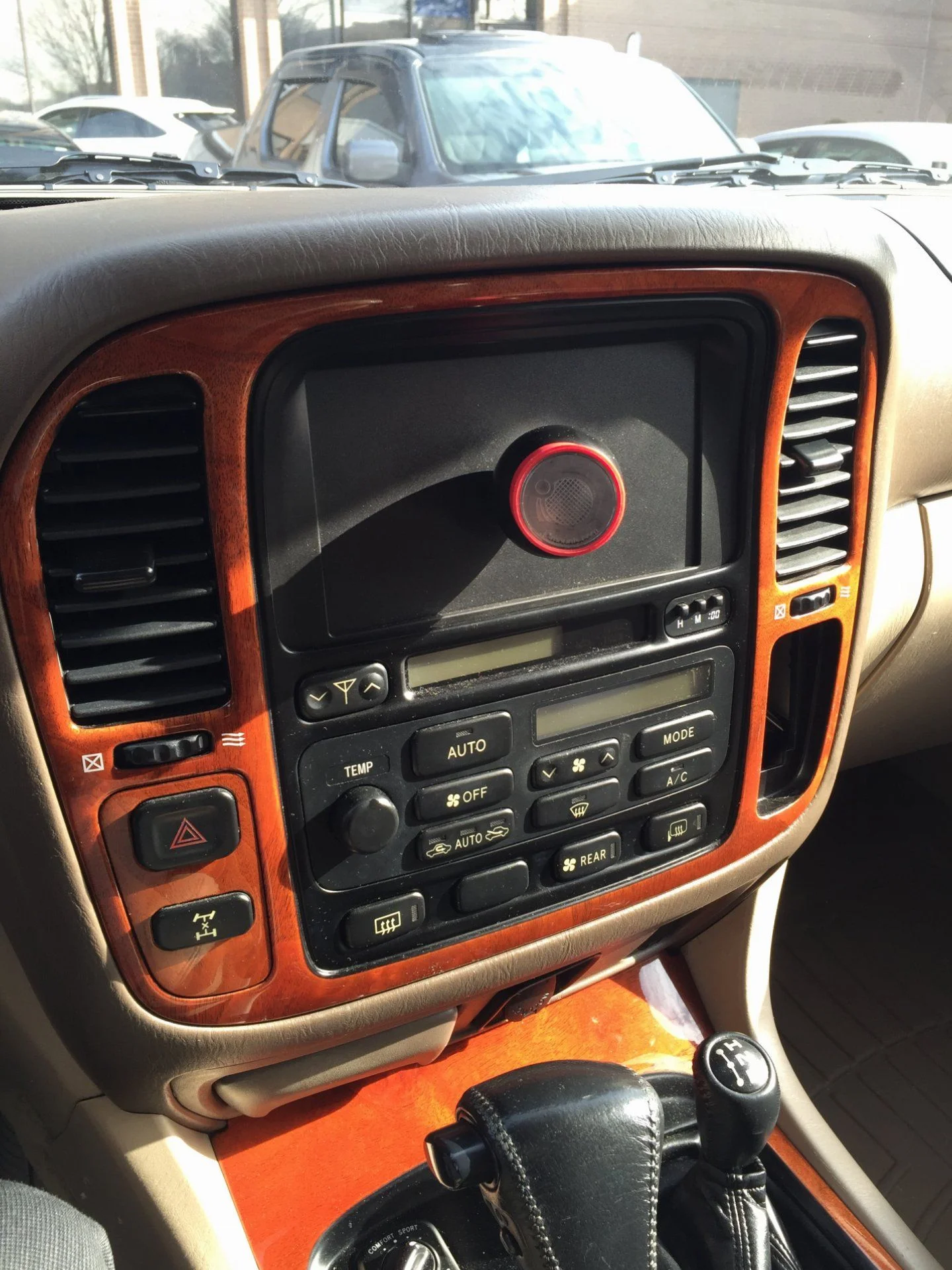

Hello fellow Forum Members. Wanted to get everyone's expertise on a current pet project I am thinking of doing for my LX 470 HU. The head unit is OEM and is not functioning properly and I am thinking of switching it out with a Pioneer NEX 4200 System. I wanted to get some thoughts on the following things I am looking at:
1. There is a lot of talk about Mark Levinson and Nakamichi stereos, but my HU simply says "Lexus Premium Sound System." Does this mean that my stereo unit is neither of the brand?
dscn6365-jpg.581644

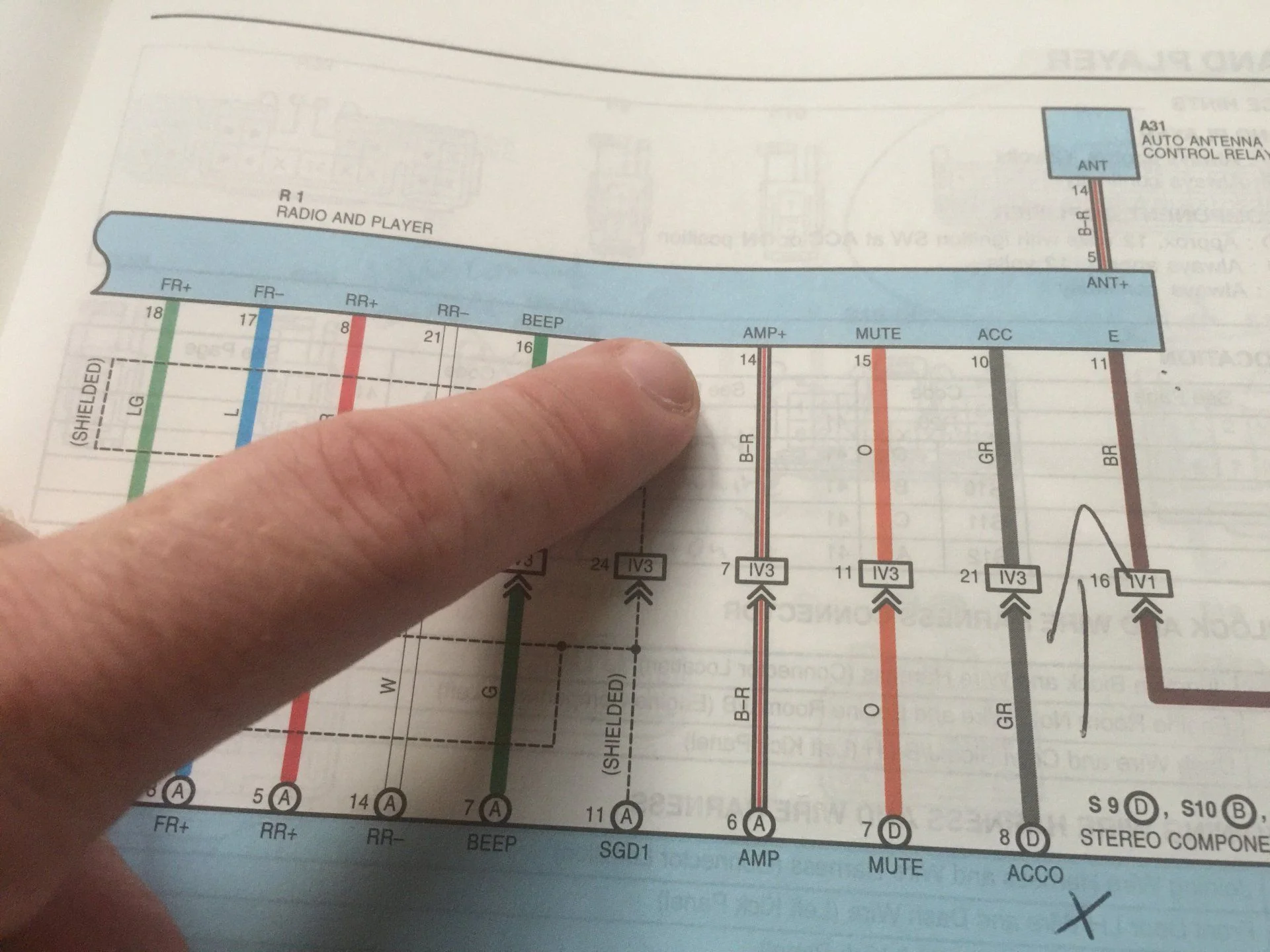

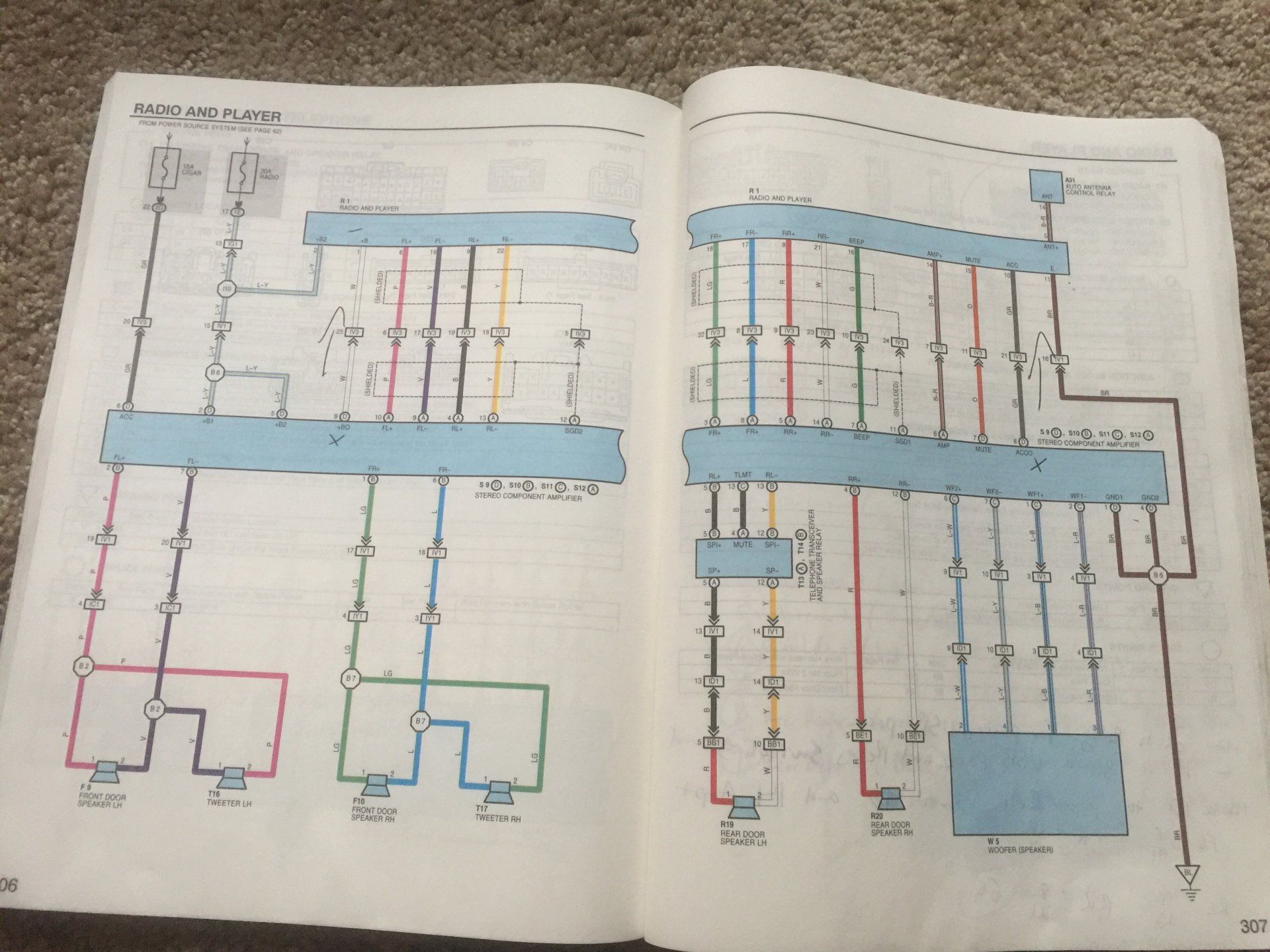

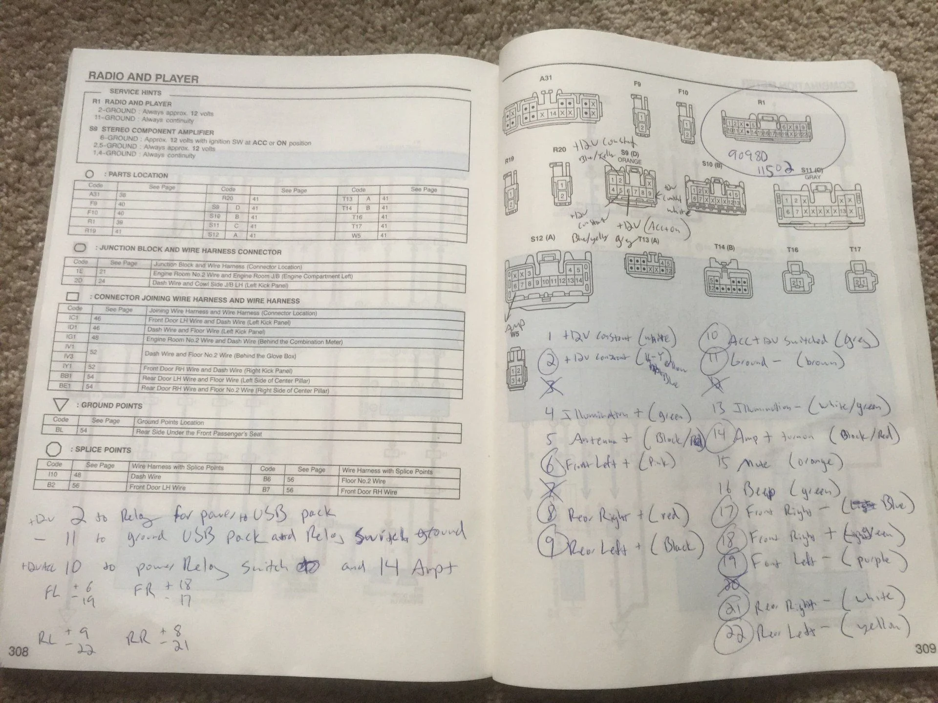

I hard wired a Bluetooth system into my 99 LX using the factory amp. I believe it was pin 14 on the radio harness (black/red) that needs to send a +12v signal for the amp to turn on. I wired that to a 12v accessory signal so every time the car turns on the amp turns on. I wired in female RCA connections into the radio harness and used the normal power and ground for my Bluetooth device and USB charger. Right page with connectors is how it was. Left page was what I used. It might be a little different but I was able to keep the amp. All I have visible is an iOmount for the phone/tablet/monitor and a volume knob. Hope this helps a little with options.
View attachment 1531007 View attachment 1531008 View attachment 1531004 View attachment 1531005 View attachment 1531006 I hard wired a Bluetooth system into my 99 LX using the factory amp. I believe it was pin 14 on the radio harness (black/red) that needs to send a +12v signal for the amp to turn on. I wired that to a 12v accessory signal so every time the car turns on the amp turns on. I wired in female RCA connections into the radio harness and used the normal power and ground for my Bluetooth device and USB charger. Right page with connectors is how it was. Left page was what I used. It might be a little different but I was able to keep the amp. All I have visible is an iOmount for the phone/tablet/monitor and a volume knob. Hope this helps a little with options.
dscn6365-jpg.581644
