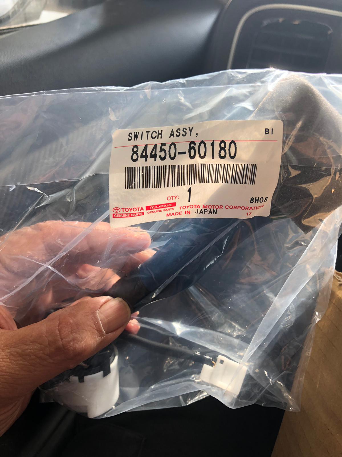

Here is my adventure in this endeavour that is still on going. I ordered a new NSS which is on its way, but I tried cleaning first to no avail. .
Dino, thanks for the part number. I will put that on the list of possible solutions.

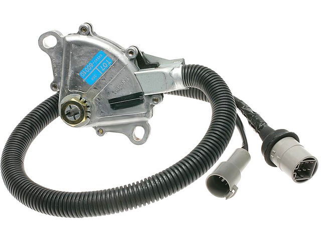

Does not start in neutral points to the NSS. The NSS connector we are talking about is directly into the switch itself, NOT the one many find in the EWD. Passenger side of the tranny where the shift linkage terminates. Threads exist about cleaning the NSS, replacing connectors or both.

a442f and a343f (or whatever it is) are all on the NA passenger side. crawl under the truck, follow transmission shift linkage to the end, go up to electrical connector.

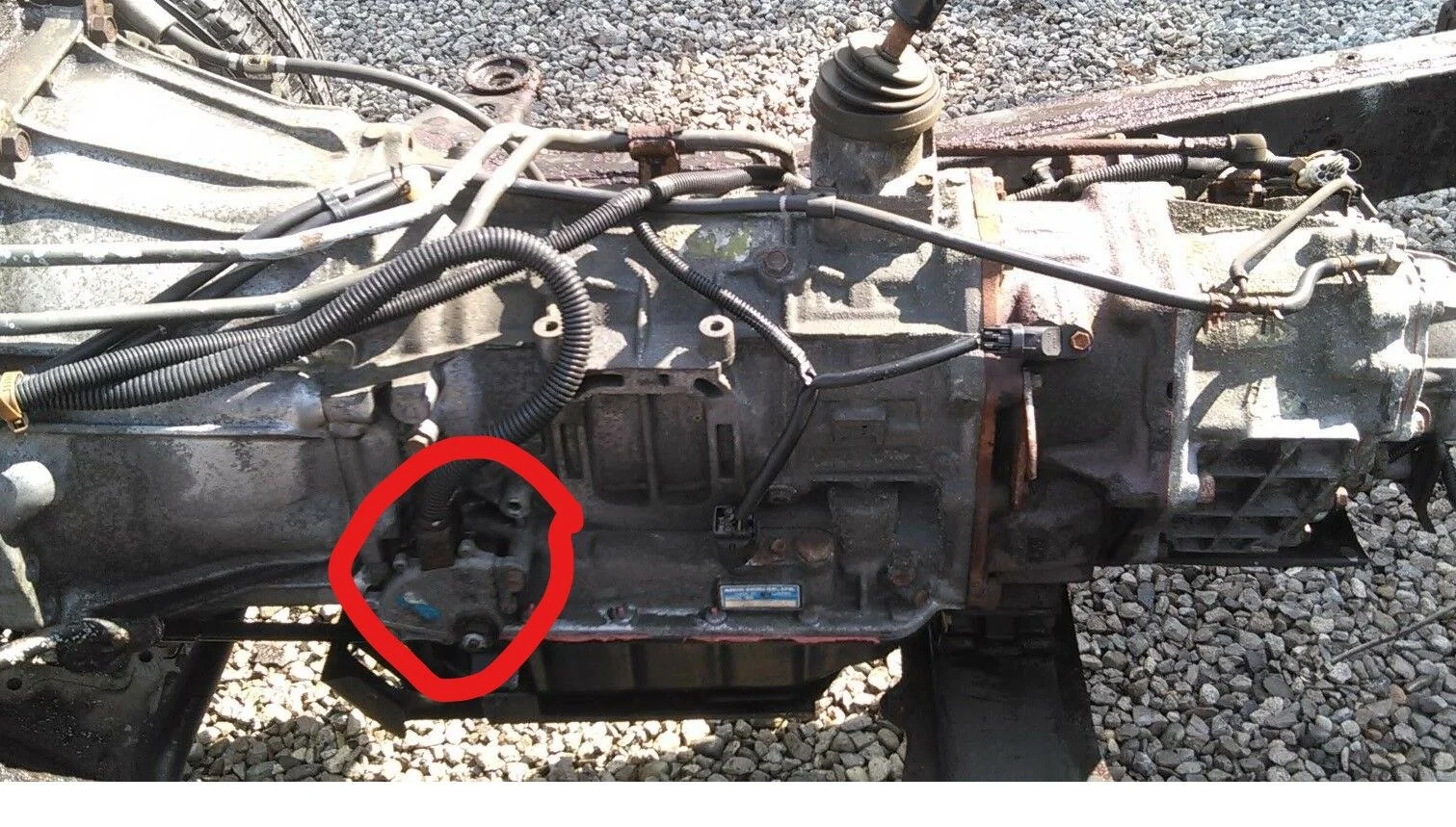

It appears I may be incorrect. Look here....
the shift linkage should lead you to it.
This? This is on the drivers side. It has that metal plate covering the connection
Is this that metal cover plate that covers the wiring connection removable?
