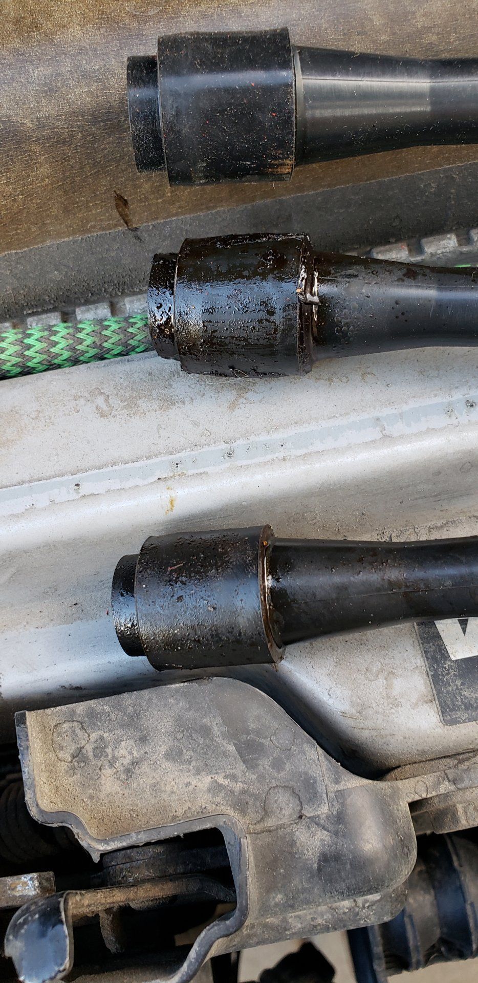

I noticed the back of my 1FZFE in my 96' LX450 (my second cruiser and not my GM conversion) has some sort of fluid leak. Not sure where to start in diagnosing?? The engine has 290k on it and I was planning to rebuild sometime this winter (about to pull the trigger on all the parts and a turbo), so I'm hoping this is just the rear heater piping?? Clean it off and run it?? I did notice that I was low on coolant the other day and the engine burns a quart every 500 miles or so (puff of white smoke on start up). Trying to figure out if I should be driving it or not until I can get to the engine.
It looks like the valve cover gasket is leaking. Clean it off with some degreaser and you should be able to see where it’s coming from. Keep an eye on the oil level and it should be fine to drive. It’s an easy fix to replace the gasket.
Hard to tell from pic. I would do a good cleaning and then watch closely where it comes from. Also dab some on a clean paper towel as the fluid comes back to get a better idea if its oil or coolant.
And I thought my engine was filthy (which it is).
I would agree, that is just the valve cover gasket. Easy fix. Plan for the following:
- To get the valve cover off, you'll need to remove the throttle body. Good time to clean it. Buy new throttle body gasket while you're at it. Clean and lubricate butterfly valve as well
- With valve cover removed, good time to replace the spark plug O-rings and PCV grommet
got it all cleaned off. It did look like oil and I had marked my coolant a month ago and it hasn't budged.

Changing valve cover gasket right now....oil on #3 and #4 spark wires. Fipg on the tube thingy?

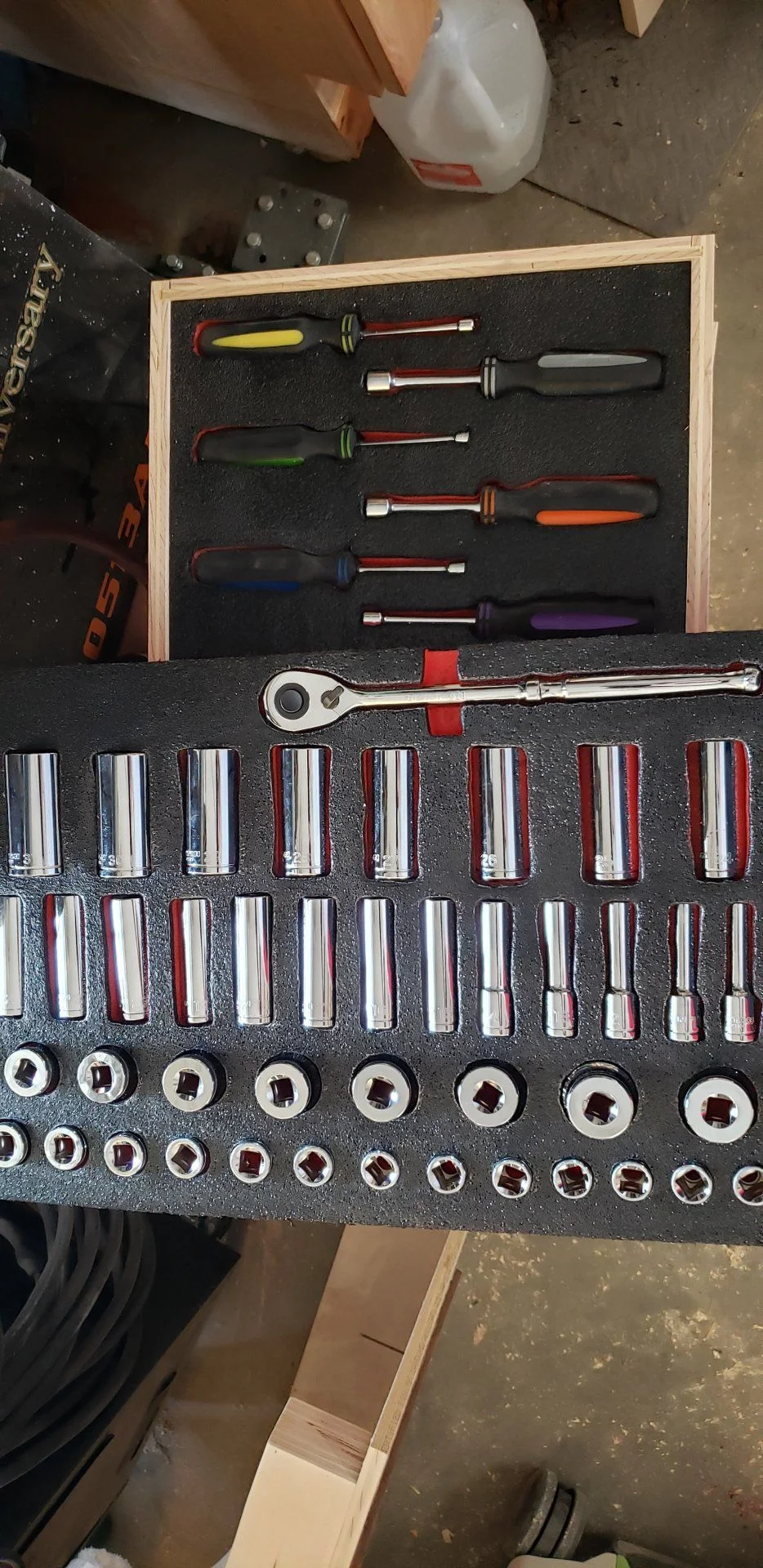

well, i got it all done. Ordered an ishito stone kit for $40 delivered to my house. Took 3.5 hrs including my diagnostic victory lap and helping my kids get dinner on the table and a trip to autozone. I just invested in all new hand tools. My dad has a brain injury and my tools keep disappearing and he blames me for being disorganized (which is true), but i can usually find my stuff within 45 mins while after he's around stuff is just straight up missing.
Anyway, me and the new tools are on our first date and i drop the stupid 10mm wrench behind the engine and my luck is it doesn't fall all the way to the ground. I spend about 20 mins trying to get the stupid thing and finally i resign to go to autozone for one of those magnet things. Turns out, it's the best $2 I've ever spent and took 3 seconds to retrieve my wrench. I figured my new wrench was going to end up on the highway somewhere...

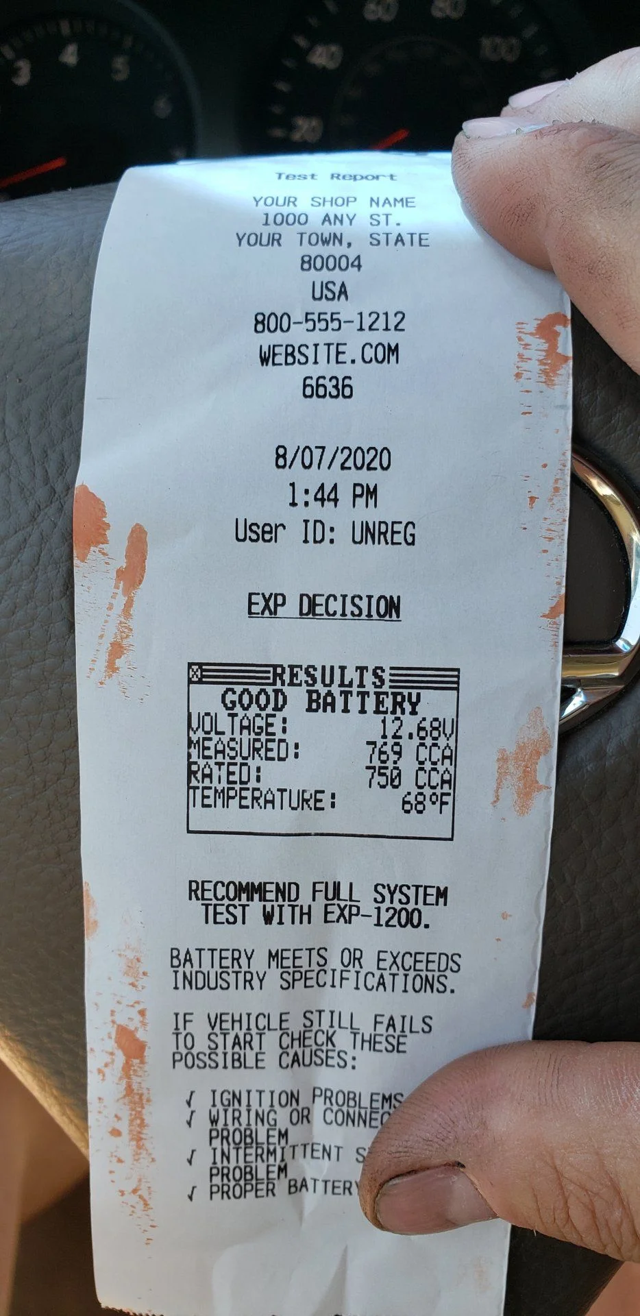

Pulling battery and taking to advance auto for them to tell me nothing is wrong with it.
Why does this stuff happen when you're trying to leave town for vacation?
Battery is good.

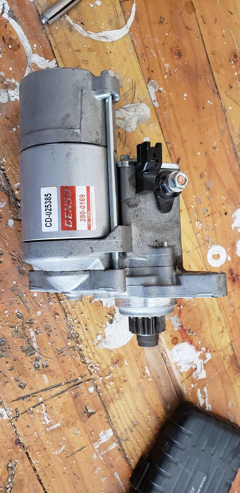

How do you bench test starter? I have a 12v power source, but it only goes to 60a....
Sounds like a starter solenoid/contacts issue. There have been many instances where remanufactured starters are not problem free. I would pull the starter down open up the solenoid and inspect/reseat/reposition the starter contacts and plunger.
You can use jumper cables from your battery to bench test.
Since the starter has ~300 miles on it, that means it was recently installed. Before ripping into the starter, I'd check that power cables are securely bolted to the battery and also at the starter end.
cheers,
george.

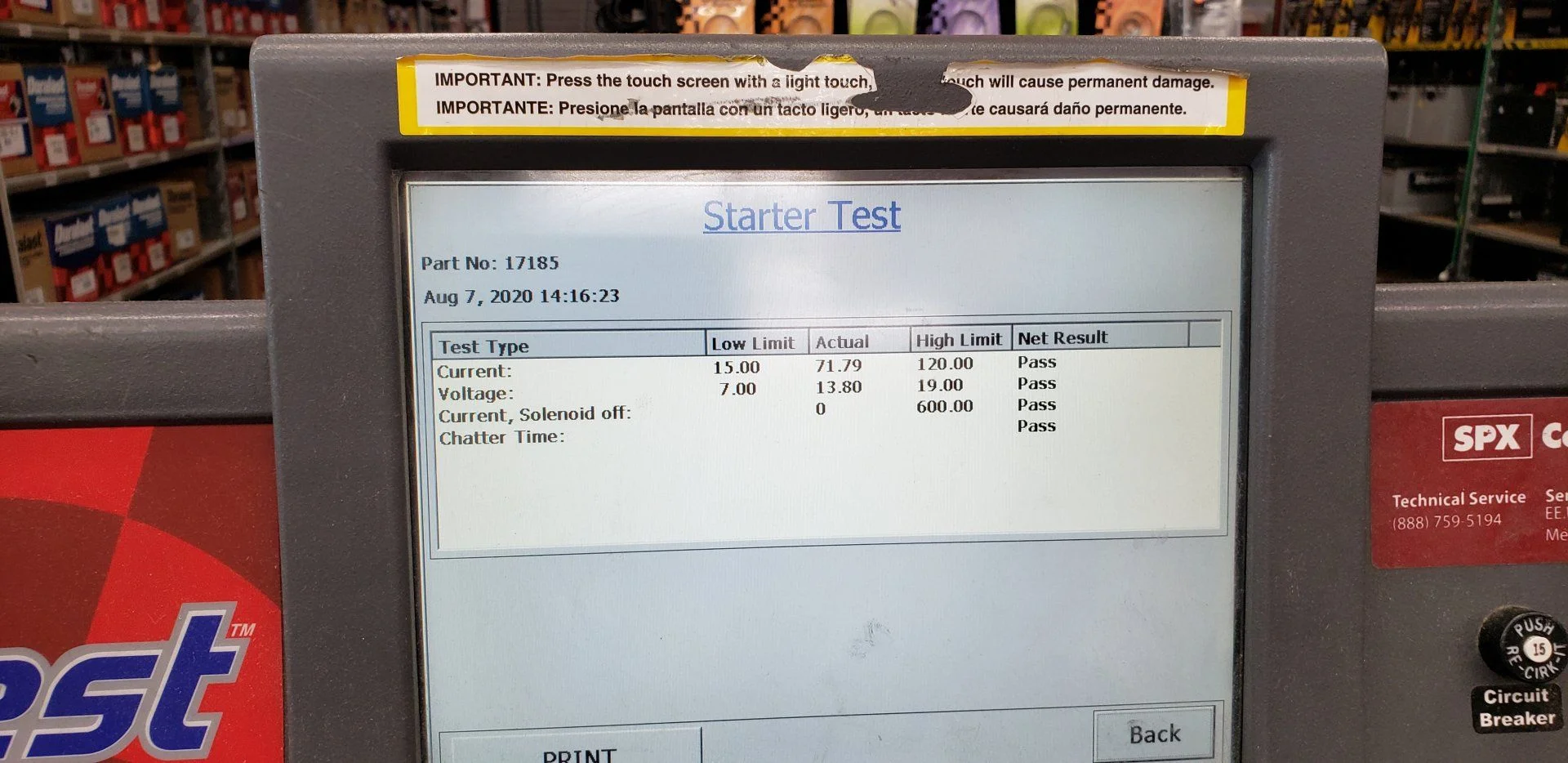

Checked terminal ends, cleaned, retighten, no change. Pulled starter, probably going to take it parts store....
Starter is testing fine....make a new power lead, check grounds?
Checked resistance in power lead = 0.1 ohms, voltage just under 12v. Continuity at trigger wire when firing trying to crank and 11v.
