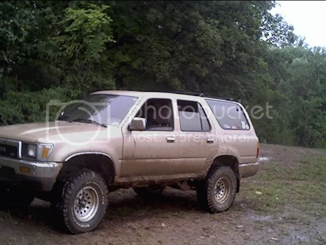

OME springs in rear,shocks front & rear.cranked front torsion bars.likely a better way to do the front but it works for me & costs nothing
That is sweat, cruiserbent. What size tires? And, is the OME 1.5"?
