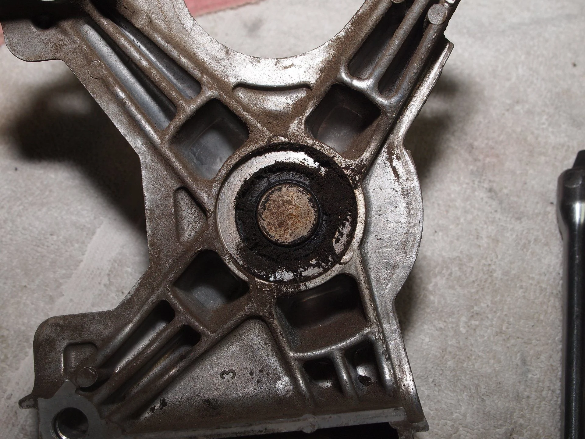

Replace fan bracket if old is no longer serviceable. I've seen last over 250K on some less than 90K on others. If any play felt in bearing, or oil coming from rear replace.

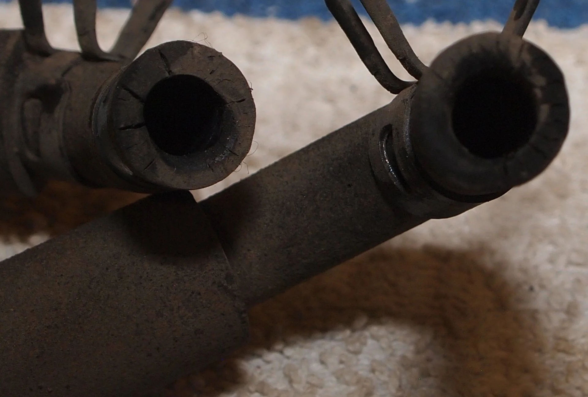

Hoses on our rigs kept clean and in mild climates last a very long time. How long who knows. Just inspect for any swell, cracking or hardening and replace if no longer serviceable.

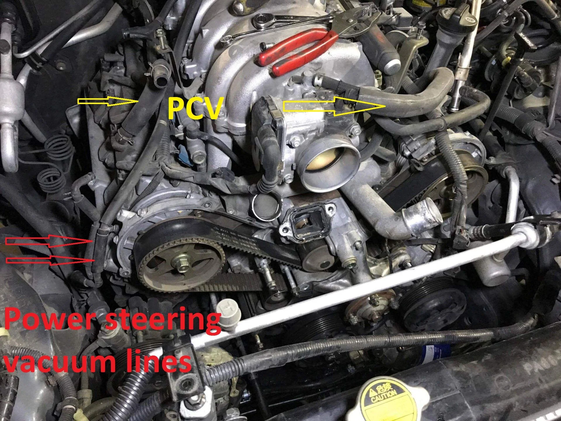

The four I fine need replacing most often are both PCV hoses and the two vacuum hoses from power steering post #148 Scored a 06 LC (untouched Jewell restoration)

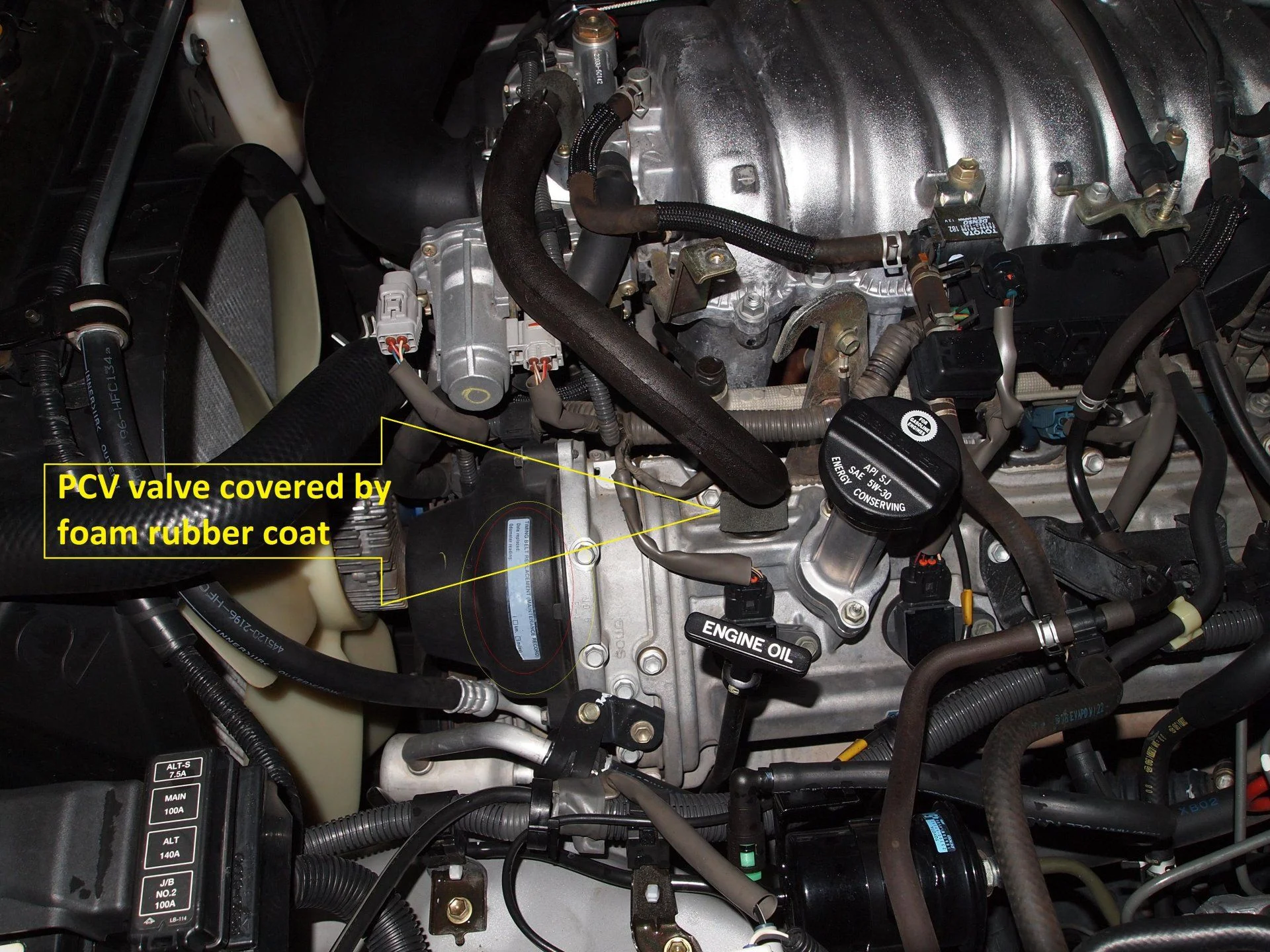

This is stock photo of 03-05 IIRC
On the 98-02 a rubber grommet is holding in the PCV valve. It will last about as long as these hoses (~90K miles), so inspect for tightness. PVC valve itself can usually just be cleaned & tested, but cheapest of all parts to just go ahead and replace.
