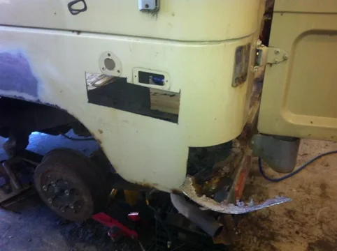

So yesterday I made the rear sill that is obviously needed. I have some video but just stills for now.
Second pic is forming the inner piece at the shop
Third is welding it at home.
Fourth is spot welded to the outer piece and finished part at work this morning.

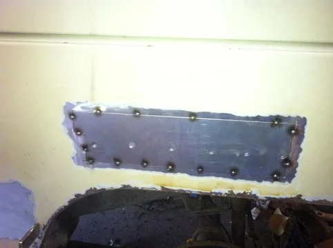

This morning (Saturday) I picked up where I left off on Wednesday night. Cleaned the weld of this patch and tacked on the quarter patch. Welded that in too.
Welded in

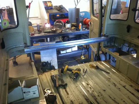

Then on to the back section. I decided to do the rear portion of the inner fenders and the sill all at the same time. If I cut all of that away the body will flex and move all over so I first pulled the quarters together until the doors had even gaps again (it was already spreading before I even got the 42 home) Then I welded in a scrap section of channel across the tub at the point where the top bolts on.
Then I started cutting
and cutting

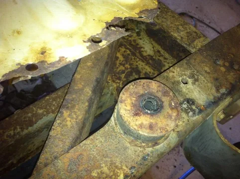

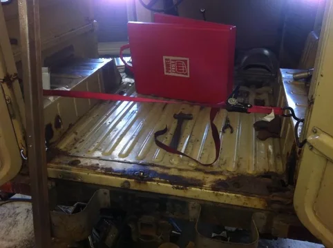

To take out the sill I had to drill out the spotwelds where the floor overlaps the sill
Yikes!!
Frame looks good but there are signs of trouble to come
holey
Gravity is not a friend. But I found a solution :D
