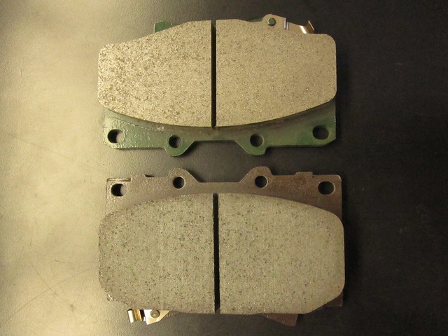

ill agree to disagree there. I have a JDM spec hdj81 (which use same front brakes as 60 series) when i switched over to FZJ it totally changed the game. The pedal response, effort and longevity improved so much i was choked i didnt do it the day i got my truck.
the 100 series pad doesn't fit on the hdj81. but i do not see how a 100 series pad improve the braking power. maybe it will just prolong the wear due to its surface area.:confused:
The common misperception is that the 100 series pads will "stop better".
This is incorrect.
The only reason to install 100 series pads is for longevity of brake pads since the 80 is so heavily proportioned to the front.

TOP: FJ80
BOTTOM: 100-Series
Purchased the 100-Series Brake Pads [bottom] to replace the stock FJ80 Brake Pads [top] for an upgrade - larger surface area. BUT, They did not fit my 1992 80-Series... so back to stock pads for now. I will look into grinding the 100-Series pads to fit. My biggest issue is that my rear axle seals have leaked and my rear drum brake shoes are shot, so I have larger issues at play. But I did not know the rear seals had leaked so theirfore I did not know I had a rear brake issue. My fronts wore out faster due to having more stopping responsibility as the rear brakes decided to take a grease bath time off.
