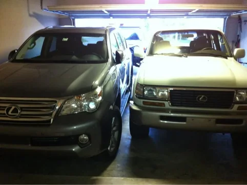

Considering the unplanned 1/2" holes in the roof and the impending rain, had little choice but to squeeze into the garage.
Hoping these two procreate. It'd be interesting to see the offspring.

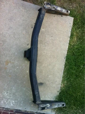

Free stuff, pay shipping and handling.
OEM Receiver, no harness
Spare tire frame
Rear seat belt assemblies, no bolts, PS has been cut and resewn. Probably not DOT approved.
Be willing to deal on the third row seats.
Edited: and the plastics and flares. I ripped them off, so they are what the are, but probably a local pick up, considering.
Spare tire frame
oem Receiver, is that the tow hitch? i need one.
BlackLS1 said:
thank you so much i have been looking for one, my 1994 doesent have the hitch i have been trying to track one down.
The assumption they'd be the same from a 94 to a 97LX, I'll leave to you or someone in the know, but it just needs prepped and painted. Even found the plastic cap still in the box, in the PS cubby.
I gifted the Reese hitch the came on the FJC to an FJCF member in Austin, and if I remember correctly, UPS was $60. I can palletize and send another means, but if you'll reimburse shipping (or if near Tulsa, OK, can pick up) I'll get out this week.
ok i called a local junkyard and nobody had any trailer hitchs. i will pick up yours, please let me know what shipping is and i will pay you for packaging it as well. thank you very much for the help.
