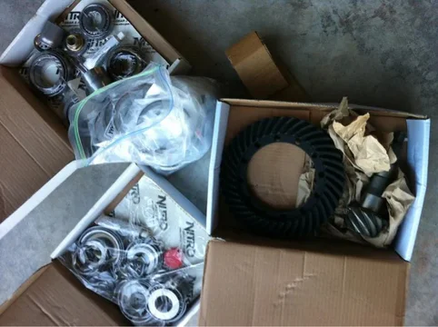

More goodies.
Rebuilding axle to coincide with installation, and replacing axle shafts and birfs.
PS order tomorrow, hopefully brakes soon. Trying to find the threads concerning 100 series system swaps, and read until my eyes bleed to determine viability.
