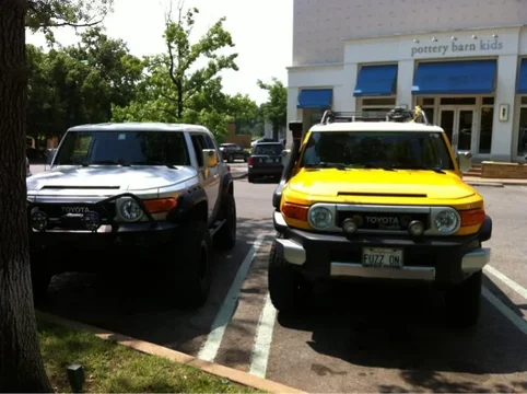

Any info on yo friends black rims
17x9 Method Racing BL with -12mm offset. Weigh 33lbs each and wrapped with a 285/70 Terra Grappler, soon to be mounted on a Diesel Toys converted FJC.
We mounted several yesterday and one item noted was how the hardware is recessed into the ring, leaving the bolt heads well below. Considering his tire choice, a good feature, since the rings will be more exposed.
I'be been running Trail Ready's on the FJC with 35x12.5s and the bolt heads aren't recessed, but the tire offers a decent buffer due to the bulbousness.
