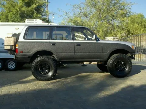

Some kind of liner. Was going to take this approach (need to find members name for proper credit. Apologies to whomever's pics I've stolen)
with the brown that matches interior ( whole interior will be same color) and repaint the upper lines and roof. Only issue is painting handles to match.
What are your thought on two toning with white liner on top? Personally, I don't like the liner, but it's the lesser of all evils considering its a $4k paint job, if prepped and ready, me supplying all seals, gaskets, and body hole filling.
Still planning the holes. There's 162 and welding seems to be absurd. Some have used bondo, aluminum tape, or epoxy. I really want to weld them, but wondering how much it really matters if applying liner.
Cutting fenders, too. I see a way to do with a return, allowing to bolt back to the inner. Hopefully that works out.
The rear is a different story. I'm not sure, but it looks like a double rolled seam at the bottom lip, so assuming its structural, to some degree. Can gain 2.5" on the front, but only 3/4" on the rear. Unsure if the rear is worth it.

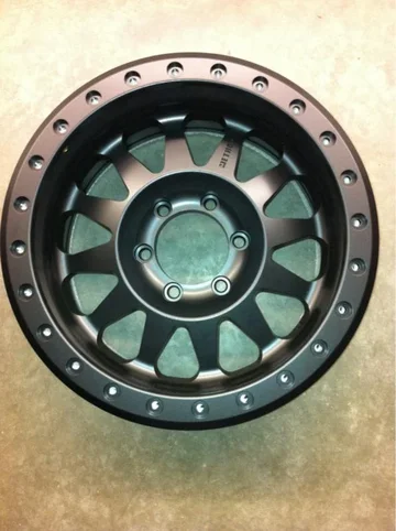

These Lexus-ish enough?
Method BLs that are actually a buddy's I'm storing while his FJC is undergoing a diesel transplant. Opened up while moving this morning, and they sort of look like the OEM Lexus wheels. Weigh in at 33lbs, 4lbs less than the Trail Readys on the FJC.
A consideration.
