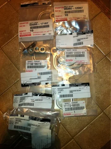

Everything arrived to install EMS exhaust.
A list for anyone else afflicted.
Exhaust Manifold
(1) Manifold Gasket 17198-66010 (rear 3)
(1) Manifold Gasket 17173-66020 (front 3)
(13) Stud Bolts 90116-10169
(13) Lock Nuts 90179-10128
Y pipe
(4) Lock Nuts 90080-17187
(4) Stud Bolts 90080-12007
(2) O2 Sensor Gaskets 89466-20020-83
O2 sensor studs and nuts along with the y pipe gasket are supplied by EMS.

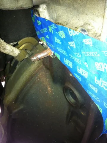

This sucks. If the PHH is any worse, I'm tearing the engine out to do.
Can't get this $&);:6(8$;;@$:; stud out for nothing.
No room to swing a BFH to engage a stud remover, either.
Both exhausts I've worked on combined have sucked worse than anything what done.
scottryana said:
1/4" piece of strap, drill a hole in it, slide it over the stud, weld and use it for leverage?
Going to involve some form of welding. Not enough room to get a BFH to engage a stud remover.
PITA!!!!
Welder at the shop and it's 220 so no bringing it home.
Stud extractor is permanently embedded on a y pipe stud. Rain coming and nowhere to move her.
