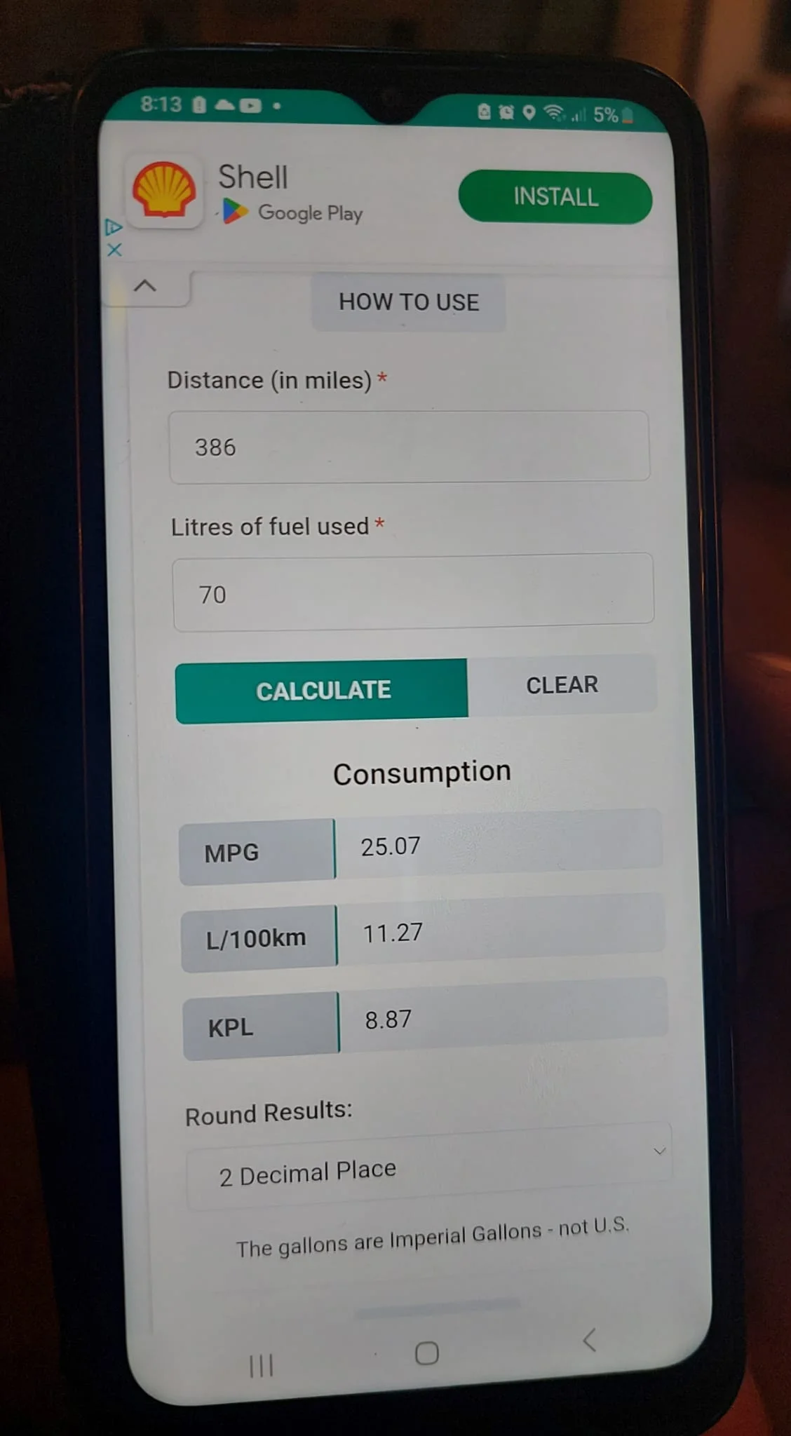

I get 30 without even trying, and it's hilly round here.
UK gallons are bigger than US gallons, as a result your mpg numbers will be higher for the same actual fuel consumption. Is that mileage figure calculated by odometer readings with a topped off tank? I regularly have people tell me their full size American pickup gets upper 20’s or even low 30’s mpg US, but they’ve never actually hand calculated mpg from tank to tank. In reality no full size pickup will get more than about 20-22mpg unless under absolute ideal conditions.
As mentioned before, UK gallons are not the same as US gallons.
But even then, i still have a very hard time believing numbers like this. Not only based on my own personal (rather extensive) experience with these trucks/engines, but also Toyota's own numbers.
For 1995-1997 trucks, with 24V TD and MT original claimed highway fuel consumption by Toyota was 11.2L/100KM. Which translates to 21 US MPG.
This claimed number would be under IDEAL test conditions, brand new vehicle, no modifications and running street/highway tires. These conditions are not realistic for 99.99% of 80-series owners out there, and i have NEVER seen a vehicle (ANY vehicle) from that era achieve their manufacturers fuel consumption claimed numbers in real world. So when i see people claiming 20% better fuel economy (25MPG) out of these trucks when they're 30 years old, lifted, overweight and riding on 35" mud terrains, you can see where my skepticism comes from...
And another point i brought up earlier - Toyota's advertised highway MPG numbers for the US 1997 FZJ80 were 15MPG, which makes this a pretty consistent number considering 40% less energy density for gasoline (in lab environment). How often do you see anyone claiming they're getting better than advertised fuel economy with FZJ ? Yep, pretty much never. So, someone please explain to me: how is it possible to get 66% (25mpg vs 15mpg) better fuel economy when diesel fuel only has 40% more potential energy in it (which you will NEVER be able to utilize fully in real world)? The math/physics just don't add up.
