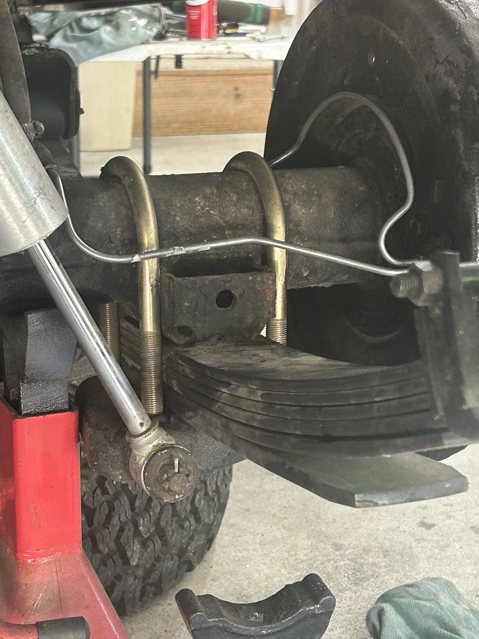

Those are some interesting rear springs for an FJ40. Usually see something that heavy on a 45/47 series trucks and troopies. Guessing pretty stiff on an FJ40.
You can add pictures to the same thread in the next post instead of starting a new thread.
2 ish inch ome springs. Ride is soft and smooth with good flex. This truck has an aluminum tub so a bit lighter than stock.
