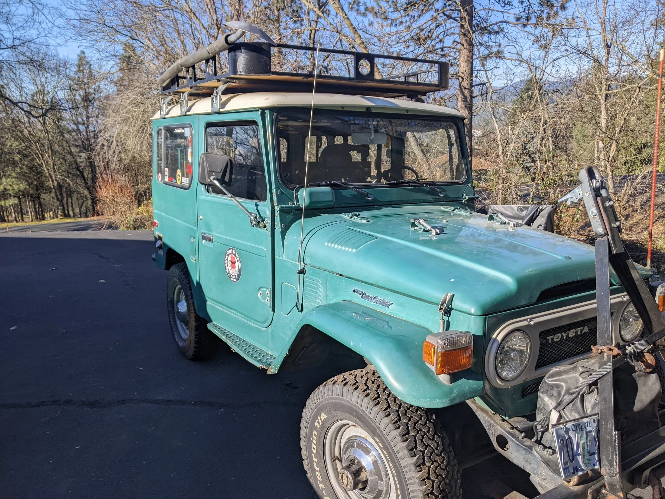

I recently inherited a 1978 FJ40 from my grandparents. My grandfather is still very much in love with it, but they've both starting to have health issues and need to downsize, so now I am the proud owner of the "Green Machine". It was bought by my great uncle either new or from a very short lived first owner, no one quite remembers anymore, but regardless it's been in the family for nearly its entire existence (no PO to curse here...). I'm looking forward to carrying the torch for while!

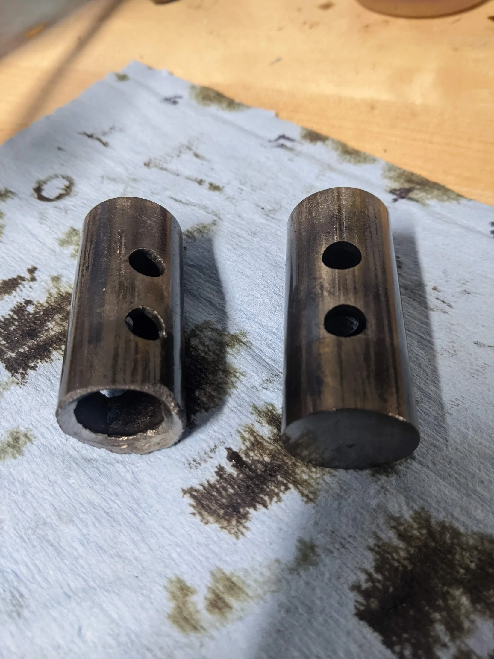

Circa 2021 it needed a top end rebuild and I was looking for a project, so I fixed it up in return for eventual ownership. I ended up having the camshaft repaired and reground with a more aggressive profile by Delta Camshafts, as well as replacing the lifters and pushrods, with the assumption that some day I will likely have to do a "real" rebuild, because there were some serious chunks of valve train in the oil pan (images of the carnage below...). That being said, it's been driving around for 3 or so years. The 2F is tough after all.
I say "build" in the title because I'm not really looking to "build" it into anything, I'm going to try to keep it stock and/or period correct for the most, just needs some fixing. The biggest challenge is going to be getting the smog equipment back together, as it was desmogged while it was in Oregon.

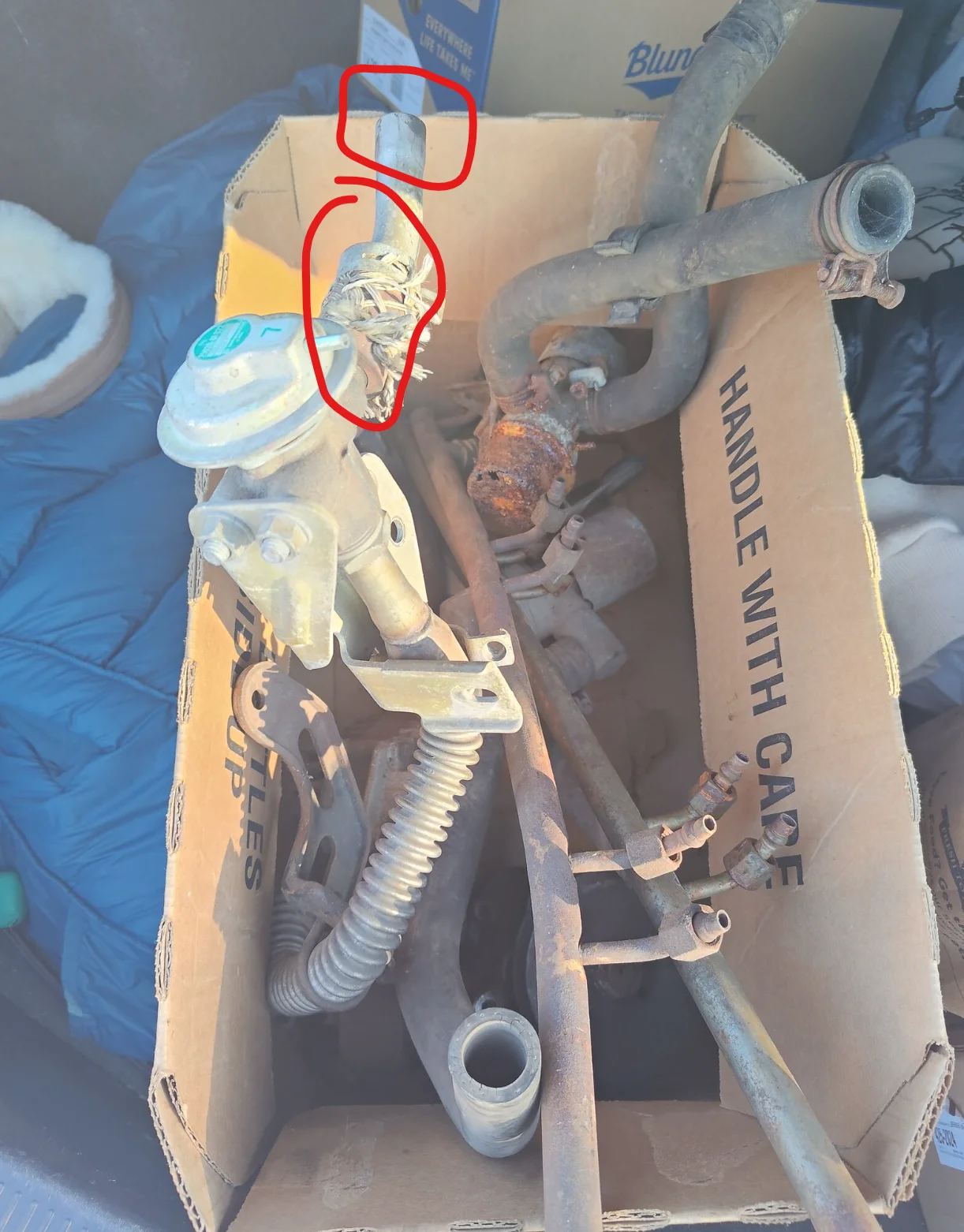

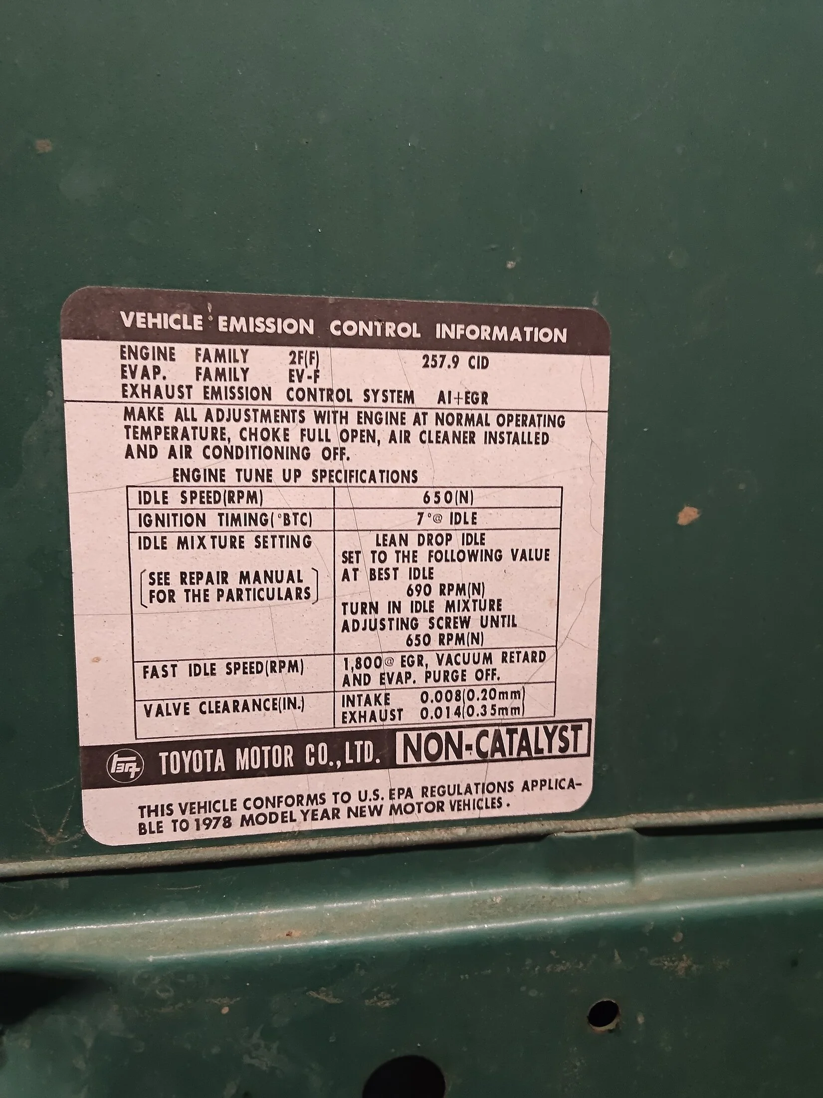

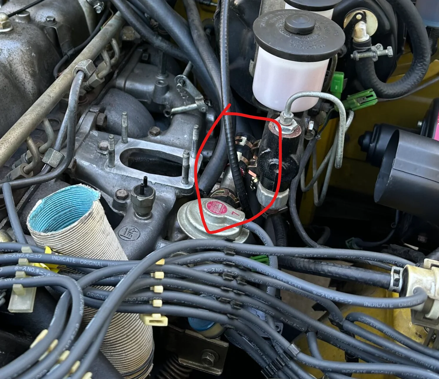

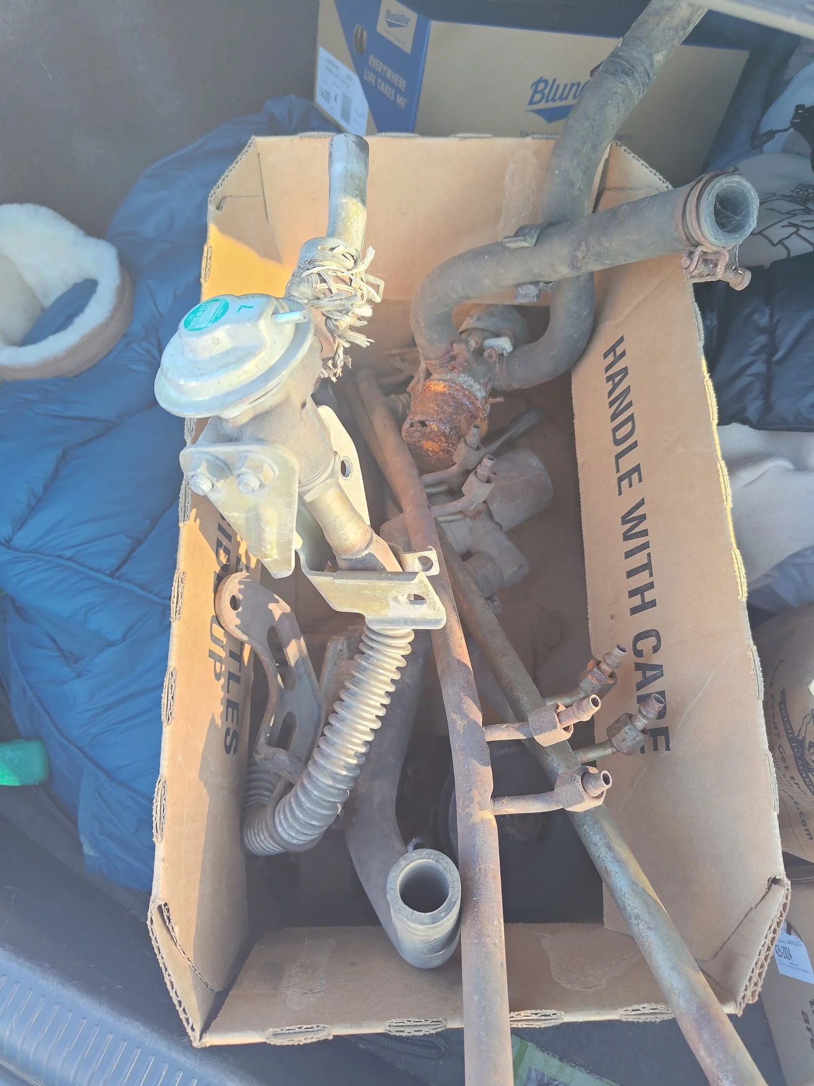

Lucky for you that is a Federal spec decal. So, you don't need the CA specific parts, like the unobtanium thermal reactor exhaust manifold, but you will need a federal spec exhaust manifold (if it isn't on there already). Under the third line AI + EGR tells the smog tech to look for the air injection and egr equipment. I see that you have those parts in the box, but the abv is rotted out and you will need another one. I have extra hi-temp silicone hose and clamps for the areas circled in red. Many members helped me sort out my emissions system and I'll pay it forward by sending them to you (if you'd like).

Yeah, I was relieved to know I had a federal rig.
I'd be happy to get my hands those silicon bits. I've actually gotten some guff from a smog tech about silicon lines, but as far as I've read they're perfectly legal...
I'm trying to track down another ABV, got that one for free (mostly for the plastic hose guide). I've got a smog pump, but I might need another one, this one has a small stiff spot. I'm also still looking for the VCV and the associated bracket. I see there's a reproduction, but I'd prefer the original. Other than those I've got all the major parts (or they're on the way).

The silicone is just a small union for the main part which is the metal pipe. If you delete the metal pipe and run a rubber hose the heat from the egr will cook it.
The secondary air pump could be saveable. You’ll need to pop it open and see what’s bound up. Small bearings on the carbon vanes and the front bearing are replaceable. The rear bearing is nla and I haven’t heard of anyone finding a replacement. I just greased that one good and put it back together.
